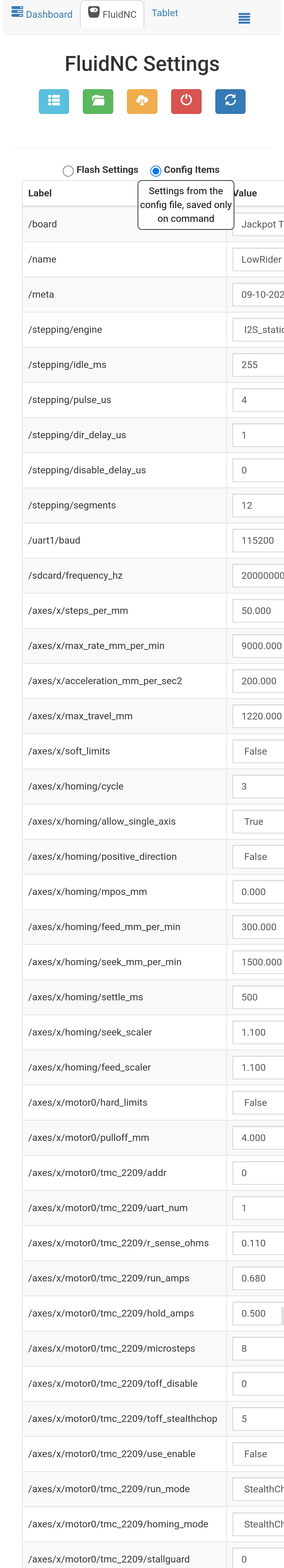

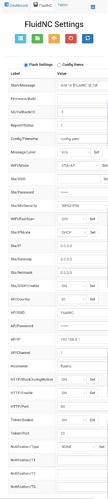

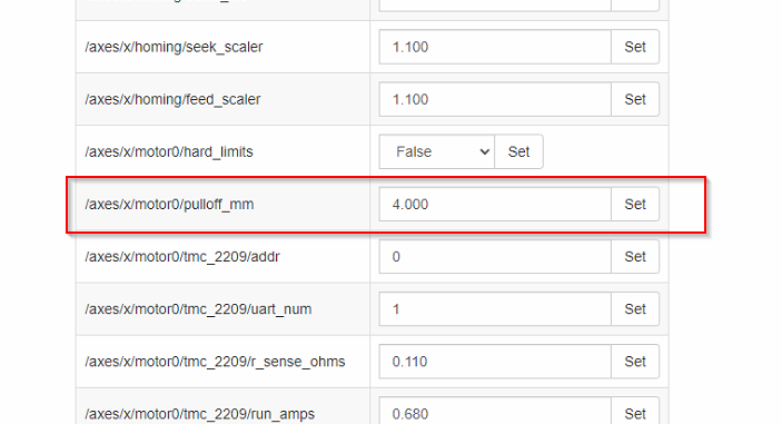

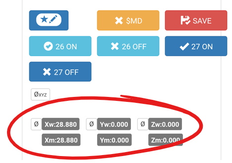

Shoot sorry I need to get on this one …The jackport does not use M666. For that one look at the config settings in the webUI, change the pulloff amount for either side of your machine (easier than before) than use the Save button I made on the homescreen.
I’m not connected at the moment.

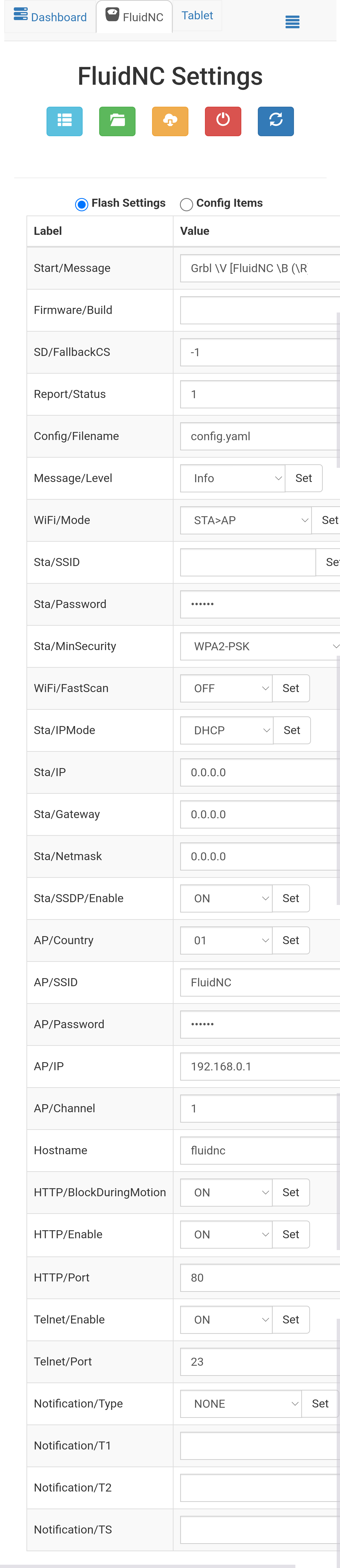

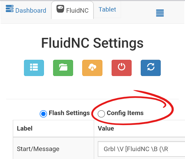

is it under the Fluidnc tab - config items?
or one of these?
I took these screenshots the other day but did not grab one for the config items.
Correct. It will be under the “Config Items” tab, and you will find a pulloff_mm setting for each motor
so you should have all of the following to be able to edit:
/axes/x/motor0/pulloff_mm
/axes/y/motor0/pulloff_mm
/axes/y/motor1/pulloff_mm
/axes/z/motor0/pulloff_mm
/axes/z/motor1/pulloff_mm
Perfect. thanks. I knew it had to be fairly simple.

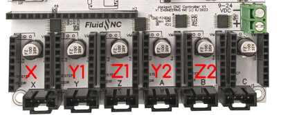

I assume the Y0 Y1 Z0 and Z1 are equal to Y1 Y2 and Z1 Z2 respectively on the jackpot diagram below?
X is pretty obvious.
That is correct. Also add about .2mm to whatever adjustment you find needed.

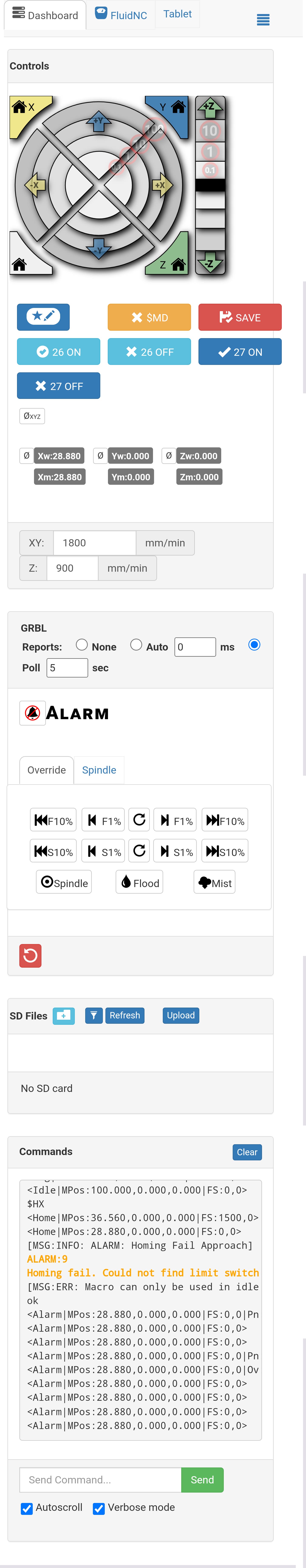

AAAAAGGGGGGHHHHH I hate big thumbs and little screens!!!
the number of times I hit the 100mm jog button instead of the 10mm jog button,

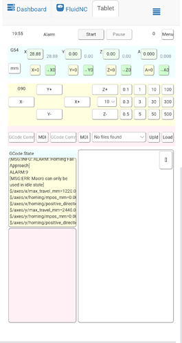

Zoom in on the controls.
Same problem. Broke a BRAND NEW V1 1/16" endmill once by hitting the wrong button. Now any time i use the buttons to jog i zoom in as far as i can. Seems to help a lot!
