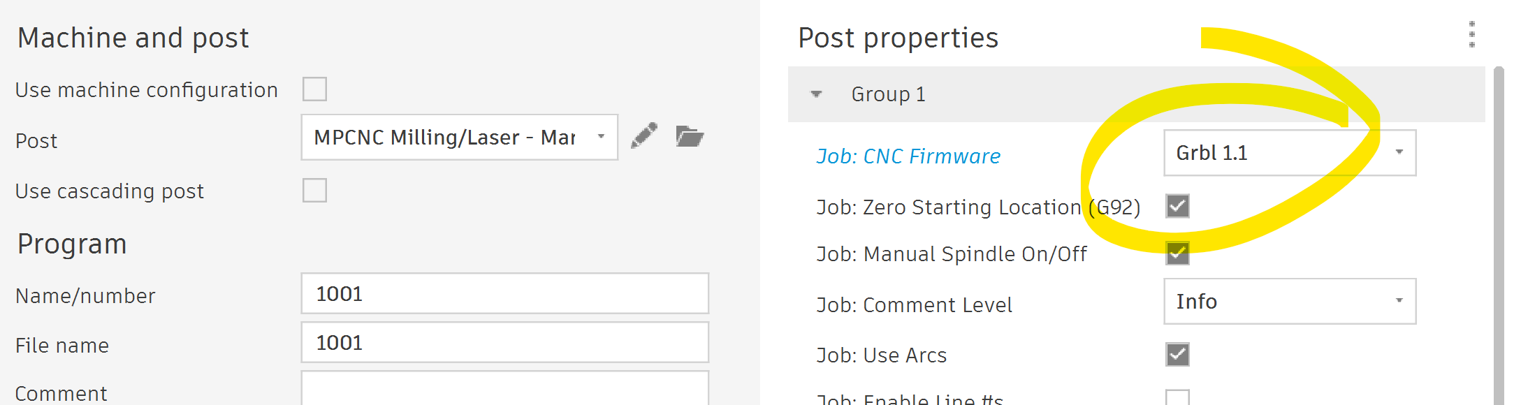

I had hoped the flyfisher post processor for fusion would work.
there is and option for grbl

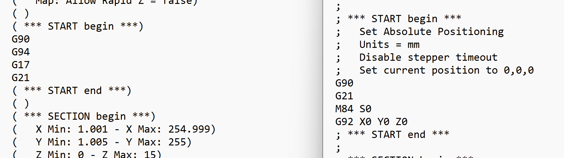

but when I compare the grbl code to the marlin code for the same process the G92 is missing in the grbl version
grbl on the left, marlin on the right.
does anyone know of a good grbl post processor for fusion 360?
I just installed the Guffy PP for fusion 360
it has the same thing, no g92.
would it be as simple as manually adding in G92 x0 y0 z0?

Could I simply take my gcode exported from fusion 360 using the flyfisher pp and replace the start code with the code from jackpot controller page
Here’s the gcode I’m working with.
its a simple 10" circle inside a 10" square with lines from corner to corner of the square.
grbl - probe - G92.gcode (12.0 KB)
this file was created in fusion with both the G92 and probe option checked. you will see there is not gcode for either.
Here is a snippet of the code above around the start.

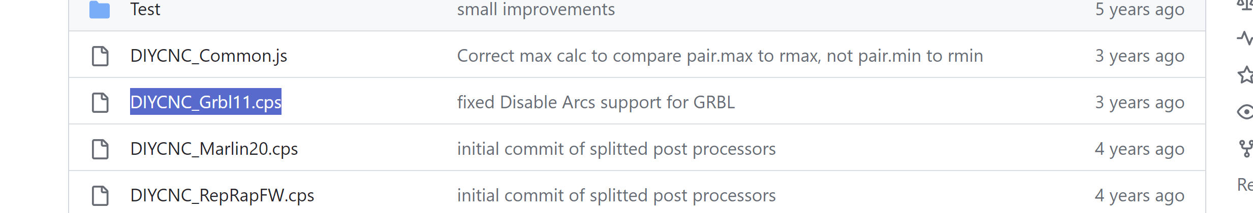

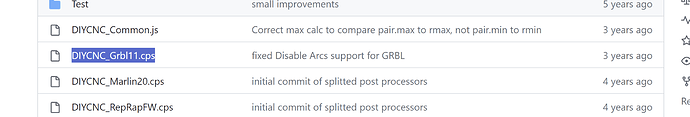

Actually…I did just that! I learned enough of programming to know what I was looking for, found the marlin version and copy/pasted that code into the grbl section. and it worked.
Well…the output worked I still need to test it, but I don’t see it being and issue. I checked it on ncviewer and it looks good.
I haven’t been able to figure out how to update the pp code to include the z probe though.
the Gcode is easy enough to read and its at the beginning, so adding in the z probe bit will be easy enough to do.
I should be able to update the post processor to match the examples above.

@riptyde I’m looking at the PP now. Most of the changes are pretty simple, but I’m just at the start and I’ve done no testing.
I did run into 1 snag. The P parameter in the G38.2 command is NOT GRBL 1.1 but is a FluidNC extension. If I’m updating the PP to be more GRBL compliant then I would like to not step outside the standard GRBL 1.1 syntax.
