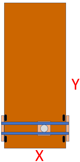

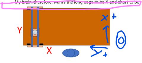

Currently X and Y are oriented as shown below.
However this is not how I stand at my table.

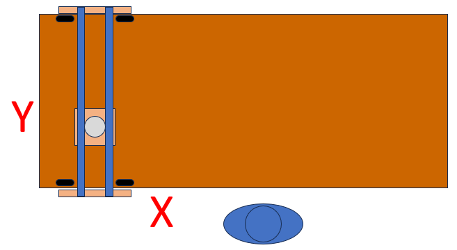

Due to the space in my garage I have the long edge of my table against the wall and stand along opposite the long edge.
My brain, therefore, wants the long edge to be X and short to be Y, like below.
Changing this with the mini rambo was easy since the steppers were wired together, I could simply swap X and Y.
Curious if there is a way to do that on the jackpot?
If not, I just need to retrain my brain. and redo any Gcodes I might cut in the future.
Yes you can switch it all, and you will have to for each config update as well. You will be swapping the pin numbers for X and Y Y1.
This is exactly how I look at my table, but I still load it from the front. I set my table size in CAM and orient things pretty easily that way. I take them off the table as you show and park my machine at 0,0.

I’ve never done that sort of thing. I’m thinking of setting it up like yours and making it simple. that way I don’t need to worry about remembering for config updates either.

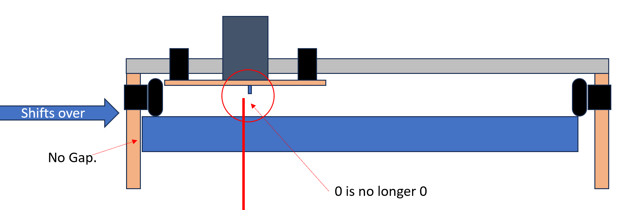

OK, I’m rethinking homing Z on the table vs homing z max. this is more me thinking out loud…
The LR3 has a rail that it rides along. This prevents the gantry from being shifted over on the table
This is one thing I defiantly like about the LR3 (I’m still not upgrading at this time)
The LR2 does not have this.

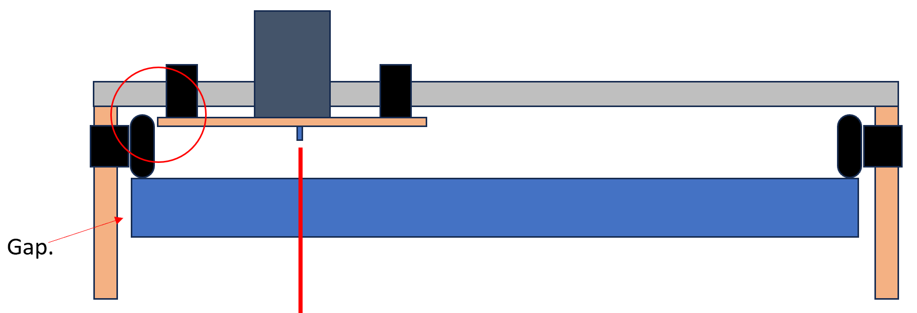

With the LR2 there is a gap between the tubes and the sides of the table.
and the router sled homes to to the side plates.

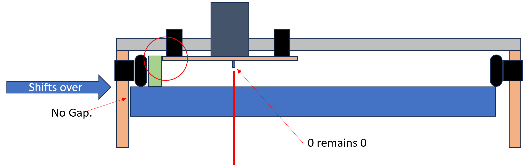

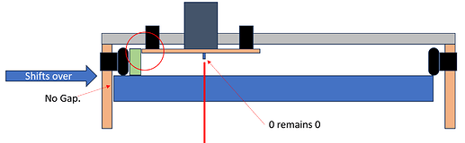

this means if the entire gantry is accidently shifted, 0 does not equal a previous 0.
this is not good if trying to do multiple cuts on a single part.

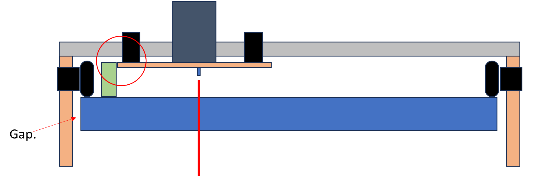

However, if I add a block on the table (green) and home to that…
…then if even if the gantry is shifted over, I can keep 0 at 0 every time.
the problem is, in order to do this I need to home Z axis to the table so it is low enough for the router sled to touch of the block.
I suppose I could home the x axis (router sled) then home the z max?
Hmmmmm. that might work.

But not if the gantry shifts back in operation?
My guess is that you would need to drop a couple of battens or angles beside the wheels to stop this drift, (there were plenty of builds that did that).
You’re right, it could happen anytime.
It’s probably pretty unlikely that it would get shifted at all. But in a garage environment you move things around and it can get bump. During operations that’s less likely to happen.
This just takes out any mishaps before a cut starts.
But still want to know if homing to zmin is possible.
You can home to zmin, but it causes problems. For one thing, the router and but need to clear the table. Secondly, the Z0 doesn’t make much sense. You need to use the probe to set Z=0 to the top of the work surface.
To change it, you have to change Z_HOME_DIR, and change the Z2 endstop to zmax in configuration_adv. You have to disable the zprobe because it is configured on zmin.
An easier solution might be to just add some physical tracks to consideration it. I used some 3/4"x3/4" strips of wood nails down with a brad nailer. I made sure the first one was square to the table. I used the gantry to align the second one. They were just inside the wheels.
I hear you, but…how often might this happen over the course of one job? I think trying to be careful around the machine during a multi day job is better than homing to Z min. If you think this is a big problem you can always have each job start with some alignment drill points to make sure they still align?
Also you have been getting along really well with no endstops, this is going to be far far far more accurate than that. I think the machine shifting is a non issue. If the machine is in a high traffic area maybe add a parking shim to the side plate when not in use to make sure it can’t move.
