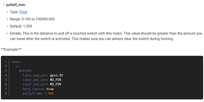

Is auto-squaring supported in grbl (M666)?
I think you have to use the pulloff_mm setting in the config.yaml rather than M666, but Ryan can confirm
http://wiki.fluidnc.com/en/config/homing_and_limit_switches
I don’t see any mention of M666 here Supported Gcodes | Wiki.js
