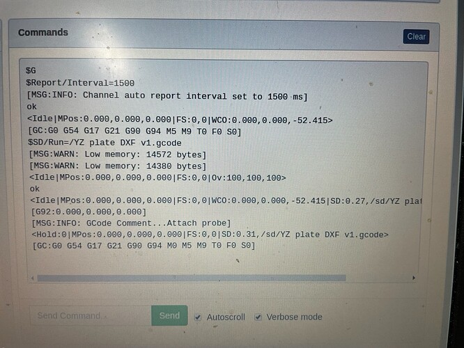

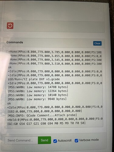

Just to follow up with the new config file. I ran the following test.
Fresh boot
Home X and Y
Jog around a few times
Start job

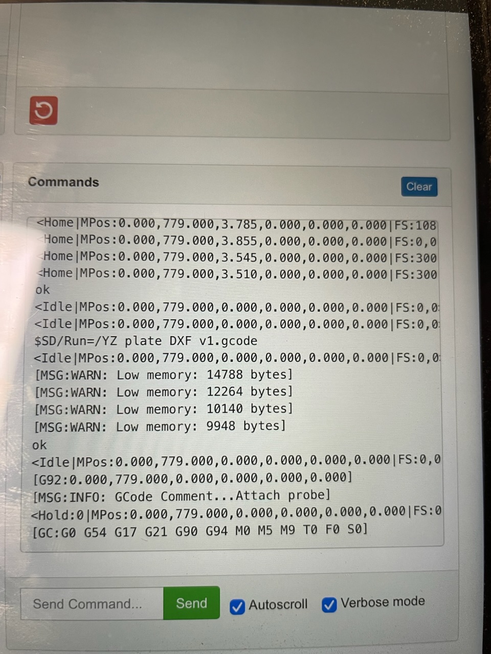

Running in AP mode with Aug 10th config:

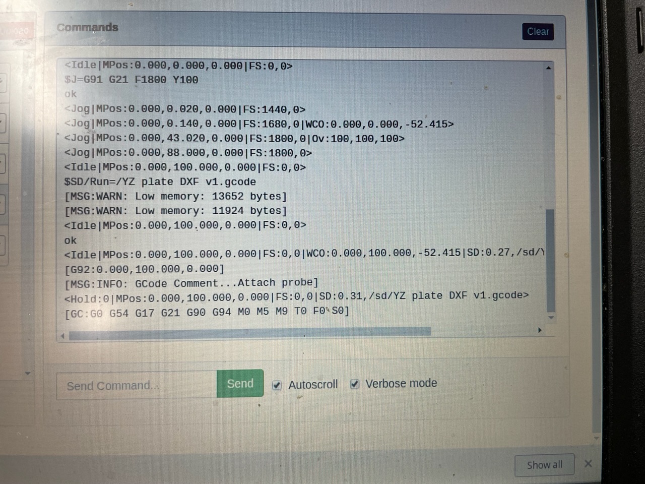

Running in AP mode with Sept 10th config:
Still Low Memory warning, but not quite as low
Hmph… I’ve been running on Low Memory since the early aughts… :wink:

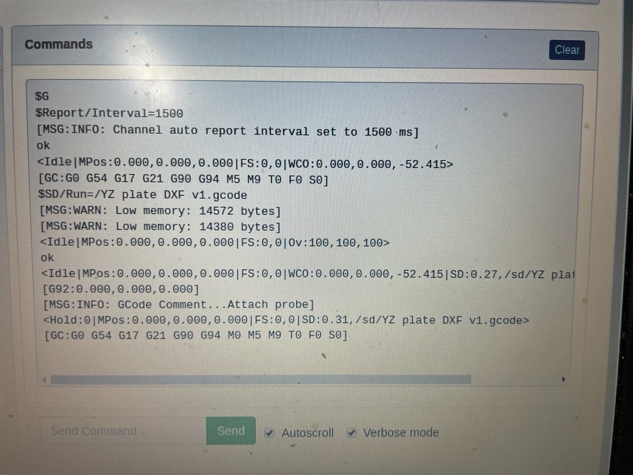

What about in polling mode?
Low memory warning goes away if I switch from Auto:1500 to Poll:3
I need to find a way to make that a setting in the preferences file then.
Thank you so much for trying that. I can’t seem to trigger a low memory without just logging in with a bunch of browsers.
With Auto:1500, direct reboot and nothing else but click run file

As far as I know…seriously not much…this is just a matter of a lot of things happening at the same time. I am more wondering why that file triggers a low memory warning. I have not seen that yet and I loaded some giant small segment files from open sauce and didn;t see it.
It does not happen with the test crown for you right?
I’ll check it out in a little bit. This is the file if you want to peek at it.
YZ plate DXF v1.gcode (66.8 KB)
It does a 3mm drill in all of the linear mount holes with a v bit to mark the holes to drill later.
Then using the 1/8" endmill, 15mm/s, 1mm DOC, 45% stepover at 13.2mm total depth for the rest of the holes/parts.
I run a set of 12 yz plates nearly everyday, I am going to take another look at your file and mine.
I just hit run on your file (loaded on a microsd card), no memory error.
Poll or Auto?
Both I think Poll for sure.
I just updated the preferences to polling at 5 seconds, tested your file at 3 seconds polling.
No warning running the crown gcode from docs page

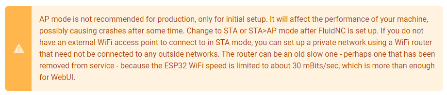

Changed to STA mode
Auto:1500
Reboot, run file.
No memory warnings.
Edit: Also found this in the FluidNC wiki
