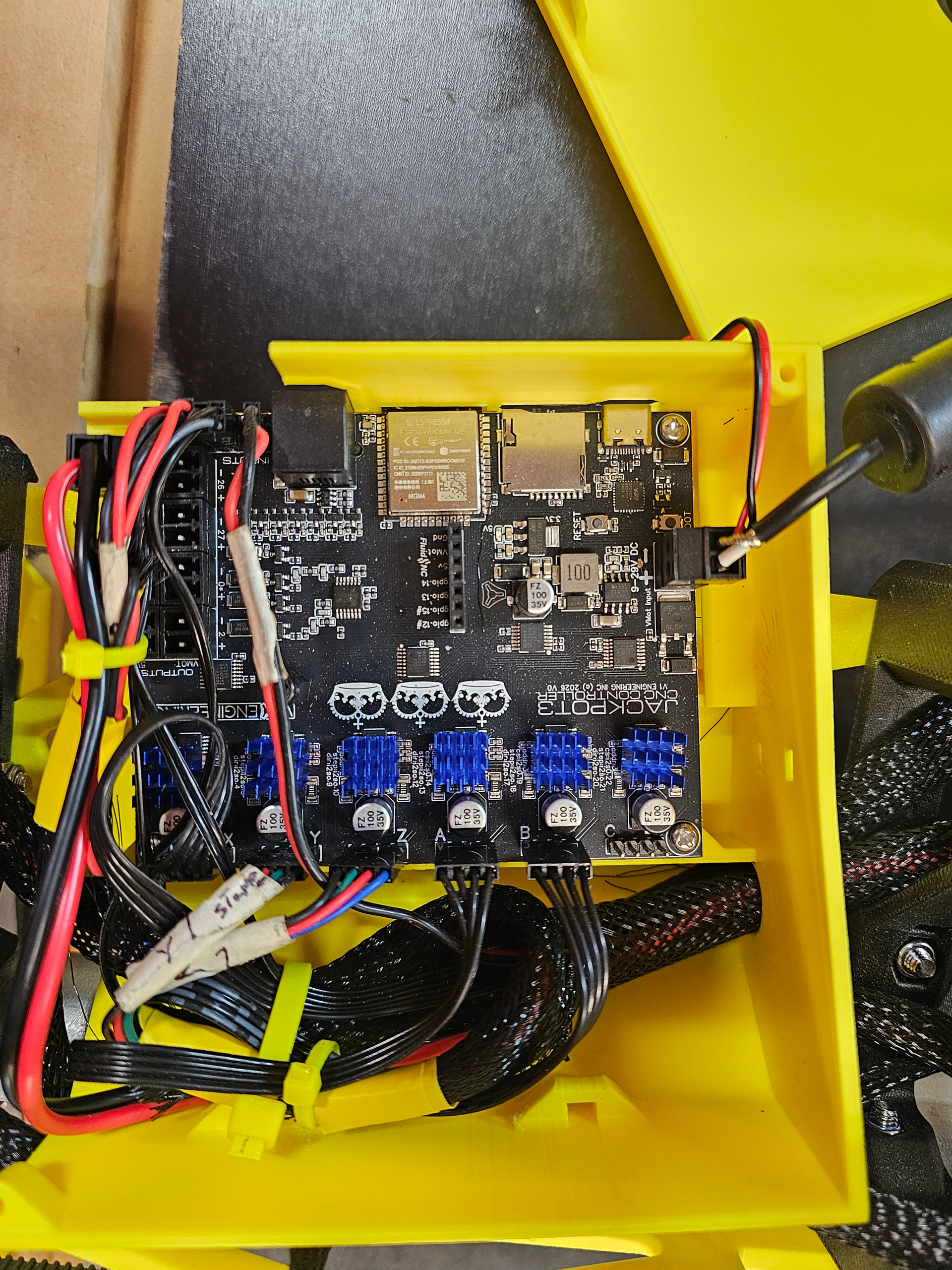

I have just finished building my second LR 4. I am unable to get the machine to hold its network connection. I will list the trouble shooting I have completed and a picture of the wiring to the board.
1 Made sure there are no wires over the ESP32.
2 I uninstalled Fluidnc, upgraded to 4.0.2 to see if that made any difference, it did not.
3 removed all files, downloaded the newest from GetHub and installed these.
4 tried AP mode, same issue, tried Bluetooth, unable to get it to connect, probably me on this one.
5 reinstalled fluidnc 4 times during this process.
My other LR 4 is about three feed from the new one, the router is 15 feet away mounted at the top of the wall with a clear shot to both machines. I have had the original machine running just as a test and it stayed connected for 4 hours straight no issues, Jackpot 1 on that one.
I do have a picture of the web installer showing it connected at 100% if I need to provide that I can.
The longest connection I have been able to hold is maybe an hour, most of the time it is just a few minutes with a bunch of just seconds thrown in for good measure.
I have not been able to cut my Strut Plates because I have not been able to keep it connected long enough to get them cut. I did get a start but only lasted about 1 1/2 minutes before it died.
Help!
The one wire running across the board is the probe, just not long enough to get it with the rest, will relocate the box once I get the Strut Plates in place.

How is your power connection? Anything loose there?

Good questions that I truly don’t know how to answer. Power coming is plugged directly into a 120 plug using a 12 gage 25 foot extension cord.
With the machine idle, you could try to wiggle the vmot power wires at the board a little bit to make sure there is not a loose connection or bad solder joint at the connector. Not too much, just try to simulate normal vibration. See if that triggers a reset or loss of connection.
I did this but it did not effect the machine at all. I do believe this is a good thing.

Am starting to wonder if there’s a hardware defect with your new jackpot. Wondering whether measuring signal strength differences between your solid Jackpot 1 and the newer board will help narrow down cause.
