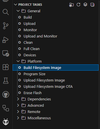

You could even go a step further and build your own littlefs.bin for each board (I guess that’s just JP3 now) since that’s what contains the files. So you could do it all at one shot.
If you open the FluidNC repo in VS Code, the contents of /FluidNC/FluidNC/data is what ends up in that. So, just put all of your flash files there.
That path is defined by the data_dir in the platformio.ini file:
[platformio]
src_dir = FluidNC/src
include_dir = FluidNC/include
test_dir = FluidNC/tests
data_dir = FluidNC/data
Under PlatformIO → Platform, you can select Build Filesystem Image to build littlefs.bin
Which will show this:
Building in release mode
Building FS image from 'FluidNC\data' directory to .pio\build\wifi\littlefs.bin
/config.yaml
/favicon.ico
/index.html.gz
Unless they change the filesystem, and I haven’t seen them do it, this file should stay the same between releases.

OH It works!!!1 Thank you.
So If I leave my script up above alone and just swap out the littlefs.bin file it will have it all…that is too cool. I will be flashing some boards first thing in the morning!
