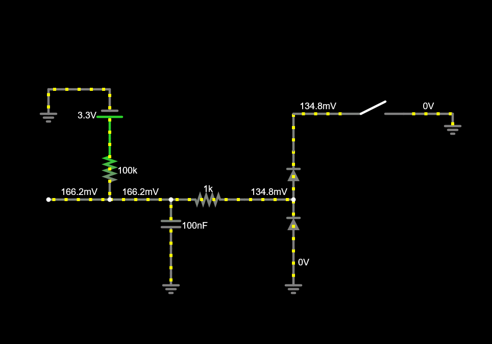

This I completely understand. I just don’t think there is much of a use case for any high-powered logic stuff on a board of this size. I am okay with a 5v input cap, I actually kind of prefer it. Keep inexperienced users from playing with that stuff and possibly really messing up the board and experienced users will know how to knock it down to 5V if needed. I will change the docs now to specify because I have not already. The JP1 implied 5V because it had the 5V optional rail) but never specified.

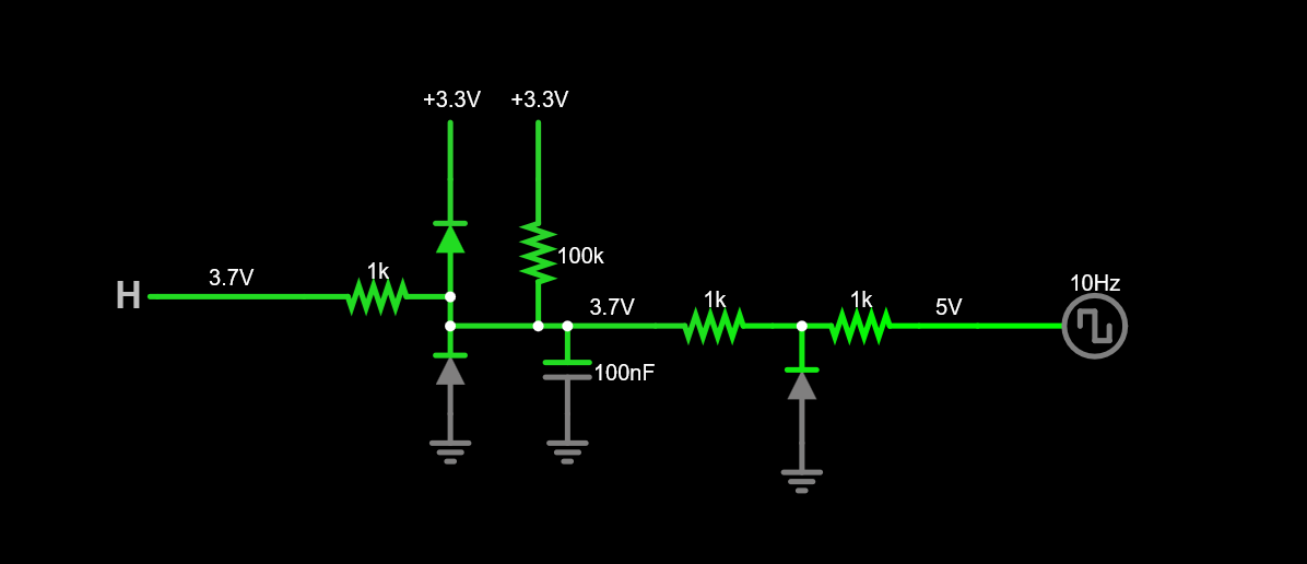

With 100k in there it never gets pulled up high enough.
Here is the 49.9 we currently have, I can go back to that.
Ok, all good. As long as it’s clearly called out then that’s probably fine. In future if you’re only doing 5V inputs then it’s probably better to avoid doing them via the diode altogether.
The good thing about having that diode in series is that your input can be pretty much any voltage that the diodes can survive. The bad thing is that it’s a lot more ‘brittle’ to things like ESD, EMC miswiring etc.
The other option is to use a voltage divider on the input or to just have the input bypass to 3.3V via a diode. If it were me, I’d have done something more like this:
The nice thing there is that it keeps the resistor/capacitor filter connected at all times, so you don’t have the equivalent of an open-circuit when the diode is reverse biased. That can help with things like noise coupling into other parts of the circuit etc.
If it were actually me, I’d probably also have an individual resistor in the +3V3 connection, too, with a capacitor across it on the output, or a common mode choke, but then as previously stated, I’m paranoid…
Edit: Never mind, I see you’ve changed the 100K back to a 10K as well. Try speeding the simulation time up. The pull-up just takes 10x as long now, which should still be quick enough.
Edit 2: It’s a 23ms step response now, instead of 2.3ms, so if you’re moving at 10mm/s it’s a delay of ~0.2mm instead of 0.02mm. That’s only for the delay on switch opening. I can’t remember if the logic for FluidNC is on switch open or on switch re-close.

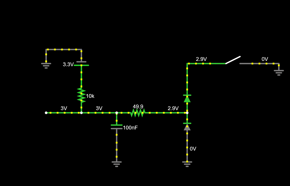

Back to the way it was then, 10k and the 49.9? That gave a 0.5usecond if I am not mistaken, the 1k brought that up to a 0.1ms.
I started learning but it takes a long time to see changes and the extra parameters means I get myself into mistakes a lot easier. LTspice is like fusion360 cam, circuitjs is like estlcam. I will keep trying with lt spice though.
So you have input-> current limiting resistor-> TVS-> filter resistor and cap-> pull up-> bat54s as a 3.3v clipper->another limiting resistor.
Bear in mind that because you’ve got 2 different conduction paths, you’ve got 2 different time constants. The switch closing and pulling it down will be via the 1K resistor, the switch opening and pulling it up will be via the 100K resistor. So one is a time constant of 1K * 100n = 0.1ms and the other is a time constant of 100K * 100n = 10ms. I usually assume 2 time constants to make a logic level transition, so 0.2ms and 20ms, respectively.
I think that might be giving circuitjs far, far too much credit. I would say estlcam is usable in a real sense. Circuitjs has already just convinced you of something that doesn’t follow the laws of physics.
Yeah, basically. Each component is a piece of the puzzle and has a role. I wouldn’t get too caught up in calling them things like ‘limiting resistors’ etc.
Working back from the input, the first resistor forms part of an RC filter and acts to limit current through the TVS. Larger values provide more filtering but smaller values will be more robust to ESD.
Then the TVS which limits over-voltage in a surge/ESD/incorrect connection condition. With the resistor before it, this should happily survive being connected to much higher voltages long term, maybe 100-200V ish.
The next resistor is part of the RC filter and also serves to limit the current through the later parts of the circuit as the TVS clamps.
The pull-up keeps the circuit in a defined condition if the input is disconnected or if it’s connected to a microswitch or open-drain output. This gets sized such that it’s low enough impedance to swamp any bias/leakage current out of the ESP32 pin and the diodes etc. but high enough impedance that the impedance of the RC filter doesn’t form a voltage divider that will cause issues with the input.
The diode array serves to act as a secondary clamp, keeping the voltage within the ESP32 limits. This is a second ESD stage but also helps with long-term connection to higher voltages like 5V or something that won’t be limited by the TVS.
The last resistor is just there to limit current into the pin in the case that the diode array isn’t limiting the voltage enough. If the diode array was connected directly, it’d be all the current through the diode array or the ESP32 without any sharing. With the extra resistor there, if the diode array is 0.1V higher than the forward bias voltage on the ESP32s input diodes then most of the current will still be going through the diode array with only 100uA through the ESP32s input diodes.
If this were an ADC input, I’d also have a capacitor directly on the pin to provide a stable voltage while the sample-and-hold circuit draws brief current pulses.
Depending on level of paranoia, I’d add a common mode choke on the input and more filtering, etc. etc.
There’s never really a ‘stop’ point, more just a ‘good enough to meet my needs’ point.
If you’re making a $3 widget, you might just have completely open pins like the ESP32 devkits do. If you’re making a multi-thousand dollar widget that is being sold into aerospace, automotive or industrial etc. then you’d do what I’ve described above or even more, etc. etc. It’s really just a case of figuring out the best way to achieve a given goal which, as I’ve said before, should really start with a clear goal! Just ‘make it more robust to ESD’ is a slightly tricky way to think about it.

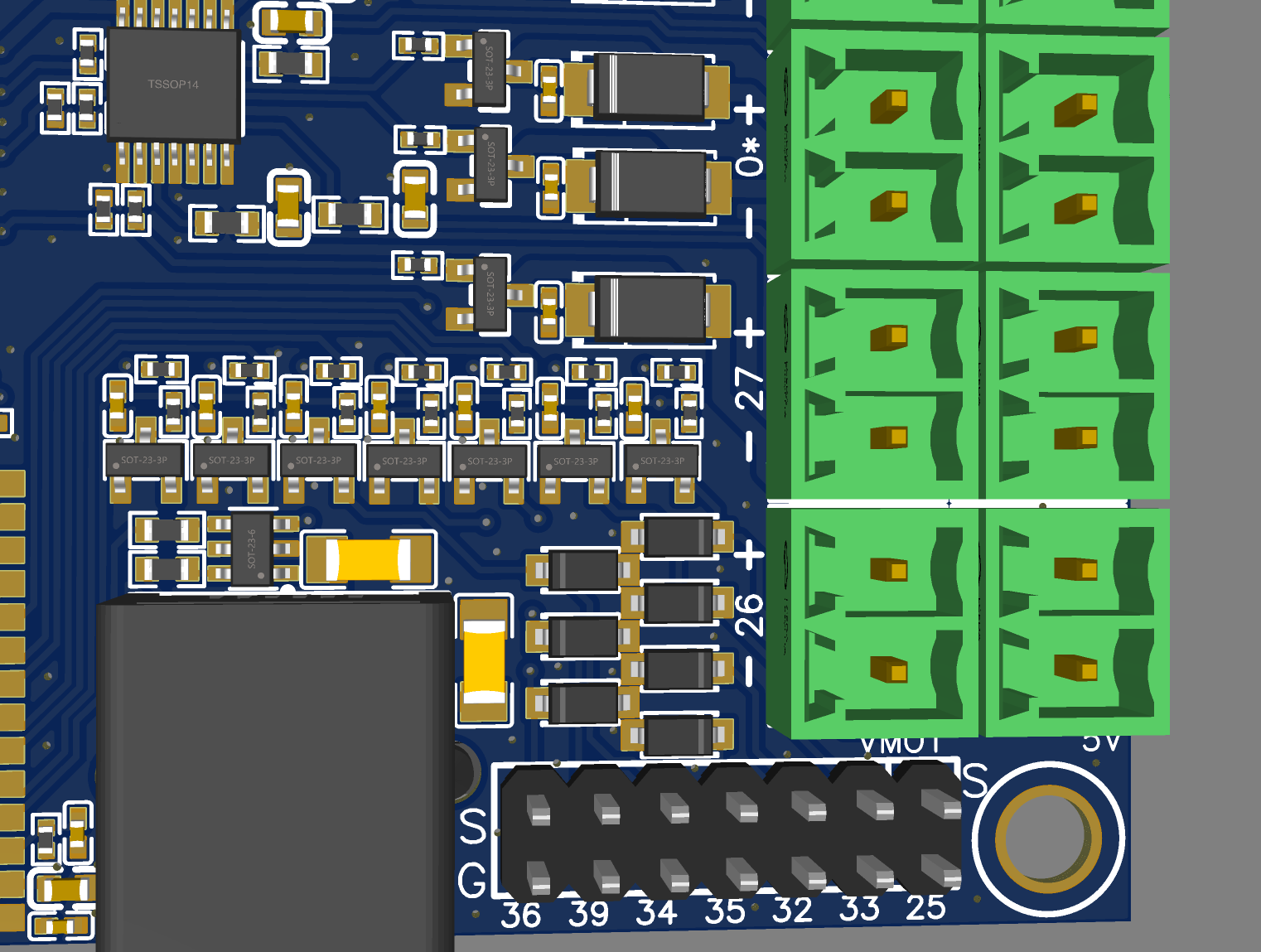

Okay, let me see if I can fit a couple extra resistors and start shoe horning things in there. Obviously I trust your designs better than any others so I will make it work, preferably without changing the layout so I don’t have to remake a box and instructions.
That’s not meant to be a ‘change it to this’, more of a ‘have a think about how this would work and how it accomplishes similar tasks’.
I don’t think there’s anything necessarily wrong with your approach, it’s just a little ‘odd’ for a 5V input.
If it’s going to take some shoe-horning, there’s also the perspective that a non-ideal circuit laid out well may outperform a more ideal circuit that’s laid out poorly, etc.
I think adding the TVS and saying it’s 5V max should be fine, for this situation. I would still bump those filtering values, though, providing you’re ok with a ~20ms delay in triggering that input.

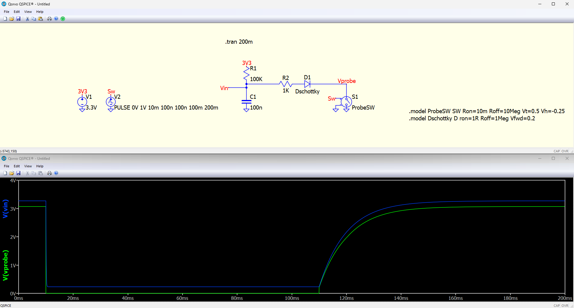

I don’t think that will work. 0.2mm time to trigger plus decel, we might break vbits. We would have to home at 1mm/s to be at 0.02mm. I think it has to be faster.
Why would you be breaking bits on home? I’m confused.
This should be repeatable, but either way.
Maybe just keep it as is, then, and take it as a future action item to write an actual spec for this kind of stuff.
Z probe to a metal touchplate.
I had forgotten that we’d started with the probing. Fair point. That’s the ‘fast’ situation, though, where the input gets pulled low.
This is why the asymmetry gets confusing.

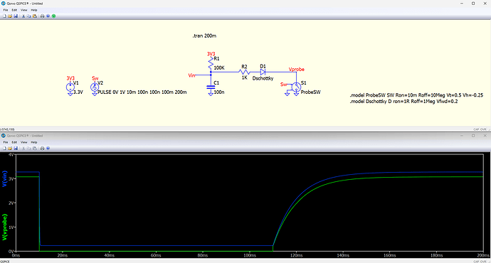

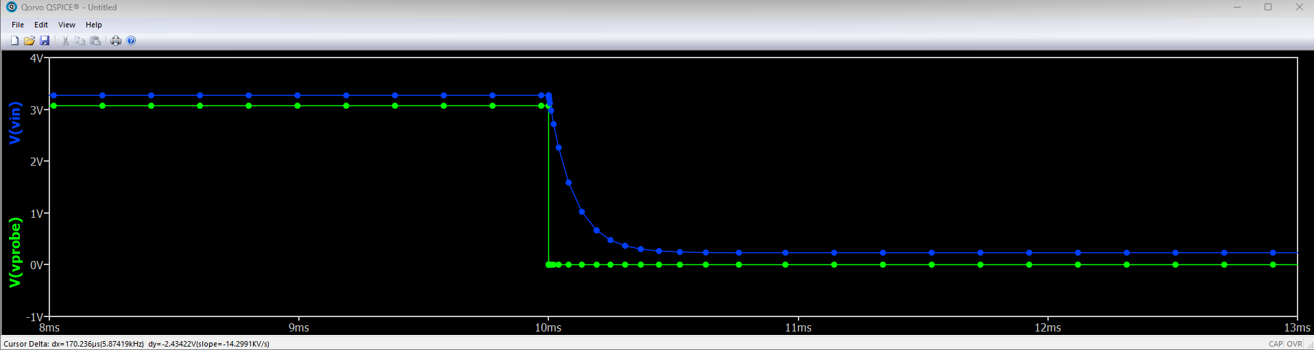

So the pin will be open-circuit as the probing starts (100K feeding into 100nF, fully up at 3.3V). Then as the probe comes into contact, that’s the same as closing the switch/shorting the input to 0V, so that’s 1K into 100nF, discharging it down. 1K * 100nF is a time constant of 100us. ESP32 VIL(max) is 0.25*Vcc so 0.8V, so the worst case timing is 3.3V to 0.8V.
Chucking that into QSpice:
The green trace is the voltage on the probe itself, the blue trace is the ESP32 input.

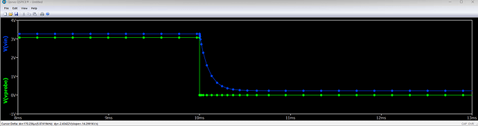

The first transition of high to low is the actual probe contact event.
That’s it zoomed in with cursors set to the contact event and the point where Vin crosses 0.8V. It’s 170us later, so at 10mm/s it’s 1.7um of delay.
yeah, the simulator is really helping me to see that. I have set all the values to what I think they should be as best I can. I added a scope to check the timing vs my math.
The other side is the endstops and they will be on the slow end of that curve…and people tend to home X and Y faster than Z so that speed is still not good.
The JP1 and JP3 v0, have a 10k and 49.9ohm set. Not much filtering there, but fast and brings the input nice and low.
Well they fit, I will see if I can get any more separation in there. None of the traces T off,
