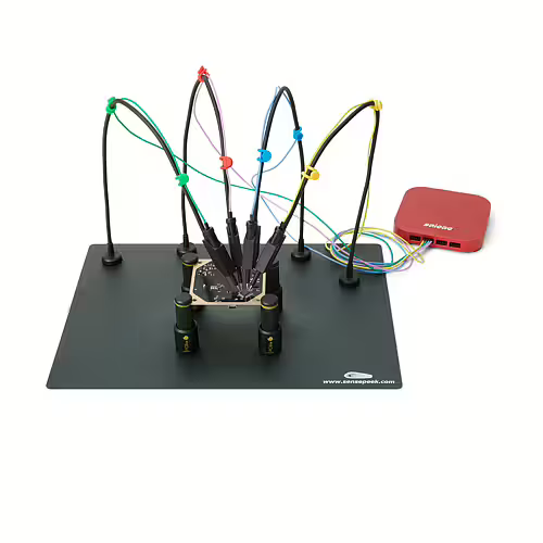

Another option I have is the Sensepeek PCBite probing setup:
https://sensepeek.com/pcbite-kit-with-4x-sq10-probes-and-test-wires
I have the version with a bunch of logic probes, a couple of multimeter probes and 4 scope probes. It’s a bit of a pain in the ass to set up but it works pretty well, all told.
