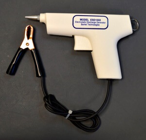

Sadly I wasn’t able to snag an ESD tester from my previous job but I’ve seen diy or cheap ones for fault finding available. Bartek ESD1000 is one I’ve seen before. Not really a proper bit of test equipment but could be useful in a fault finding or diagnostic sense.

That looks like a car battery powered hot glue gun or something.

Not even that, the clamp is for the 0V reference and pulling the trigger strikes a piezo element and generates the ESD strike. It’s essentially a very slow, slightly shit tazer…
