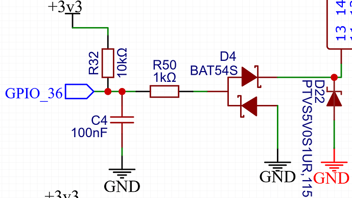

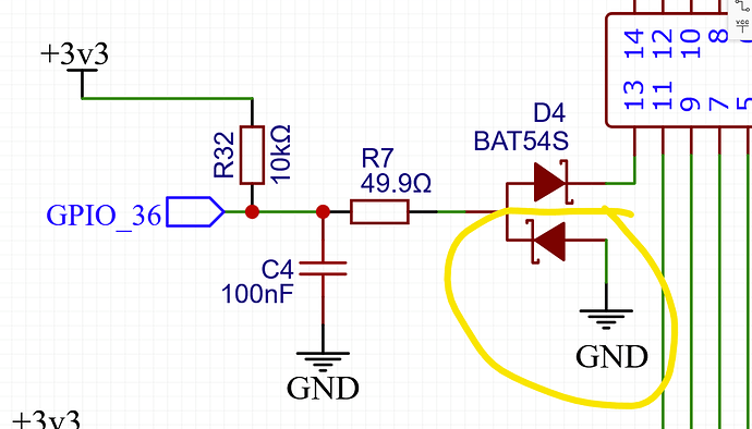

Is this leg of the bat54s, doing anything? I even made a little simulation and I don’t understand why it is there, we could have just used a single shottky diode?
I have been thinking about this all day. The current inputs are up to 30V safe, but they don’t work above 3.3v, do they? So If I find a TVS that clamps below 30V, and has a working voltage above 3.3V, that is just a single component plug and play right, nothing changes except these will be more robust?
Datasheet - LCSC Electronics These are some of the most common on LCSC that fit that description.
It’s preventing the input being pulled down to voltages below 0V. What inputs are you putting into your simulation? It’s always worth considering not just correct operating conditions but also incorrect ones like reversed connections or broken external connections etc.
Bear in mind that the input voltage going below 0V doesn’t necessarily just have to be because something is hooked up backwards, it can also be because something doesn’t share a ground with the jackpot and it’s floating at a different voltage for some reason.
As I mentioned above, it’s kinda weird to think about with the microcontroller inputs going below 0V, it’s not that they instantly die or anything, it’s that they have their own diodes internally connected like that which will start to conduct. If you connected -12V to an ESP32 pin through a 100K resistor, it’d clamp to 0.5V or something and likely be perfectly fine. if you connected -2V via a bench power supply and no resistor, you’d almost certainly kill something. The voltage is what causes the current, but the current is what causes the damage, etc.
The thing to consider is if you add a TVS to the connector side of that circuit, it also provides that same function, so you may be able to do away with the diode array and just replace it with a single diode. If you don’t then no issue, it’s not a problem to have it doubled up there, it won’t likely conduct because anything going through the TVS is doing through one diode, while anything going through the schottky is going through two. I wouldn’t be too worried. I would, however, move the resistor to being on the other side of the schottky which will help avoid that situation.
I’m not sure what you mean here? The inputs should work fine on any signal that goes between 0V and 30V. Anything below ~1V is considered a logic low and anything above ~2V is considered logic high.
Yeah, that’s pretty much it. Just bear in mind where the TVS will start to conduct in reverse because you really don’t want it to conduct under normal operating conditions. If you were to use a 5V standoff voltage TVS and someone were to hook this up to something else, say +24V to sense whether a power supply is on or a switched 24V output from something else, that TVS would act pretty close to a dead short and likely damage whatever the output was.
So I would say, rather than keeping the reverse standoff voltage above 3.3V, instead think of it as keeping the reverse standoff voltage above whatever your maximum input voltage is.
I also wouldn’t be as worried about being exact with some of this stuff. The thing is, without being very certain above how the ESD strike will occur, you can’t really predict how much current it will actually be. The worst case HBM strike is, from memory, a 16kV pulse into a 1500R resistor and dead short, so 10A. ESD strikes can be much higher voltage but also aren’t likely to be perfectly into that diode like that, they’ll have other circuit resistance/impedances. So while it’s theoretically possible that a 24V 400W TVS would climb to 40V at 10A and that this would match the worst case 16kV ESD strike, that situation is probably pretty unlikely.
Another thing I forgot to mention previously when sizing TVSs is that the bigger, higher power ones tend to have similar clamping voltages just at much higher current, so for the same current they clamp at a much lower voltage. A 400W 24V Vr TVS might clamp at 40V/10A while a 1500W 24V Vr TVS might clamp at 40V and ~40A. Obviously if you only put 10A through the 2nd one it’ll clamp at a much lower voltage, likely closer to 30V, etc. That doesn’t mean you need the bigger one, it just means there are some considerations when choosing the right size. You might not need to survive a 1500W surge, it may just be that you want to overrate the device so it catches ‘tighter’.
You can also just use multiple 400W ones for the same effect or, better yet, spread them out. The first 400W one sees 10A and goes up to 40V. If you have a 100R resistor and then a second 400W TVS, for it to see 10A it’d need to have 1000V across that resistor. Instead if we assume it starts conducting at 30V then there would be 10V across that 100R resistor, so 100mA, meaning the 2nd TVS would barely see any further voltage rise. This is often how protection is handled in really gnarly situations like where you see huge surges. One big device that catches the bulk of the energy but lets through a voltage spike that can damage stuff. Some filtering components and then a second smaller but more accurate form of protection to clean that up, etc. then finally usually down to a diode connected to the voltage rail such that anything that makes it through is instead drained into the power supply capacitors, etc. None of that is needed, it’s just interesting.
So anyway, I’d be ok with just adding a decent sized 24V TVS like a 400W SMA part to that part of the circuit and calling it a day. If it were me I’d probably swap the diode array for a single SOD-123 diode and up the voltage to 60-70V for a bit more voltage withstand. I’d rearrange the circuit so it went Input connector → TVS cathode → single schottky diode → filter resistor → filter capacitor → pull up → ESP32 pin.
If you do want to use that tiny SOD-323 TVS, I’d say be careful because while it’s specified for 350W peak, the thing they don’t specify is how often these can occur before failure. It’s very likely that a board that’s seeing ESD issues will see them repeatedly until failure, so having some more overhead here will help. If you want to try with this one then go for it, but the clamping voltage is more like 50V so I’d definitely up the voltage on that diode array or replace it with a single higher voltage diode.
If pin 13 is not lower than 3.3V isn’t everything positive blocked (below 30v). I keep looking this up and I do see people using these bat54s tied directly to gnd and 3.3 to limit the voltage but in this case we are kinda using it backwards and I only see it preventing negative signal (it let’s though -0.3v if I am not mistaken), and blocking anything from +3.3V to +30v before it breaks down.
Yes, that is correct. I’d say that’s still the input ‘working’, though… :slight_smile:

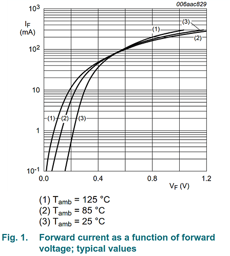

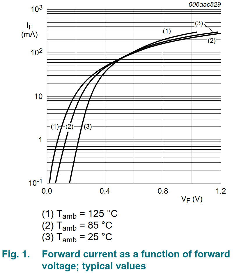

This will depend on current. From the datasheet:
That curve shows the forward voltage for the diode. In the case of how it’s connected currently, the diode is forward biased when current is flowing out of the input due to it being below 0V. How much current flows will depend on voltage and impedance of what is generating that negative voltage as there are no other limiting factors.
If it’s something like a 5V output with a 1KR output impedance then you’d see something like a few mA flowing (5V/1KR is 5mA if it’s a dead short, but there will be the 2 diodes), with the Vf across that diode being around 0.3V as you say… If it was something like a 24V output with a 100R output impedance you’d see something like 240mA which would be around 1V. Or if it was something even more limited on current and only 100uA was flowing, that’d be 0.15V, roughly.
So it is best to use a clamping voltage under 30V, and keep the bat54s, so we still have negative voltage protection after the TVS (since they have a possible -0.7v to -1v).

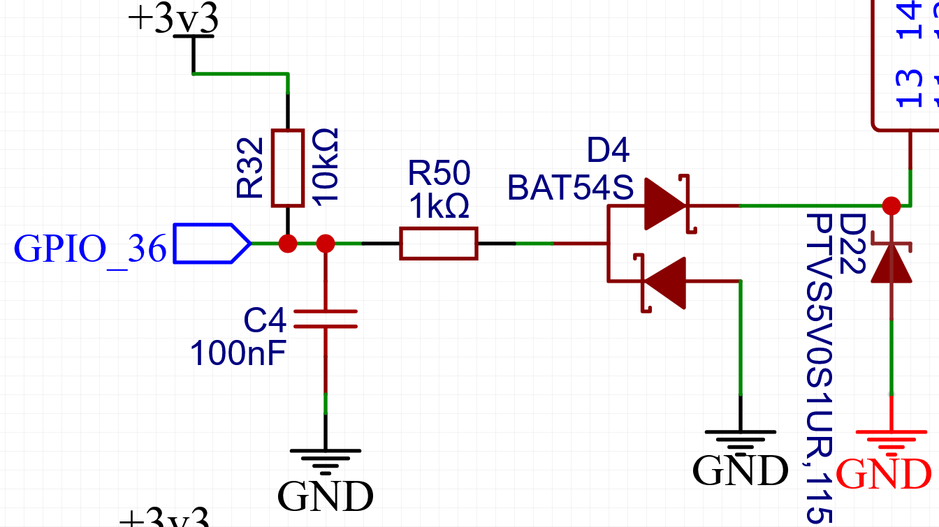

Datasheet - LCSC Electronics, these little boogers are 5x the cheap ones, but handle 400w instead of 200w, 9.2V clamp, 5uA leakage. I assume the 9.2V clamp is fine, I can not imagine any other use for these inputs other than 3.3V. Sod123, barely fit without making significant changes to the board layout.
I’d bump the pull-up up to a 100K resistor, as well. The pull-up and filter resistor create a voltage divider. Assuming the input is actually 0V, which it never will be, that’ll be around 0.3V on the BAT54, so 3V across that divider. The voltage across the lower part of that divider will be 3V * 1K/(10K+1K) so 0.27V. That puts the input at 0.57V which is closer to the threshold than I’d like, personally. With a 100K pull-up that’s down to 0.25V or something around that.
If you’re ok with those inputs being 3.3V only then that should work fine. Personally, I’d probably go for the 24V one and replace the BAT54S with something higher voltage to keep 24V operation, but if you prefer to stick with the 3.3V only option, people can still wire it with an external diode in series which should still work.
I am not understanding how a 24V input would work there. If the pin is pulled up to 3.3v, and trigged at under 2.5v, how would we even hook up anything other than the 3.3input that is there.
Or in other words what does a +5v-24v input look like on the jackpot 3 input?
