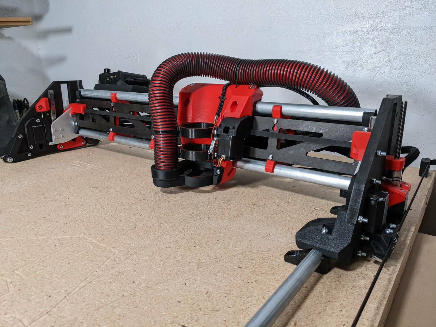

I can change the instructions and the tool mount so the clamp and touch plate sit connected. So if anyone that goes to touch them it has a path to ground, they would only be disconnected while in use.
Now that I look at it, the LR3 had the touchplate this way. Both ends are touching the stepper body, so maybe we did not see any on that one for that simple reason. Any static from the person had a path to ground before they removed it.

It’s always bugged me that the documented way to run the probe (and X endstop, and stepper) wiring is without a shield overbraid and tied to the one component on the machine most likely to develop a significant charge (the vacuum hose!).
I think shorting the probe when not in use would be a good thing- provided it doesn’t freak out FluidNC during operation.

Maybe just arrangements to short the probe and finding a twisted, shielded wire for the probe wiring would be the next step on the machine side of things. Further hardening the inputs, which youre discussing, also seems reasonable.
The shield on the probe wire would possibly help if it’s charge from the hose, provided the shield is grounded. As noted above, the endstop is NC which shorts the circuit most of the time, and the steppers are only around a couple of ohms- so those are less likely to get charged up.
If we are going to shield them I am going to try and find a cover for all of them. That seems the best option, if there is something easy. Otherwise, there is still the x endstop, stepper wires and the probe.

Agreed. I don’t think this is coming from people handling the probe by hand. It certainly could be that, as the probe gets handled all the time.
When I hear of folks killing two pins in the span of a week or two, I think it’s more a situation like mine.
In many environments, dust collections isn’t a big concern, but in an environment like mine where it’s regularly very dry the dust collection charging is unbelievable. I’ve darn near knocked myself out on one of my early cyclone extractor buckets- biggest zap I’ve received since I stopped working with flyback transformers nearly 30 years ago. I got some good ones just reaching around the hose, too- before I stopped using the shop vac hose as a “temporary” measure. That’s one reason the LR4 in my garage is apart right now- looking to beef up my own dust collection grounding.
When it’s dry here even the ‘regular’ ESD events are not the lower end of the human body model, not the 2kV or 4kV stuff. It’s a good blasting.
Harden the inputs, improve the probe so it’s got either a short or a small resistance across it when stowed are probably the two best steps to take.
The thing is, if shielded cable helped with that situation then so would a drain wire. In fact, the better solution in that case may well be to bundle an uninsulated drain in with the bundle.
