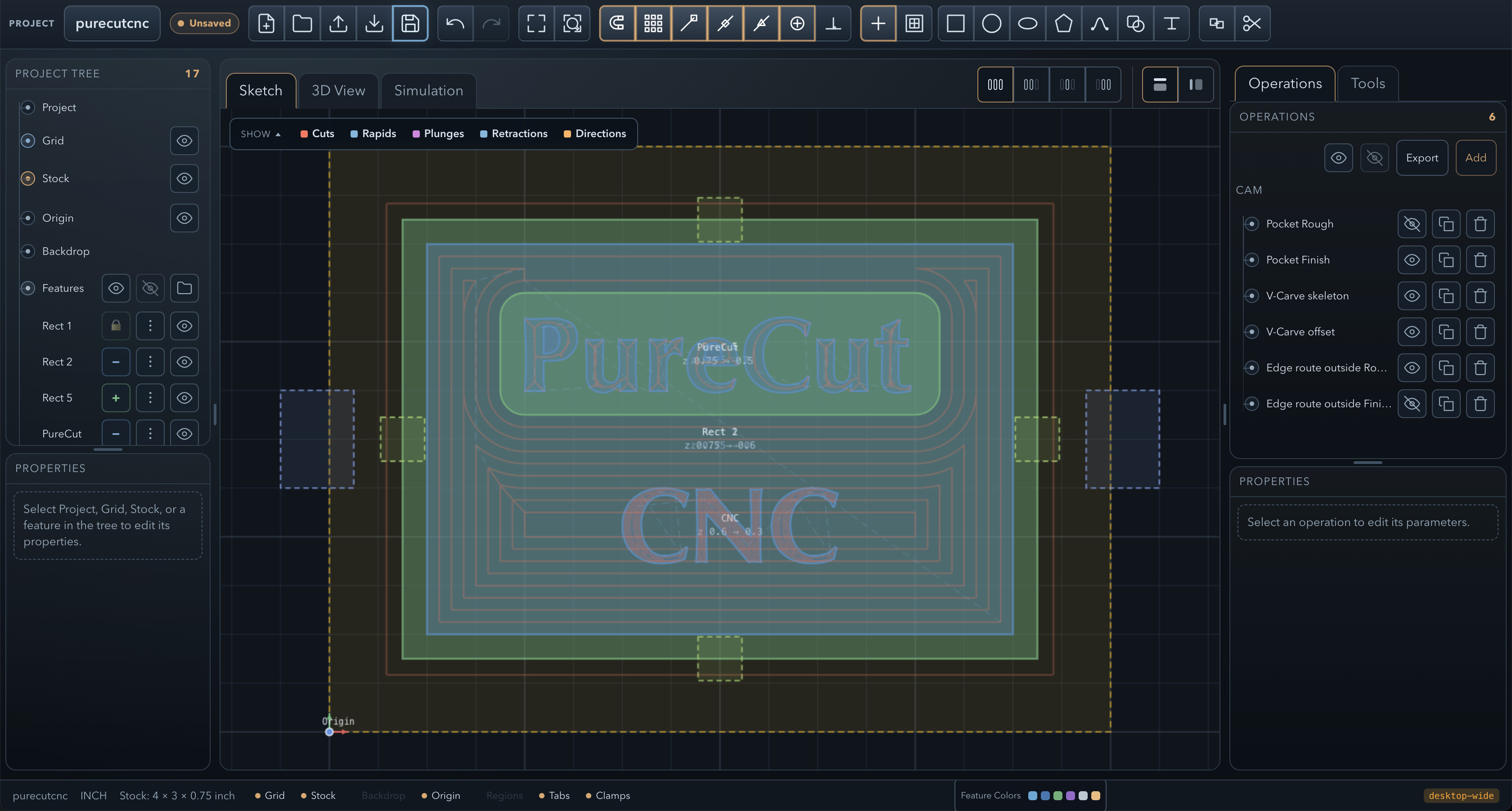

Has anyone heard about PureCutCNC?
I came across this post on Reddit.
Obviously not mine, this is what the creator posted on Reddit.
Hello everybody! I am excited to announce the new version of my pet open source project.
PureCutCNC v0.0.4 is here — and it’s the biggest release yet.
You can now measure and dimension your designs directly on the canvas — linear, radial, and angular, all snapped to geometry so they stay attached as things change.
3D toolpath generation got a serious overhaul. Waterline finishing is smoother and safer, drilling orders holes by shortest travel, offsets are simplified back into arcs, and a new 3D Surface Cleanup pass handles what roughing leaves behind.
The app also runs on iPad now, alongside the existing desktop and web versions, with a UI rebuilt for touch.
Plus: partial .camj import, OBJ import, multi-body STL splitting, STL export, mirror and ellipse features, open-profile cuts, multi-cutter operations, GPU-accelerated simulation, cached toolpaths, and a check-for-updates flow.
99 commits since v0.0.3. Try it — full notes on GitHub.

Cool, it looks similar to this one, FreazyKam Free Browser based CAM
Seems like we have a few browser based options now. Thanks for sharing.
Thanks for sharing this, Karel. Full disclosure: I develop PureCut CNC.
It’s a free, open-source CAD/CAM workspace intended for hobby CNC users. It supports drawing and SVG/DXF import, 2D/2.5D operations, 3-axis surface toolpaths, simulation, and G-code export. It is CAM software only—it does not control or send jobs to the machine.
I’d be interested in feedback from MPCNC and LowRider users, particularly around machine definitions, post-processing, and any workflow gaps. I’m also happy to answer questions about how it works.

Nice work @zerg32 Helical and ramp entries jut got merged, not released yet. the helical drilling will also be added soon and all released in v0.3.0. Thank you for your suggestions!

@Frank_Povazanj there is another feature that is nearly essential to be able to cut aluminum on our CNCs. Trochoidal milling / adaptive clearing.
i need to cut some small aluminum parts on the weekend. let me try to make a proof of concept. I’ll make a GH issue if i manage to get something working
bCNC has trochoidal and trochoidal 3d. I’m not even sure what that is.
@Frank_Povazanj bCNC is an open source python based program you can find on github.… Might give you some idea how to accomplish
Thanks Serg. you can open an issue without the code example. I will put it into backlog.
Meanwhile I suggest that you take a look at the current dev version (browser only). I am not allowed to post links here but you can find the link at purecutcnc website. with helical entry and smoothed pocket toolpath, arc fitting - it already generates toolpath that is more machine friendly.

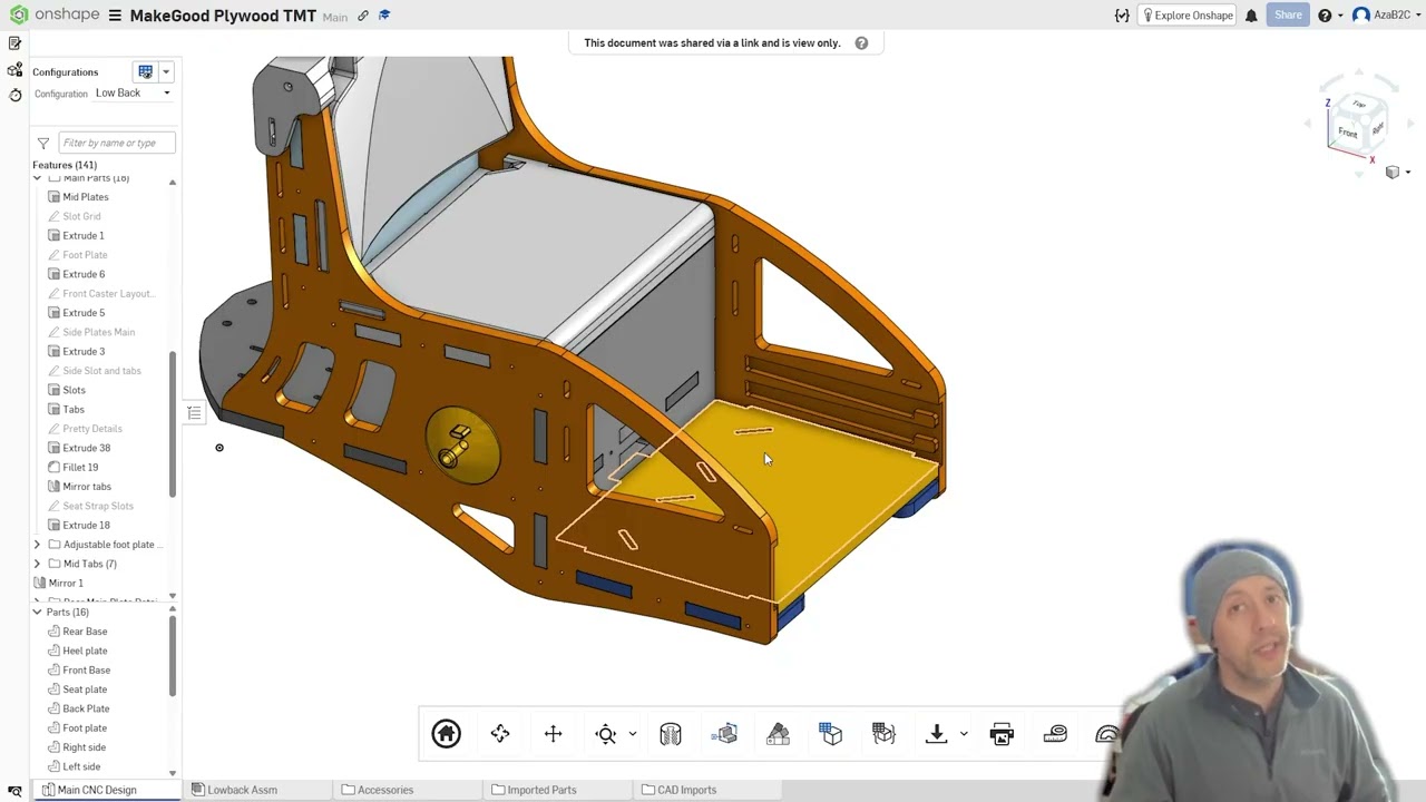

Will share more details when files for the Plywood Toddler Mobility Trainer https://forum.v1e.com/t/whos-looking-for-a-new-cnc-project/54680 are more broadly available.
