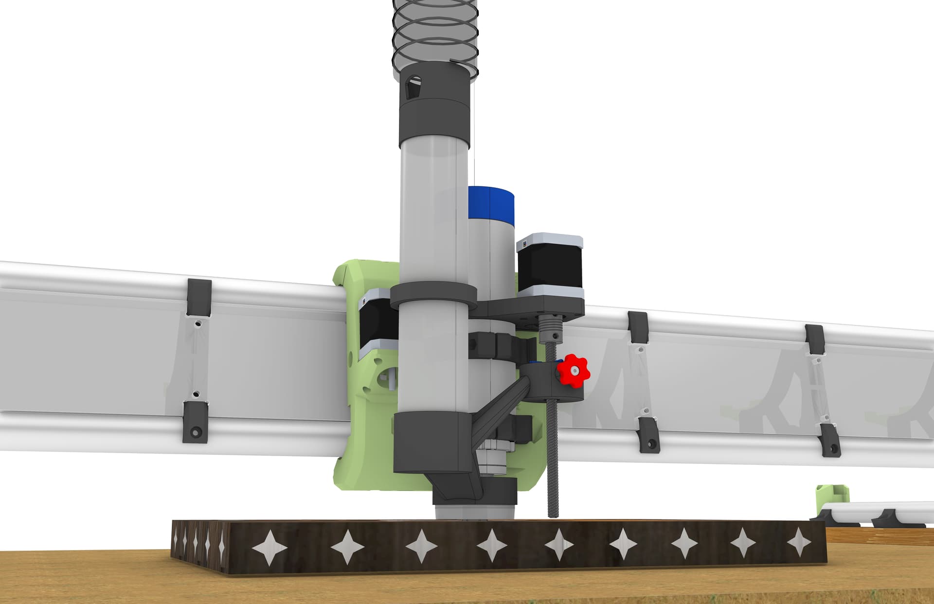

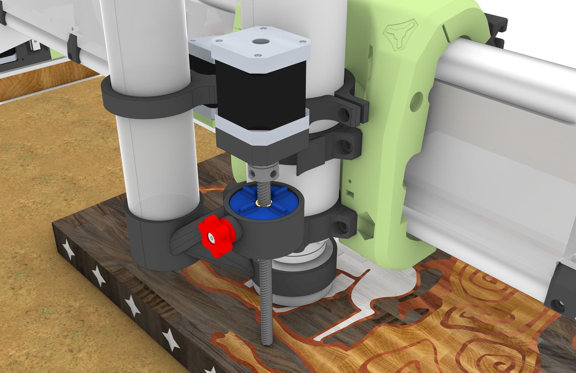

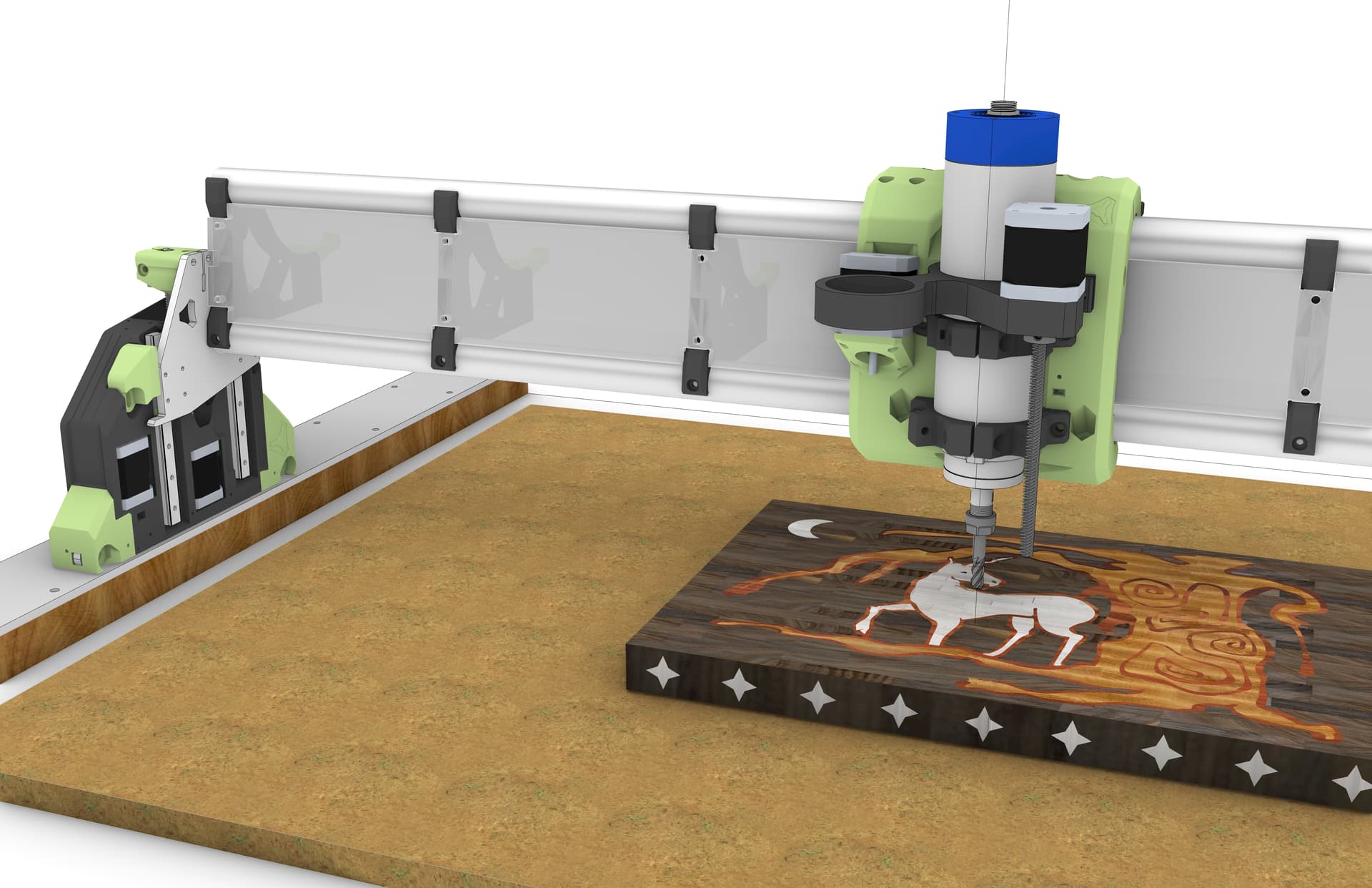

Starting a new “LR4” build thread.
Here are some of my 3D model renderings.
Video of my proposed “z-independant” dust shoe:
Dust_Shoe

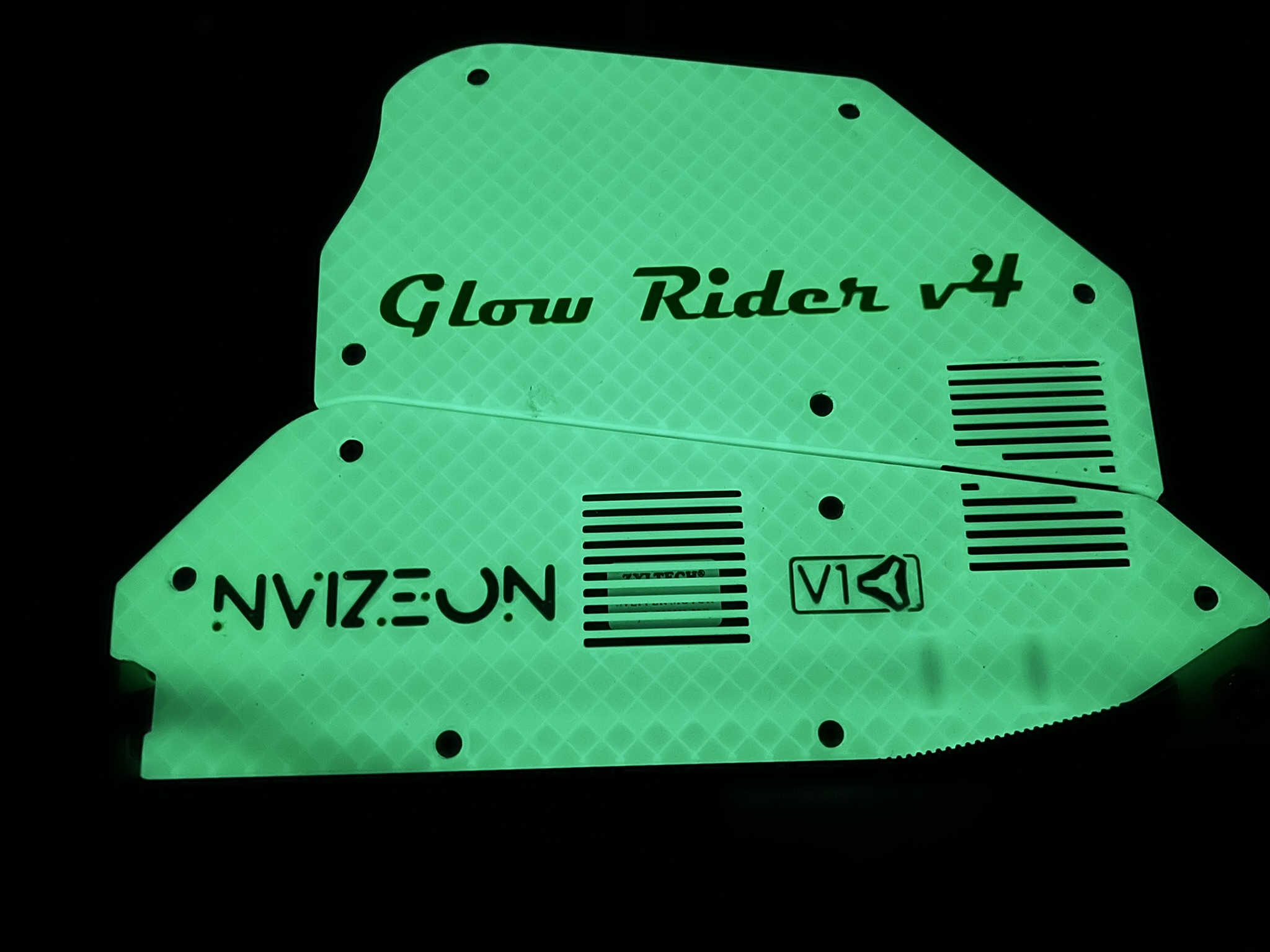

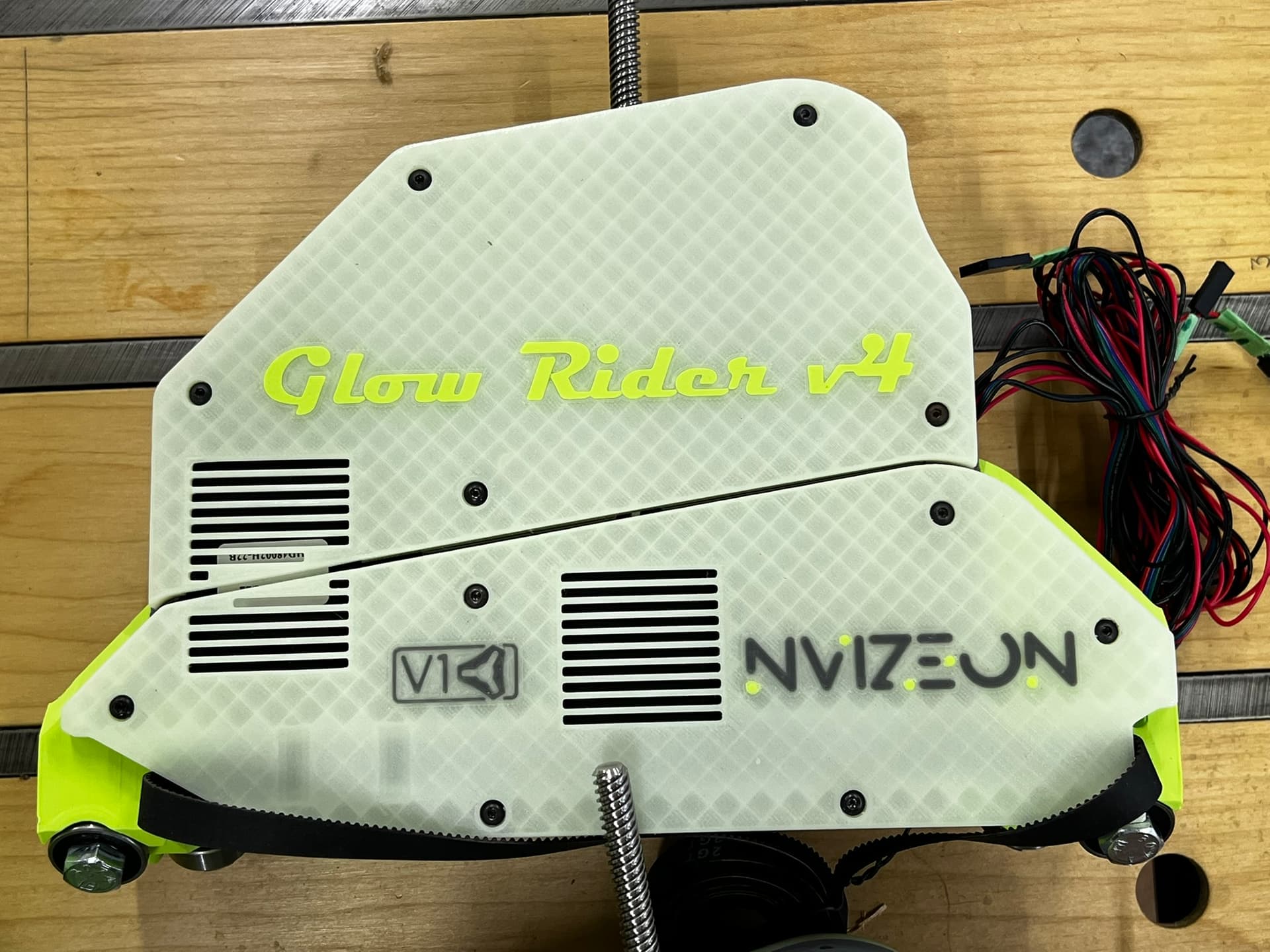

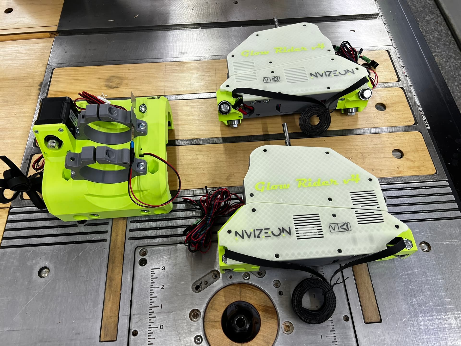

Current build progress photos

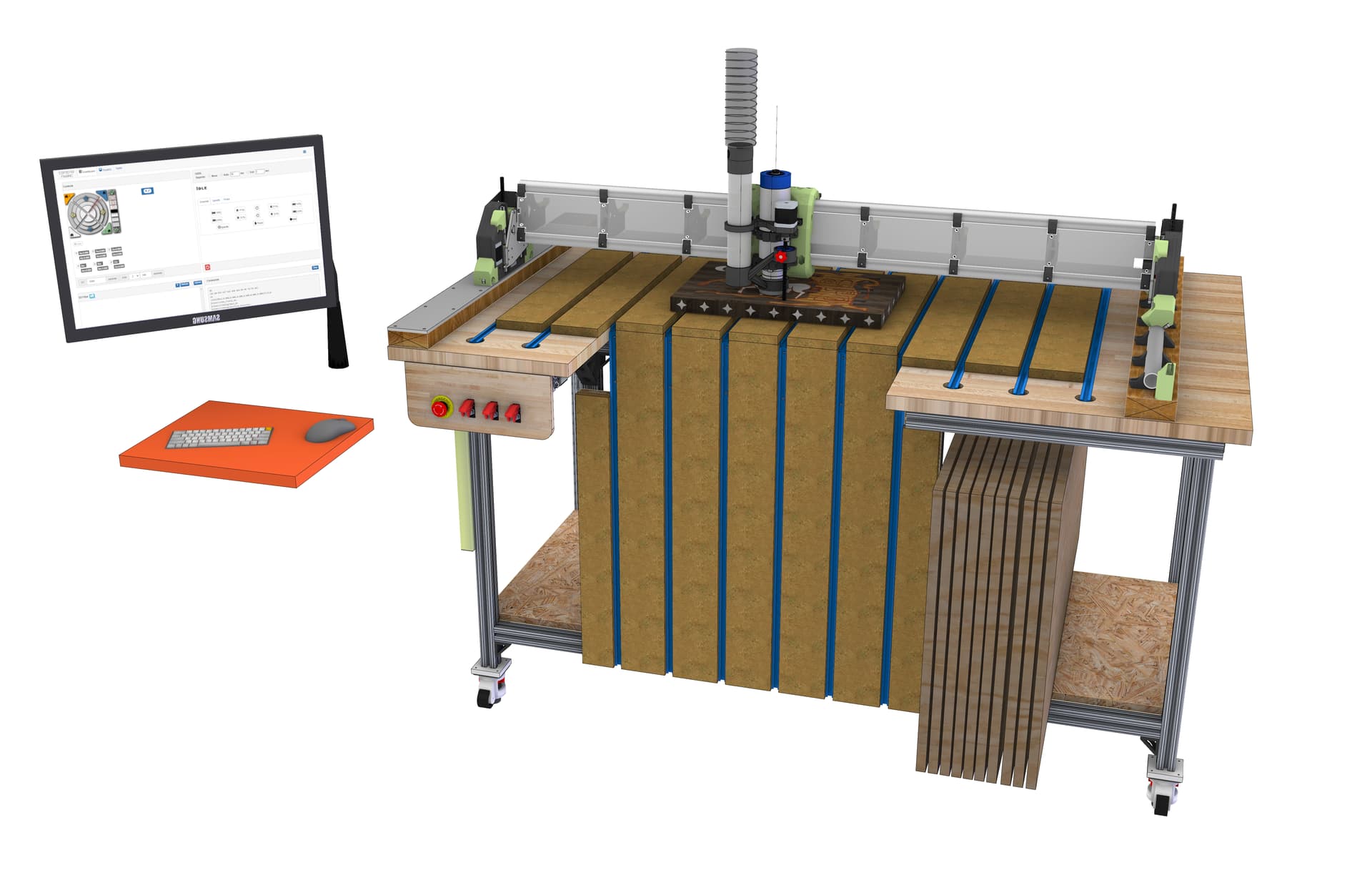

Awesome modeling. I love the drop table at the edge, very nice.
Do you plan to extend the table when not using the drop feature? You have the long axis on X, which is generally advised against but maybe for this configuration it makes the most sense.
In practice most of the items I put on the waste board fit within the flat portion. If I ever have a full 48” wide by 24” piece it can just span over the void.
As far as the long “x” axis I figure there are plenty of full 4x8 Lowriders out there that have a 4’-0” gantry and if the machine is sturdy enough for a 4x8 it should work for a 4x2.
I’m facing the gantry in the long direction (+X) is to the right and (+Y) is going away from me on the MPCNC Primo so I wanted to keep the “x” and “Y” directions the same on the LR4 otherwise my brain might glitch and make a costly mistake.

Why is this advised against?
My LowRider will be 2’ x 4’, and the specific instructions on the Lowrider page state:
“Width (X axis or “Beam”) should always be the shorter axis.”
Key_Points
As I noted above, I’m currently using an MPCNC Primo with the “x” axis as the 48” and the “Y” axis as the 24”, and the table is already made and positioned such that my access to the machine is along the front (48” inch wide) with the cut-out for vertical work clamping.
Since I’ve seen plenty of “full size” 4’x8’ machines with the “x” axis as the 48” dimension, I presume that the Lowrider v4 is capable of having a “beam” that is 4’-0” Long the “y” axis is just the 1” EMT which is hard mounted to the table and the the other side is just the rollers running along the table so from a rigidity standpoint the “BEAM” is the weakest item since it must “span” from two end bearing points and additionally it must support the spindle and is the first point of deflection when the spindle is pushing down into the work piece as well as the first point of load transfer for lateral loads when the endmill is moving in the x or y direction through the work piece.
So I understand the “recommendation” to make the shortest axis the “beam” “X-axis,” but what fun would conforming to rules be? :wink:
