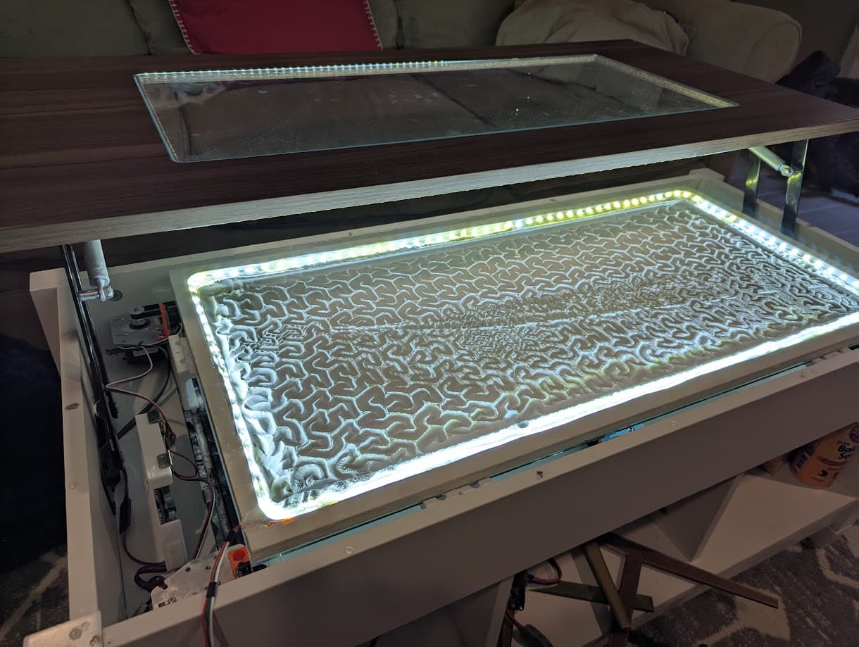

I guess this isn’t technically a ZenXY – but it was inspired by the project. I actually printed all the parts for ZenXY and started designing a table before realizing I really wanted to convert this lift-top coffee table instead (which needed a much more space-efficient CoreXY system).
Anyways, as you can see, I have some basic LED strips around the edges of the sand area (which is on a thin piece of annealed glass). So far this is okay. I will be adding dimming and a switch to it. However, I do see a lot of people using RGB LED strips, and I have the following questions:
  • (A) Do people are typically running dynamically-changing lighting or just using a static color sequence. And if it’s dynamic, how it is controlled?
  • (B) Is this compatible and controllable in some way with the TMC2209 pen/laser controller? If it matters, my current array uses about 0.5A @ 24V (I think, I did measure it, but it was a while ago).
  • (C) I’m considering adding a Raspberry Pi and using the TMC2209 pen/laser as a GRBL controller. That should open up options for me, all around.
On Amazon, there are SOOO many different RGB LED strips, which have a variety of pin/wire layouts. Most of them also advertise all sorts of fun control features, but I assume that’s just a separate controller that comes with the strips, that are pre-programmed to trigger the correct pins on the end of the strips.
Any thoughts on any of the above?

It helps to put the LEDs a little way back from the sand area. 2" would be about ideal. I know that space is always tough. That makes them hit the sand from a steep angle and you can’t see the lights directly.
