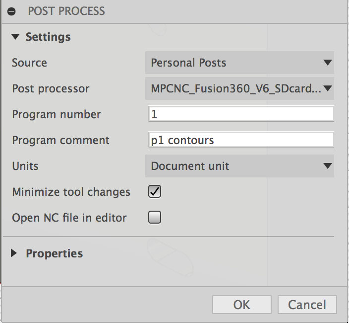

Mac how do you insert the MPCNC.cps?
The properties window changes from Mac to Windows
In the dialog you included the picture of select ā€œPersonal Postsā€ under the ā€œSourceā€ popup menu.

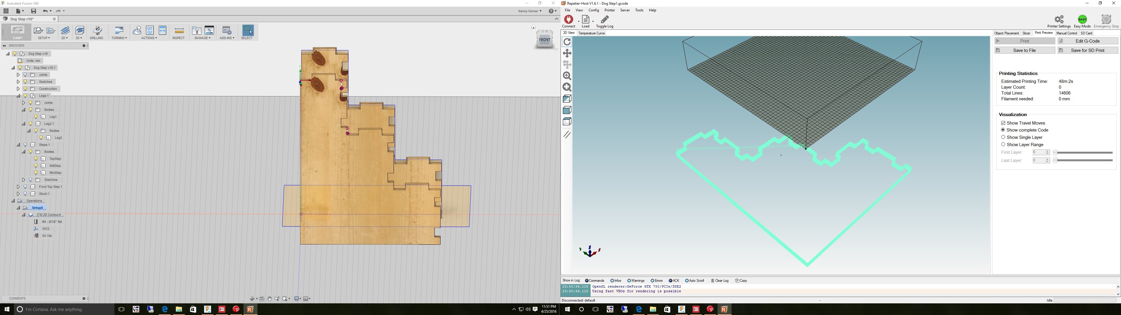

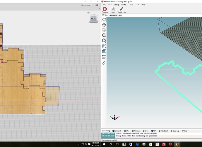

Is here anyway to get fusion to start milling at a chosen corner of a work piece? I tried to move the origin of my tool in fusion but repeter host still shows the machine starting in the middle of the workpiece.
Under the Links tab of the 2D Contour and 2D Pocket operations dialogs there’s an item named ā€œEntry Positionsā€ in the Positions sub-menu. This item allows you to specify a start position for any of the geometry chains in the operation. Give that a try. I think it will do what you want.
I think it a Repeater host causing it to start on the middle and then go to the top left corner.
If you want to post your .f3d file or the gcode file I can take a look at it. If you’re using the MPCNC post processor posted here then it sets 0,0,0 to be at the location of the tool when the gcode is executed.
I’m running the V6 MPCNC post processor. Ill send a link of the Fusion file. I know its a mess and I’m learning fusion. Just trying to print 1 sidestep.
http://a360.co/1Tu2CRR
I don’t see anything wrong wth the Fusion 360 file. It is conventional milling instead of climb milling though With regards to the Repeatier host it may be that you need to define a ā€œprinterā€ that has its origin at the same place as your MPCNC
I can not understand why even if I copy the file to the .cps Funsion360-CAM Data folder can not find it in the list of Posts (in Windows 7)
Can you help me ?
In MAC OS it works fine
Thanks
ManuCNC,
I have only used windows 8 and 10. You should be able to put your post processor file anywhere -> Open the Post Process dialog and specify the folder’s path by selecting the … box under Configuration Folder. Then select your .cps file in the Post Configuration menu. You are getting an empty list? Try using another folder for the fun of it.
I just keep my custom MPCNC posts in a folder with all my MPCNC design folders.
