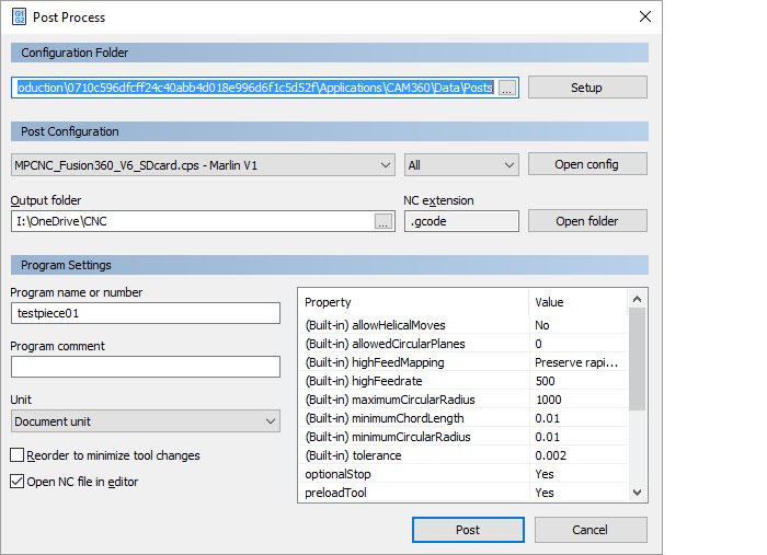

good evening,
I’m trying to generate gcode from Fusion 360 but I read that you need to postprocess a file to recognize the MPCNC …
I already have
Unfortunately my English is poor, could someone kindly explain what steps to do once I click on PostProcess?

I loaded the file in the General folder, select MPCNC … now?
As an extension indicates .tap … never heard …
I have posted on my blog how I got it to work - see top post
http://mpcnc.blogspot.com/
Hope this is helpful? Let me know…

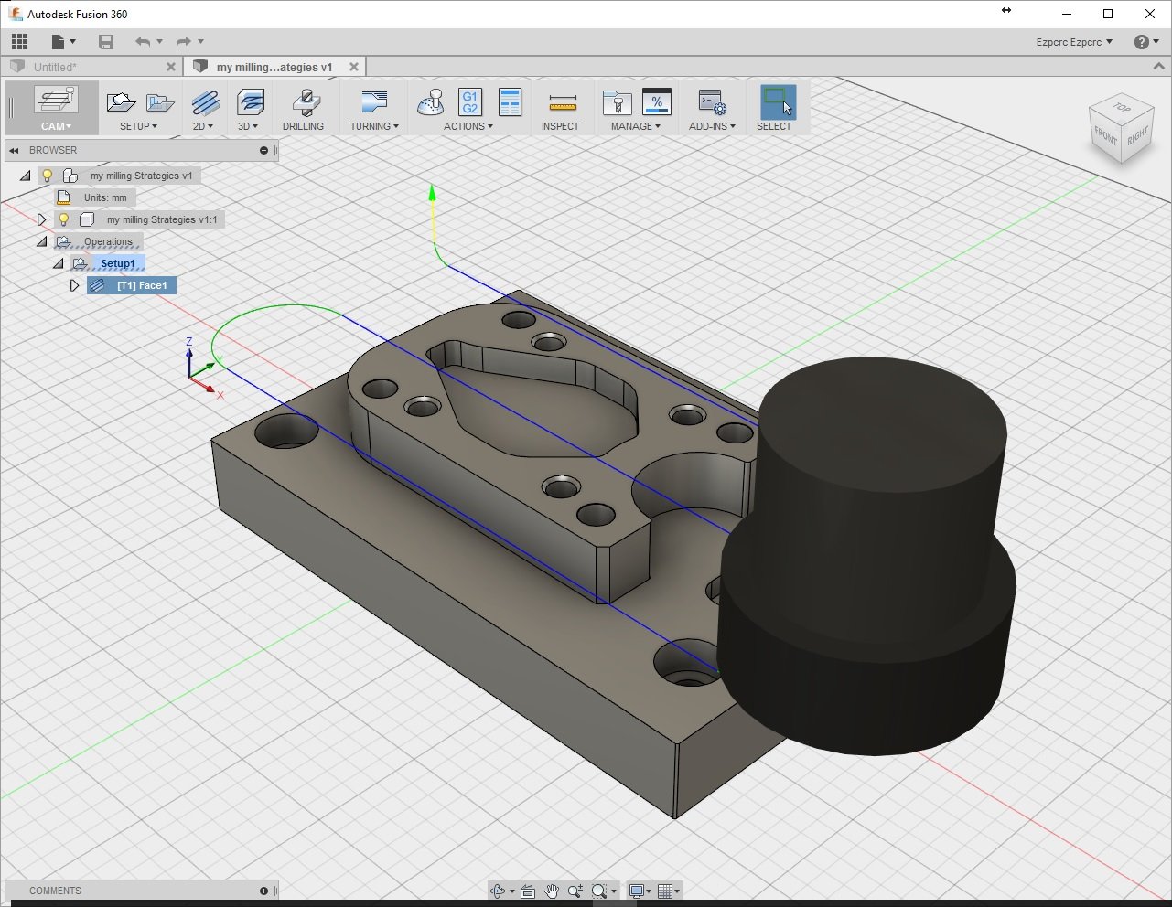

Hi,
I’m new here, from South Africa… Just finished assembling my MPCNC and managed to get marlin configured to the point where I can control the machine with repetier host from the computer.
Now I’m trying to generate some gcode with Fusion 360 from my Mac and Im getting a bit frustrated.
I’ve tried all the post files from this thread and followed plenty tutorials but what ever I do my gcode file always looks like this:

mmmm… if i use the x-y-z orientation as is, it works. when I change the axis orientation during the cam setup proces in fusion to have z point upward the post fails like above.

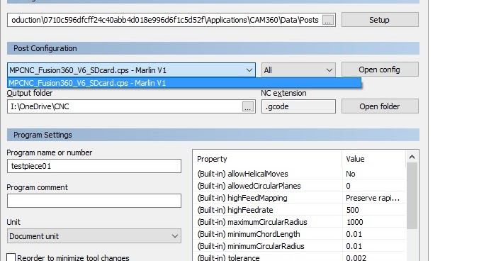

I am not that familiar with Mac machines and operating systems. But if seems like you should have MORE geode generated. If when you click print in repetitive and the zaxis goes up and stays and and don’t come down to start cutting, then you need to flip your connector on the RAMPS board.
But FIRST you need the post processor to output correctly. Does the marlin mpcnc post file show up when you click Post??
Could you post a .f3d file of your fusion 360 project if it’s not too big? You can save one by using File->Export… and selecting Type==Archive Files (*.f3d)
I’ll take a look to see if I can see anything.
