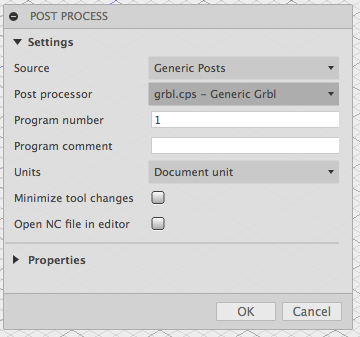

Wondering if someone could help me understand the user settings in this post processor. I’m not getting any rapid movements, and I’m wondering if the setting that sets “Use G0” to false is causing this? Are there any issues that would arise from setting this to True?
1
Marlin doesn’t actually use rapids (grbl does if you are using that), Go and G1 do the exact same thing.
I can’t help with fusion but it should move faster when not cutting, speeds can get specified every line if needed. That is kind of the rapids work around.
I could change the speed line by line, but why hasn’t anyone else using this post processor reported slow moves between cuts? Gotta be something else.
I have useG0 also set to false and get fast movement between cuts. As Ted mentioned, marlin treats G0 the same as G1 so unless you supply a feedrate to the G0 command, i.e. G0 X0 F3000, your G0s are going to move at the same feed rate as your last G1. There is a setting in the .cps file named highFeedrate that seems to be used by Fusion us useG0 is false. In my .cps files it’s set to “highFeedrate = (unit == IN) ? 500 : 2000;” but I also seem to have it set to 3000 in the Properties section of my “POST PROCESS” dialog. This shows up, for example, at the end of my gcode as:

  2. I wasn’t getting very fast moves between cut locations. No matter what value I changed the Post file to use for highFeedrate, it was still moving the same slow speed. It turns out the setting in Fusion’s Post Processor dialog box was the culprit. It overrides, and adjusting to that value works a treat!

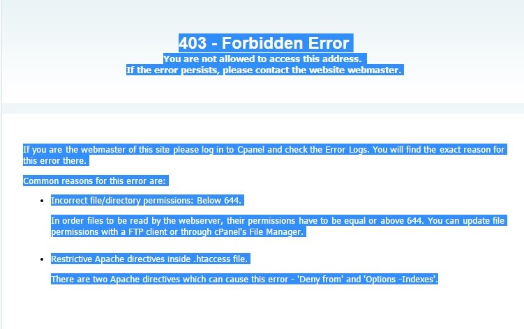

Brian, I get a download error shown in the attached picture when trying to download V6. V5 works OK
thanks…
Bill,
I’m getting the same download error. I never tried to download it before so I don’t know if it ever worked. You can edit V5 to match V6 with a simple change to the last function onClose().

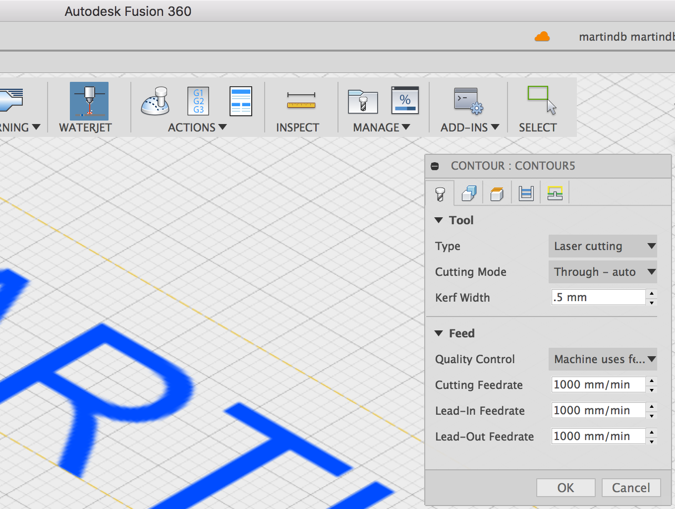

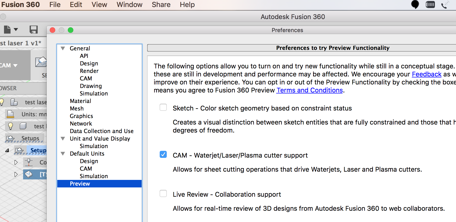

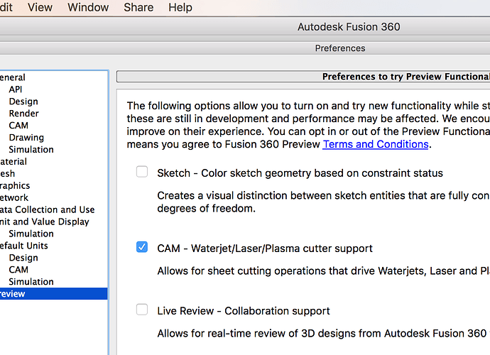

Does anybody tested the Waterjet/Laser/Plasma preview feature in Fusion 360? It add toolpath support for this kind of machining…
The postprocesor for mpcnc fail, I think because it need to accept the new capability (CAPABILITY_JET). Any idea?
From this autodesk template we can make the specific post for mpcnc
http://cam.autodesk.com/posts/post.php?name=jet

Download links are not working for the MPCNC_Fusion360_V6_SDcard.cps. Can someone repost it or email it to me.
Sorry, I’m looking into it.
Its giving me a permission 644 needed for the file.
The permissions are right, it has something to do with the last big dns attack. I think a .zip file will work instead or .rar. The .htaccsees file got locked down much more and .rar is n the no no list.
Not my file, I did not create it, just re-posting it.
MPCNC_Fusion360_V6_SDcard.zip (4.67 KB)
