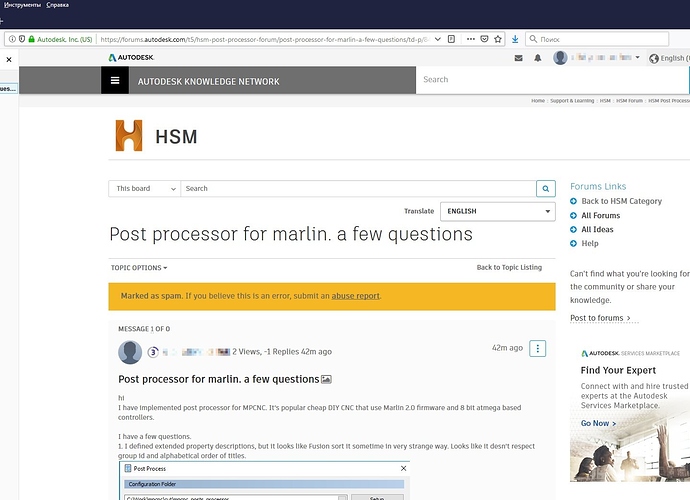

I’m giving them the benefit of the doubt here. If it’s something nefarious, that would make no sense to me.
he he )
[attachment file=77806]
[attachment file=77805]

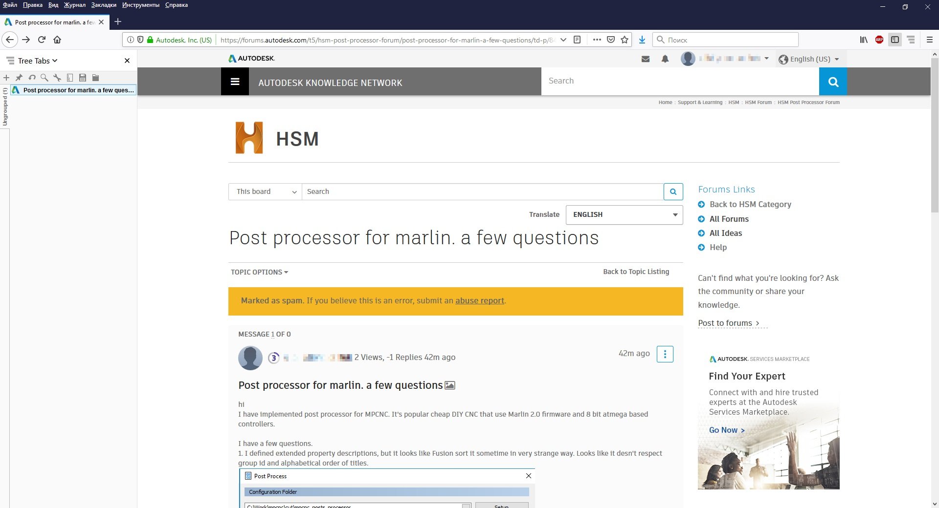

Maybe it’s a script. first version of first post had 2 links: to github and to thier site of PP library. and it was my first post on the forum. Then i edit it and remove links. No success. I reported abuse twice. no succeess.
Then I wrote second post without any links at all. No success. reported abuse about hat post too. no success.
So all I can is just waiting that some time a moderator maybe will check that reports and unban the post. or not unban )
I would guess you’re waiting until Monday morning.
probaly you right. lets see
but honestly if this is script - it is too aggressive as for me. it can just cut the links and/or do not ban the account for future posts. first time when i see such thing
My anti-spam Akismet would have blocked you. Once it blocks it, if you try to post again it would just flag them all after that.
I have zero control, other than disable it. I know akismet is very widely used. Two external links (external to the forums) in first post are a pretty big flag from what I can tell. I get flagged and edited on my own Thingiverse comments for editing a comment more than once. Spam filters suck but without them there would be thousands of BS posts.
Smart spam bots/people, make a post, wait for it to clear and then go in and edit them to add links, so now edits are a flag as well. Best to always make a plain jane post and then add a second with other material and links.
We can’t even have Private messages anymore as the spam bots ruined that for me.
I thought they actually had a PP submission form?
I didn’t find. Description of Autodesk HSM plugin of Visual studio code said that the plugin can. But i didn’t get how
I just looked as well I don’t see the form anymore either. I have not tried with VS.
Vs is nice dev environment, has a lot of extentions. Not so sothisticated as “adult” Visual studio, but also very handy.
You may use it for build firmware if install PlatformIO extension. PlatformIO could flash furmware remotelly, with help of remote agent application
I use VS just never looked into the HSM plugin.
You guys was right. It’s automatic spam filter. Admin restored posts and gave his apologies.
