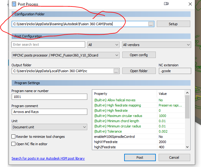

I made something in fusion I would love to use this , but I have no clue how to. Do I have to place this in the autodesk lib?
C:\Users<your user id>\AppData\Roaming\Autodesk\Fusion 360 CAM\Posts
Your profile might be stored differently… But easy to find in Fusion

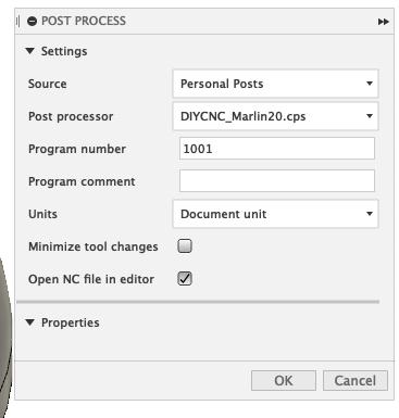

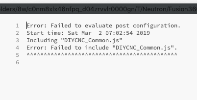

Hi Guffy,
I tried to update the PP on my mac. I can select all 3 PP, but DIYCNC_Common.js fails to get included. As a result, no gcode is being made.
How can I fix this?
regards,
Marcel

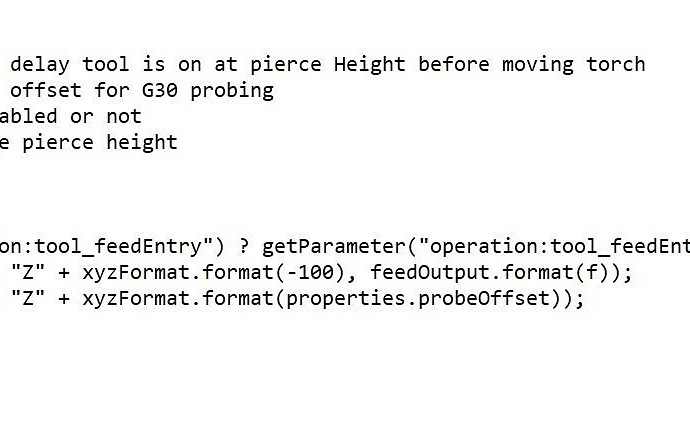

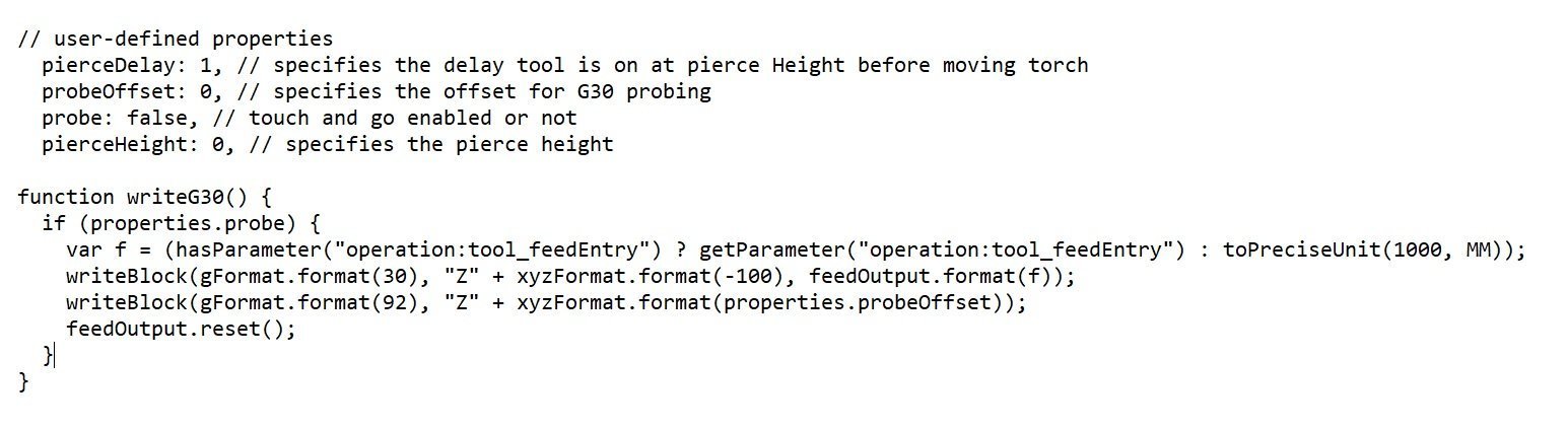

Wondering if this is a place where I may be able to request a feature? I haven’t been able to find a post that has the features needed for plasma cutting that also works with marlin. I’d do it myself, but all I know about scripting this stuff is that you cant just copy and paste some random bits of code and expect it to work. I’d like to know if a function can be added to enable ā€œtouch and goā€ abilities. I’ve attached what I think is the code responsible for this feature from another post processor found here;
https://cam.autodesk.com/posts/post.php?name=mach3%20plasma
Id also like to know if a feature could be added to call an M109 after each time power is turned on ā€œM106ā€?
Have you tried copy and paste all files into the post processor folder? I made the mistake of only copying the marlin file and left out the common.
Yes, I copied all relevant files. As can be seen in my attachment of earlier post, I can select the marlin pp but the properties do not appear…
Hi Marcel
I have just all 4 files (3 cps and 1 js) in same folder (my custom folder) and it works well, at least in fusion on windows.
As temporary workaround i can suggest to just insert content of js file in required cps file (replace include command) with a text editor
And compare case of the js filename on filesystem and in cps file. On Mac case may matters
