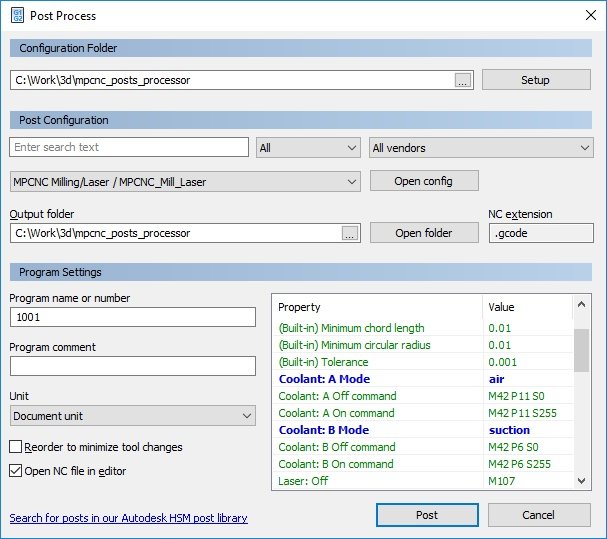

ok, so I polished the code (removed some unnecessary spaces, etc)
and improved README on the githib (make properties desriptions as tables)
Also I added Resources section at the end with useful links. So anyone can write a postprocessor too :wink:
And I added coolant code for issue coolant-related g-codes (based on M42, by deafult use pins 11 and 6). So as example you can connect a relay to pin 11 that manage air jet valve and a relay for dust sucker to pin 6. Then define mode “Air” to channel A in the postprocessor properties and “Suction” for channel B. Whenever you will set Coolant in the CAM (Air OR Suction)- postprocessor will inject corresponding g-codes for milling sections.
[attachment file=77524]
I think that it’s not bad for now, haven’t additional ideas at the moment to add features in the nearest future. But pls report bugs and I will try to fix if any

Done
Date: 01.12.2018 19:43:10
Message:
1. added properties to control over produced comments
2. added tools table and ranges table to job header
3. added support Inches mode
Modified: MPCNC_Mill_Laser.cps
Modified: README.md
