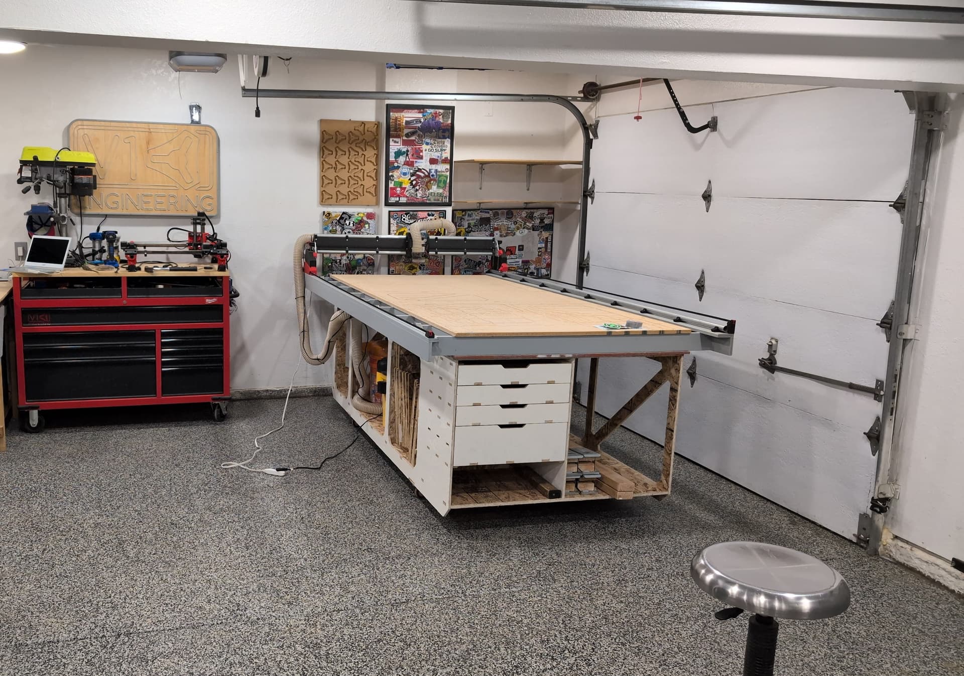

Full size LowRider table base
This looks neat.
I have recently built (technically I’m still building, I’m currently swapping the 3d printed plates over to the 1/4 MDF cut ones) a LR4 for my first CNC machine. It’s friggin sweet. I also built the $200 non-cnc table (for more like $80, I had a lot of 4” and 6” baseboards leftover from my house build so I mostly used those) and it’s sitting on sawhorses. I’d love to put it on a workstation like this that utilizes the CNC to create it. But I have no idea how to get from Onsuite to OSB. I’d happily build one.

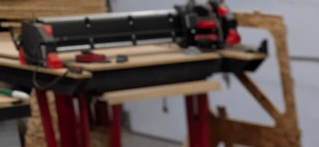

Did you have a portable setup? … maybe this is off topic? I’m thinking about the feasibility of a portable setup myself.
I was pretty sure I did a some pictures of it, I know I did some instagram pics because at one time I lasered the entire surface.
hmm, still looking,

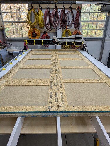

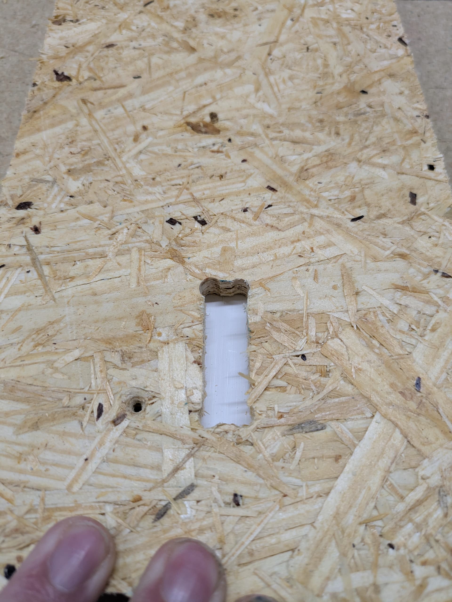

So first the good news - I didn’t blow up an end mill yet and I have something that almost resembles a finished part, as long as you don’t look at the far end. I did quite a few test cuts at the other end of this sheet and then let the piece finish. The ends didn’t quite line up (you can see the uncut factory edge closest to the camera) to be cut but it doesn’t matter, this was my first real full size cuts and was all testing.
Now for the less good news…

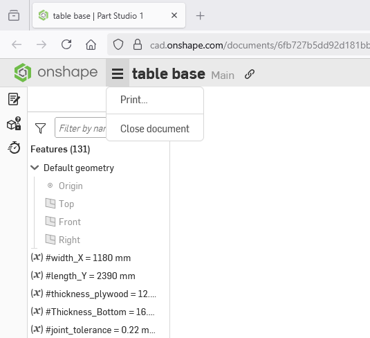

In Onshape, I can’t change the thickness of the materials. For me, even when logged in it’s in read only mode so this is the “default” thickness.

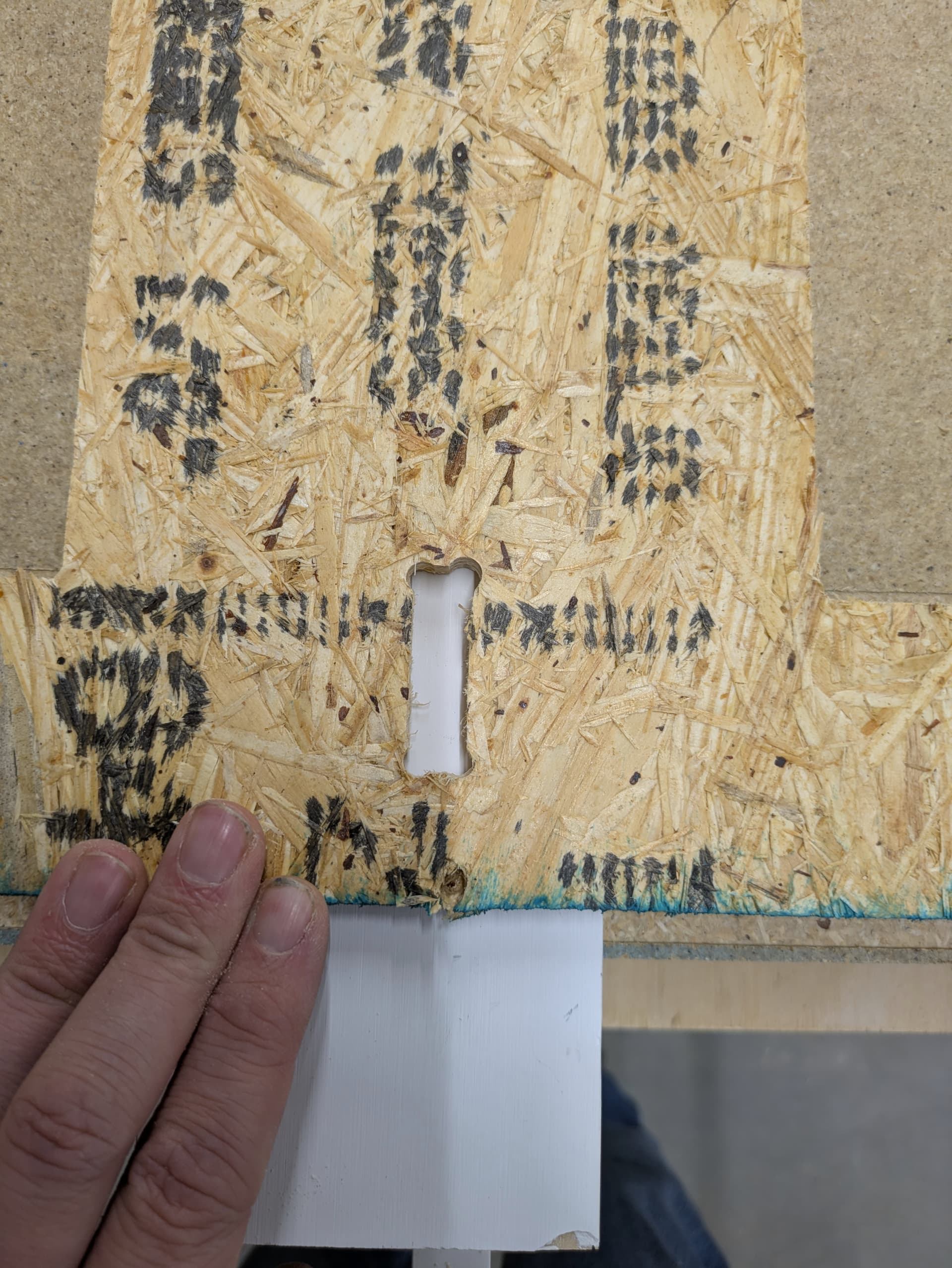

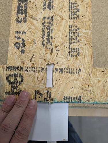

My cutouts are wonky. Using the automatic overcuts you can see the corners look different. The first pic is of an E-W orientation, the second is a N-S orientation. I would expect all 8 corners to look identical, but they don’t. In that second picture you can see they are all a tiny bit different.
Settings were 25mm/s feed and 6.5mm DOC with a new 1/4 single flute endmill and the Carbide3d $80 router. I backed off Ryan’s settings from Full size LowRider table base - #82 by vicious1 just a bit, I wasn’t brave enough to fully send it on the first cut.
you should be able to copy it to make your own changes.
slow down to maybe 20mm/s just to get things working right, mess with the spindle RPM until it sounds good. Then bump it up a 5mm/s each successful cut.
Make sure you are using a full depth finishing pass with a 0.6mm step over.
Also try conventional instead of climb, or the other way.

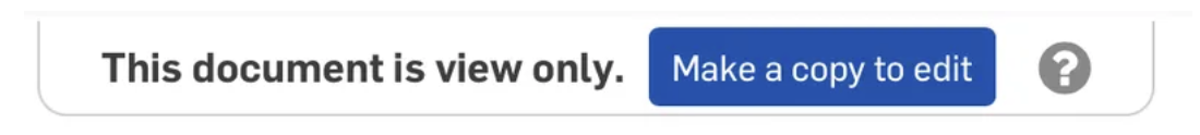

The most common errors people make when trying to open my files in Onshape is not making a copy.
Press the blue button and all should be OK. For some reason, for most it’s not clear that this is necessary!
Cheers

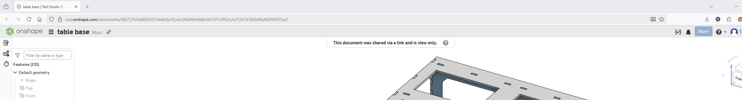

Thanks Peter. I don’t see where that would be though, despite a thorough search. While logged in I have the below message where I am expecting that big blue button to be and where it appears to be on your screen. I am on a free account, if that matters. I’m using the link from the first message.
I can copy the geometry of the part via a PARASOLID or STEP export and import that in a new document from a downloaded file, but it loses all of the parametrics and variables doing it that way so I can’t easily change thicknesses, for example.
And where it’s “supposed” to be, as an alternate location, there is only Print or Close.
I’m logged in for all 3 screenshots above.
I tried this on 2 different browers, just in case it’s a Firefox thing with all my extensions. It was the same on a clean install of Edge.
Sorry to turn this thread into Onshape process tech support. x.x
