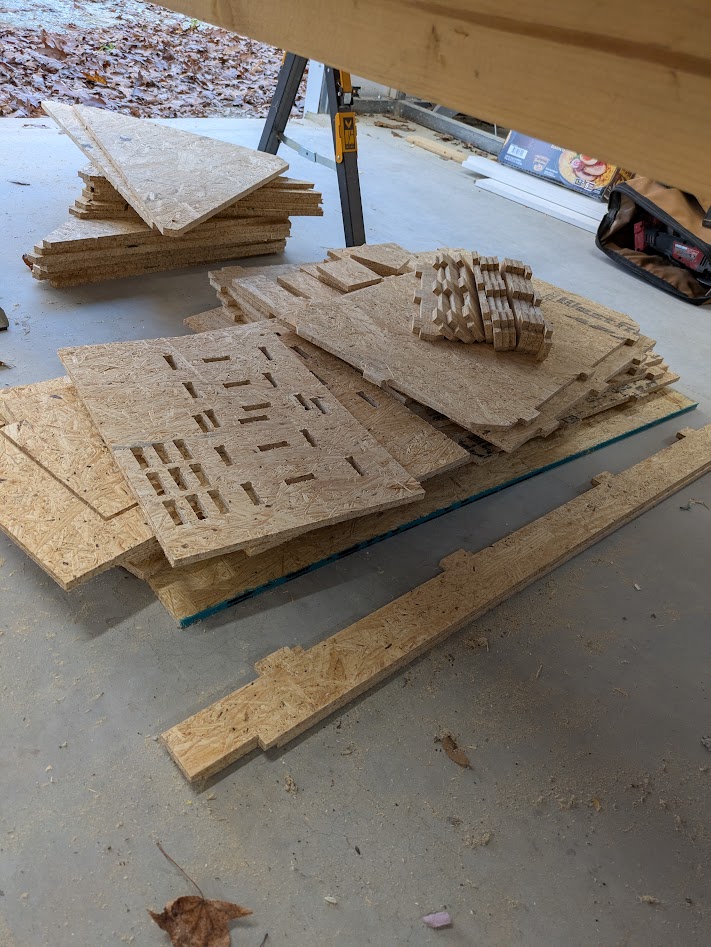

All of the pieces are finally cut as of 20 minutes ago. Going to start assembly this afternoon. Wish me luck
I’m excited!

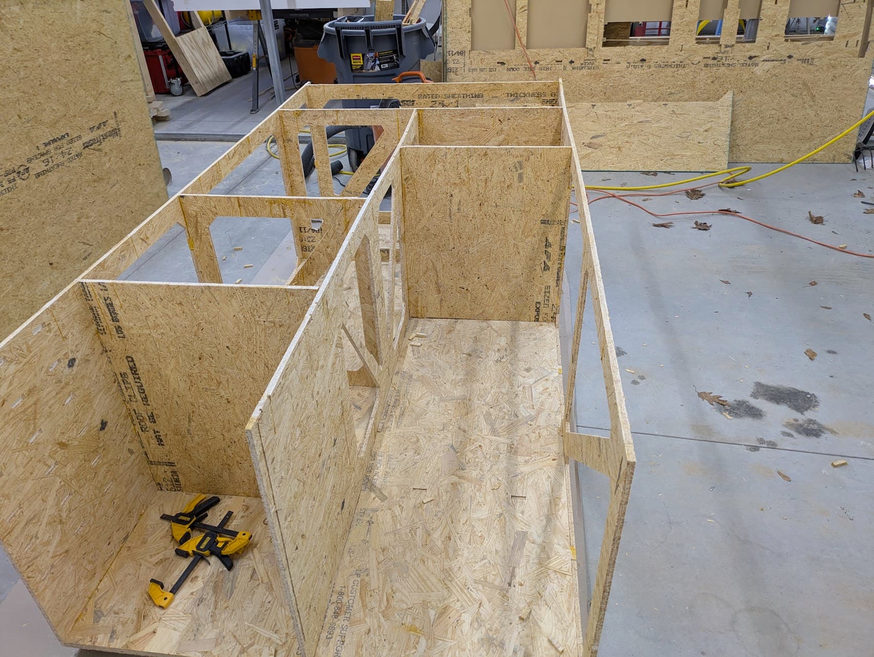

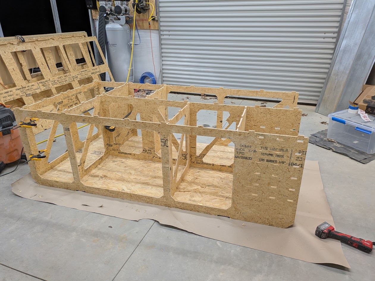

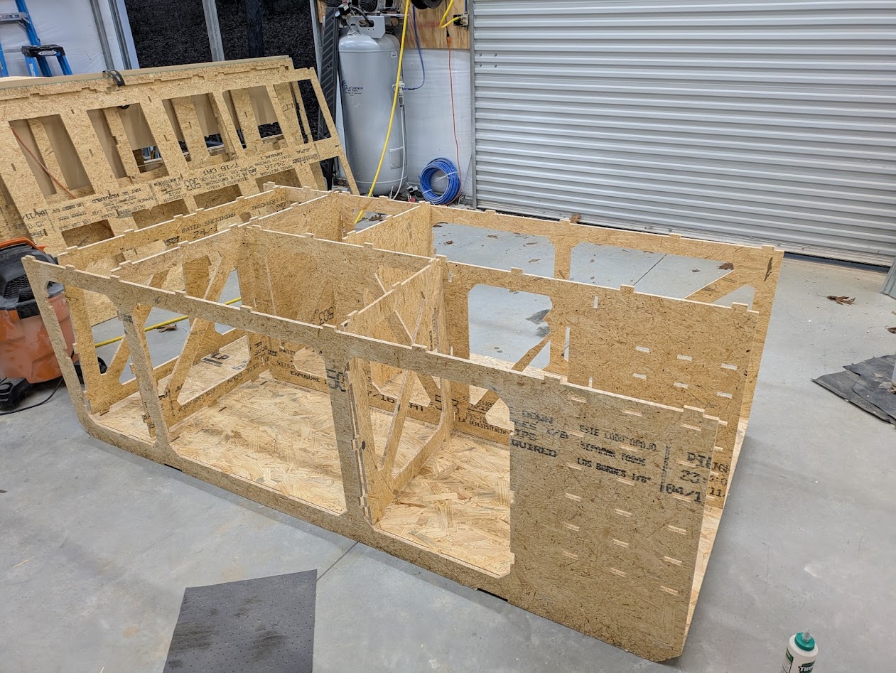

Dry fit
Glue Up

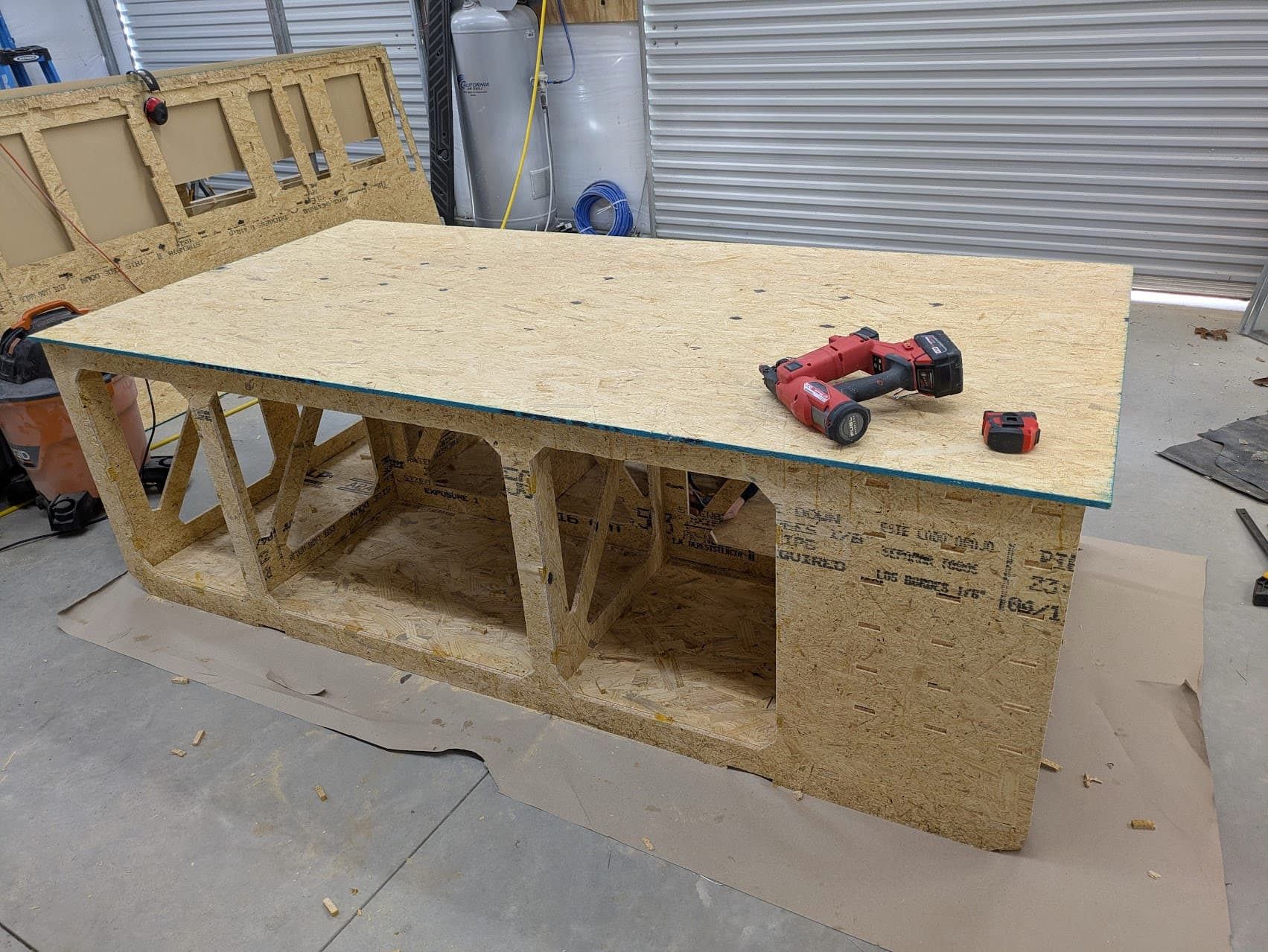

When I got to the top, something isn’t fitting right. I wouldn’t fit even with the most vigorous persuasion. I will take a look at it tomorrow, but my first guess is I’m recutting it. The good news is have an extra sheet
Like the tabs all lined up but were too small, or they didn’t line up?
PS it is super crazy to see that in another shop…I just finished making mine.
Tabs are the right size, but it’s like the sheet is a trapezoid instead of a rectangle. The ends fit at one end or the other, but not both at once. It was time for dinner so I haven’t taken any measurements to see if the top is out of whack or the rest of the table is… I’ll look tomorrow more.
So the answer is kind-of “all of the above” - the top is out of square by maybe half an inch, and the base is out of square by about half an inch (in the other direction) so it’s not close enough to make it work without putting torsion on the whole box and lifting one corner off the ground. So on to plan B.
Off with their heads.
Yeah I lopped all the tabs off the top plane, hit it with a belt sander, then glued it up.
Elegant? No.
Functional? Yes.
It’s not the primary cause of misalignment, but hypothetically, if someone were to mount the middle reinforcement upside down despite making a mental note of it during the dry fit it could make the drawers unusable as-is forcing them to probably buy some cheap bottom mount drawer glides. Hypothetically, mind you. I would NEVER.
Root-cause of the whole thing is, I think, needing to square the whole contraption up again. I can’t remember if once I cut the strut plates if I re-did that step or not. Either way, when I move the CNC to the new table I’ll relevel and resquare then flycut the surface level. I know it’s out of level by just a tiny bit but I didn’t want to level it on a known-temporary surface.
Oh no. That is a bummer. Good on the fly thinking, though. It will work just as good no problem.
