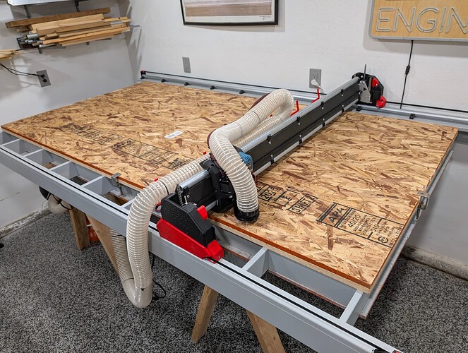

Full size LowRider table base

Almost done, drawers and shelves left. For the shelves, I got 1/4" hangers, so I did not have to do tool changes. Amazon.com
I think I am going to move the CNC over for those, though. We’ll see, maybe I should let the glue dry overnight.
So far the build feels super rigid. I am beyond happy with it so far. I can put all my weight on the far corner and it does not tip or flex.
Assembly was simple. Glue and brads
I added the bottom runners first.
Then with it upside down I added all the parts to the middle.
Then the bottom on to the middle Assembly.
Add the back piece.
Flip it over and I sanded a small chamfer all the top tabs to make sure the top went on easy.
Add the top.
Flip again and add the wheel plates and wheels.
Flip again, add the drawer sliders. At this point it is time to build the drawers, add the shelves, touch up paint.

I was literally just swung it around superfast and the wheel caught on the crack in the floor and it cracked the glue. I need to flip it over and take a look. DAng it.

Im guessing the top is a full piece of plywood so I am assuming you are adding “wings” of some sort for the y rail and everything to sit on? Or am I missing something?
I am just going to slide this one on top.
Right now this is on Saw horses.
Ahhhhhhh that makes a ton of sense. I missed that part. Thanks!
I can’t wait to look at that wheel. I had that thing up on two wheels and rolling it around so it can’t be a load thing. I must have just hit it way too hard on that crack. Lots of orders to get out today and I am getting a late start since I wanted to put the shelves in and get that “done”
Okay it looks like not enough glue or a funky piece of OSB. I scraped it clean more glue, brads, and to be safe I added a screw to each pad. No more spinning the table around at full velocity. Seems like a fluke. :crossed_fingers:
