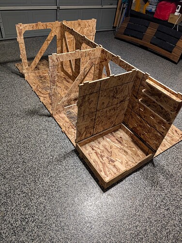

This is kinda parametric but I realized I made the tabs funky halfway through so some of it does not translate well if it moves too much.
Slowly getting there. I am going to change up the drawers a little bit.

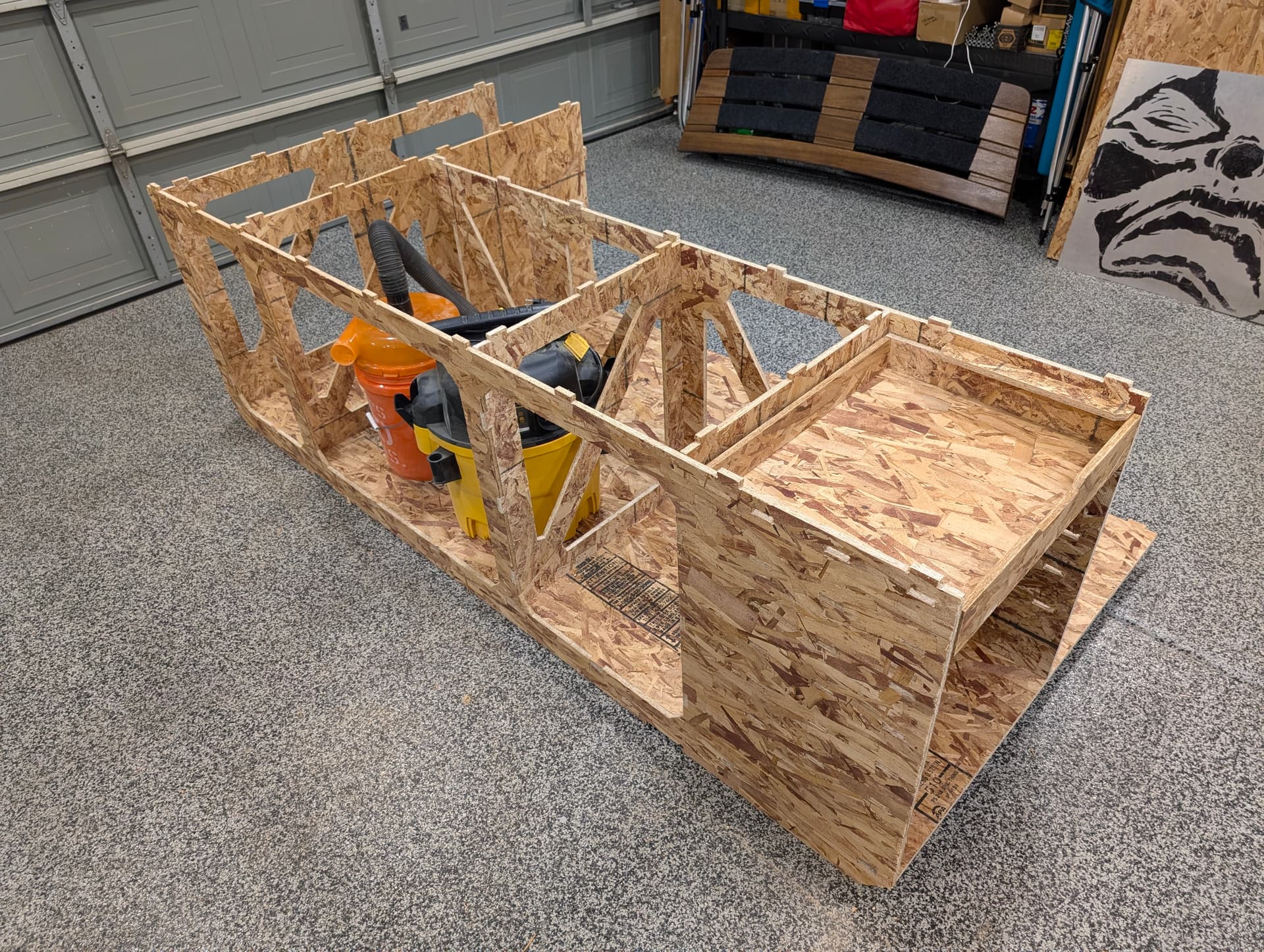

The tabs and slots are a pain in CAD but assembly is a breeze. There are no screws or glue yet and it is rock solid.
Need to figure out what surfaces are getting painted. I think maybe just the two outside faces (not cut yet) and the inside of the drawers, then leave the rest.

You get to live with that project file if you release it so be sure you’re satisfied with anything you find “funky”.

That looks excellent! I’m a huge fan of tab and slot construction.

It sat just fine on the two small runners under the bottom, then the side just snapped on. There are probably too many tabs for the top but whatever each one only adds a minute of cut time.
I hope to make the last three major cuts in just a bit, then figure out the drawers later after I paint and assemble this thing.

Cutting the Top now, that is the last large piece, then just drawers left.
I think I am painting the outside faces of the sides black and the center rib. …maybe all the inner cut edges as well. Try to look like I care but not going for a huge painting project for a table that goes under my other table.
Edit…White, I have lots of white here. If it sucks, I will repaint it.
