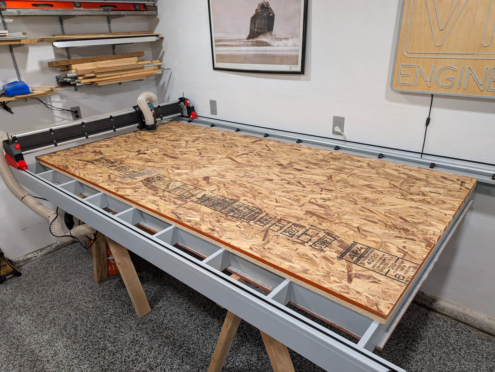

Full size LowRider table base

I am tripping over myself wanting very much to like @Ryan’s project (it is very cool!) and at the same time thinking in terms of it being a commercial job!
It’s the most fun you’ll have for the buck since I built my core one cabinet!

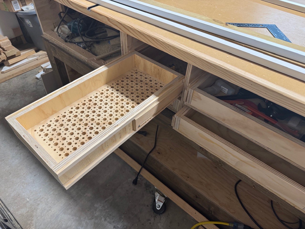

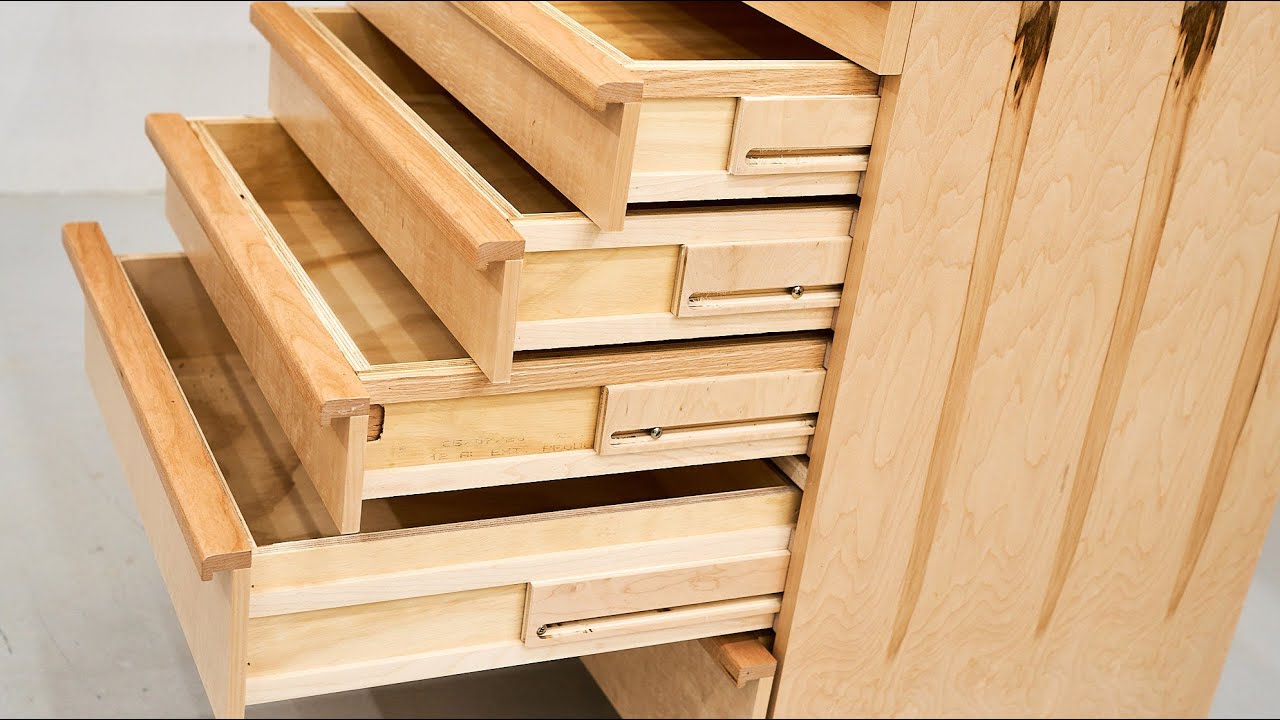

Making your own full-extension drawer slides is an option…
These were like $6 at Home Depot right before Covid, and were like $30-33 at the peak of pricing stupidity…
Tell me whyyhyy… Eh… How…
Well… Obviously, because I didn’t want to spend the amount of money it cost for drawer slides on my workbench…
So, since I was too cheap to buy them, I searched around for a way to DIY them, and came across this video
I did them by hand, but I suspect it’s possible to do this with the CNC… just need a fixture for the holes like you did for the braces. There’s slots on both sides
It’s not AS smooth, and maybe doesn’t hold AS MUCH weight, but I’ve been happy with them so far.
Sanding smooth and paste wax are important.
It’s been a few years and they are still functioning fine
Wow, that is way better than I would have predicted.
The first one I did didn’t slide great. I left too much space.
The plywood is pretty strong, and sanding it to 320 and covering all of it with paste wax made it slide pretty well.
I guess it seals it up pretty good too so haven’t had any problems in the humidity either.
I have only a sheet of paper spacing between everything on the next ones I did and they function much better without all the slop
I just bought drawer slides lol. Found a good deal on a bunch of them and still have a few sets around. Its pretty easy to design for them, just make your drawer 1” narrower than the opening you are putting it in. I do like the idea of no slides, I just have a fear of them hanging up with dust build up and stuff. Lord knows I dont keep my work area clean at all :man_facepalming:

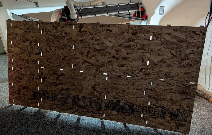

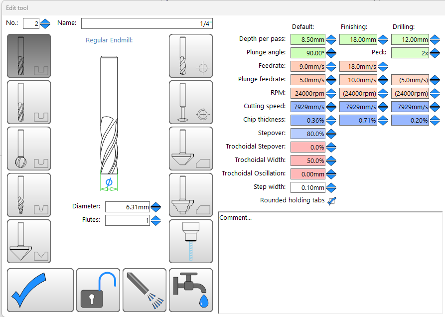

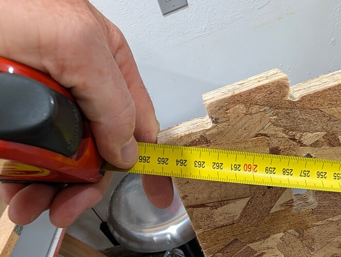

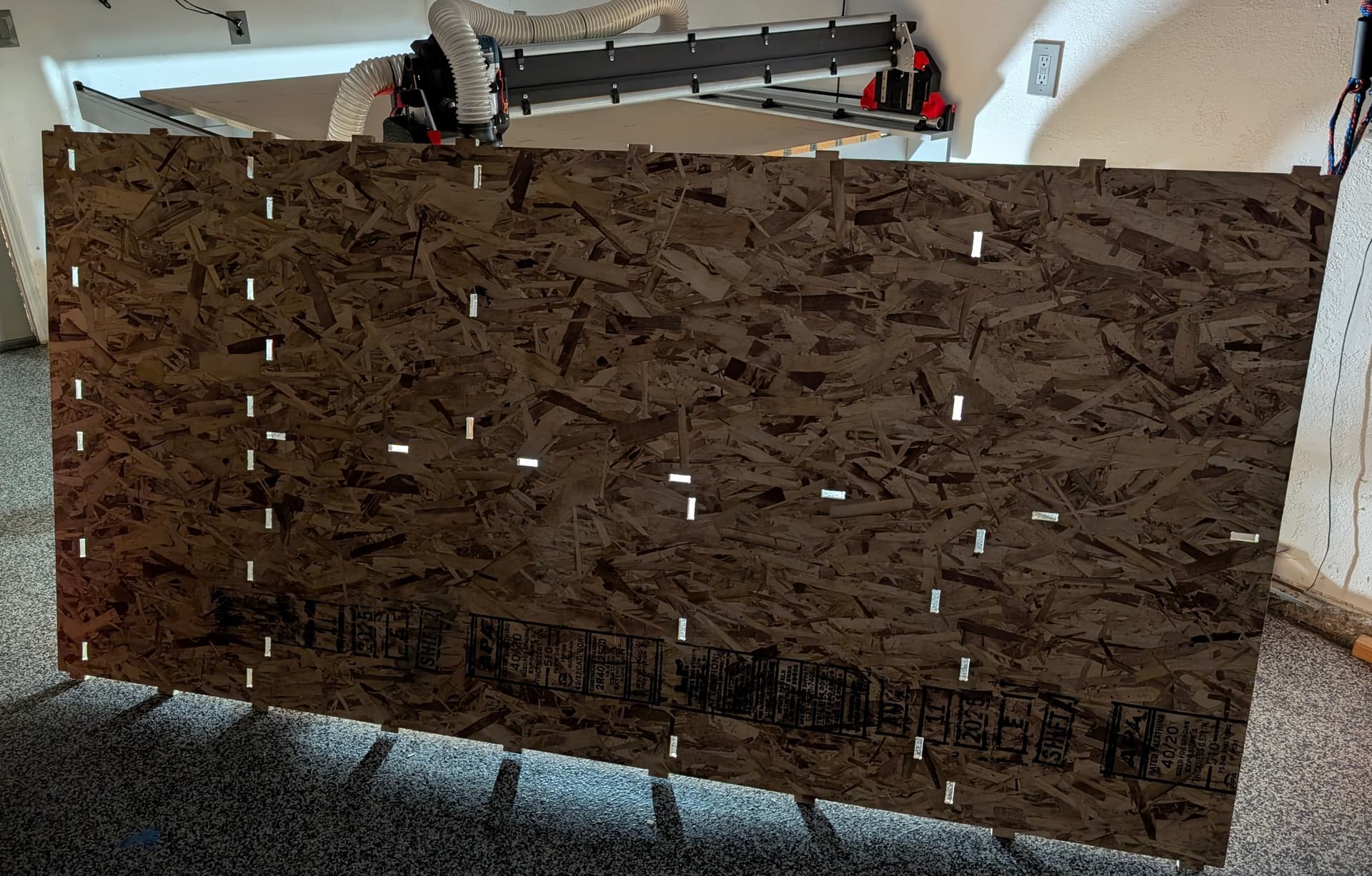

55 minutes, and I am not pushing it very hard. Router was at 1.5-2.5 on the dial. 1/4" single flute upcut.
Diagonals are far under what I can measure.
Working.
  • I am going to drop the plunge rate 1mm/s, increase the feedrate 2mm/s and finishing pass probably 5mm/s
Estlcam said 1:04, it was done in 55min. That is pretty accurate.
You used a 1/4? Never thought to see that day… :stuck_out_tongue:
I have a confession to make, too. One-flutes really work a lot better on the LR… You cannot achieve the speeds needed for a 2-flute. So you can just leave it be and use a 1-flute with better chip ejections…
I’m a bit confused on the speed issue, I’ve seen people in here use absolutely bonkers (to me at least) depth of cut, but lower DOC with a two flute is problematic?
Is that caused by the steppers losing torque at speed or is my understanding of the forces involved just off?
I’m just curious for the reasons, not trying tune a machine that isn’t even build yet.
Depth adds quite a lot more load than speed does, so I usually stick to my 4.5mm in hardwood and just tune the speed. But Ryan is going really slow, then it kind of works with his DOC. :slight_smile:
