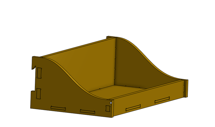

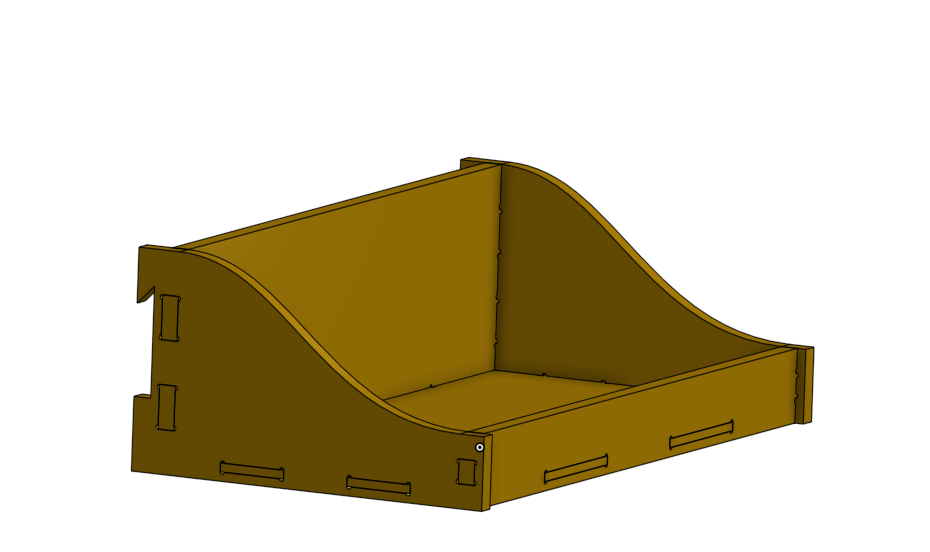

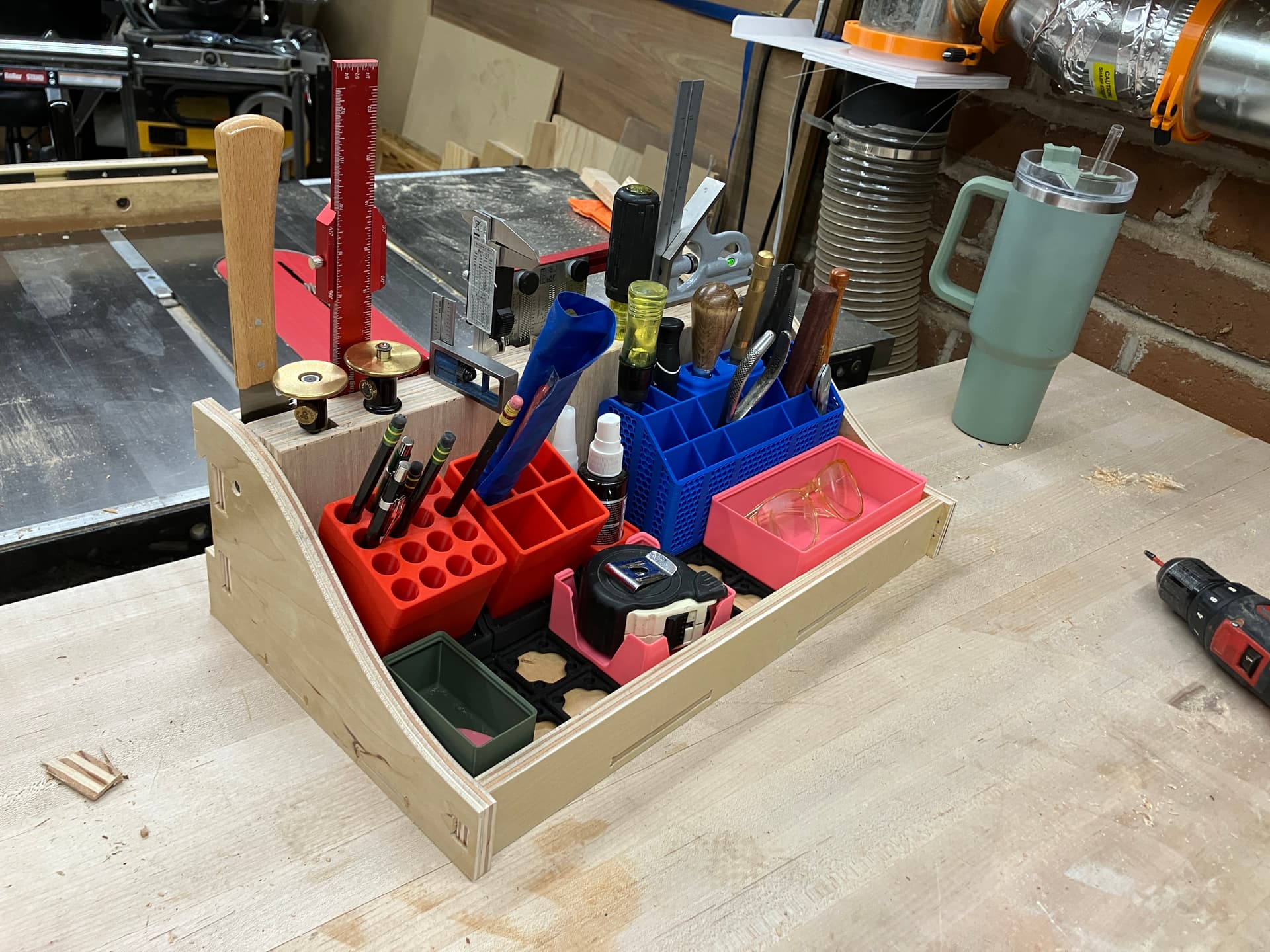

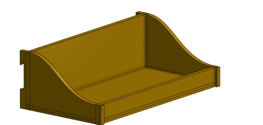

Here’s a quick project that’s been really useful. Just a little tray for keeping track of my most used tools that I can take with me to wherever in the shop I’m working.

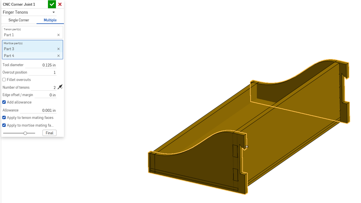

I used a very useful feature script in onshape to make it: cnc joint feature script. It makes designing any sort of box/cabinet etc super easy. Just create overlapping extrusions for your stock.
Select tenon and mortise pieces, type of joint, specify tolerances and dog bones for your bit.
and you’ve got a cnc ready design.

Nice work! What tolerance/allowance are you adding?
I used 0.001" as the tolerance and measured my plywood thickness with a caliper. It lead to a tight fit that didn’t need glue. I was using prefinished plywood so I was fine with that. I did drip some thin CA glue into the joints after though, not sure if that mattered. I’d probably increase the tolerance a fair amount if I was using PVA glue since, in my experience, that swells the wood pretty quickly and can easily make a joint too tight to assemble.
Likey likey!
0.0254mm tolerance 🫨! Are you assembling the parts with a 8lb hammer :slight_smile: , and/or is your LR that well calibrated?
