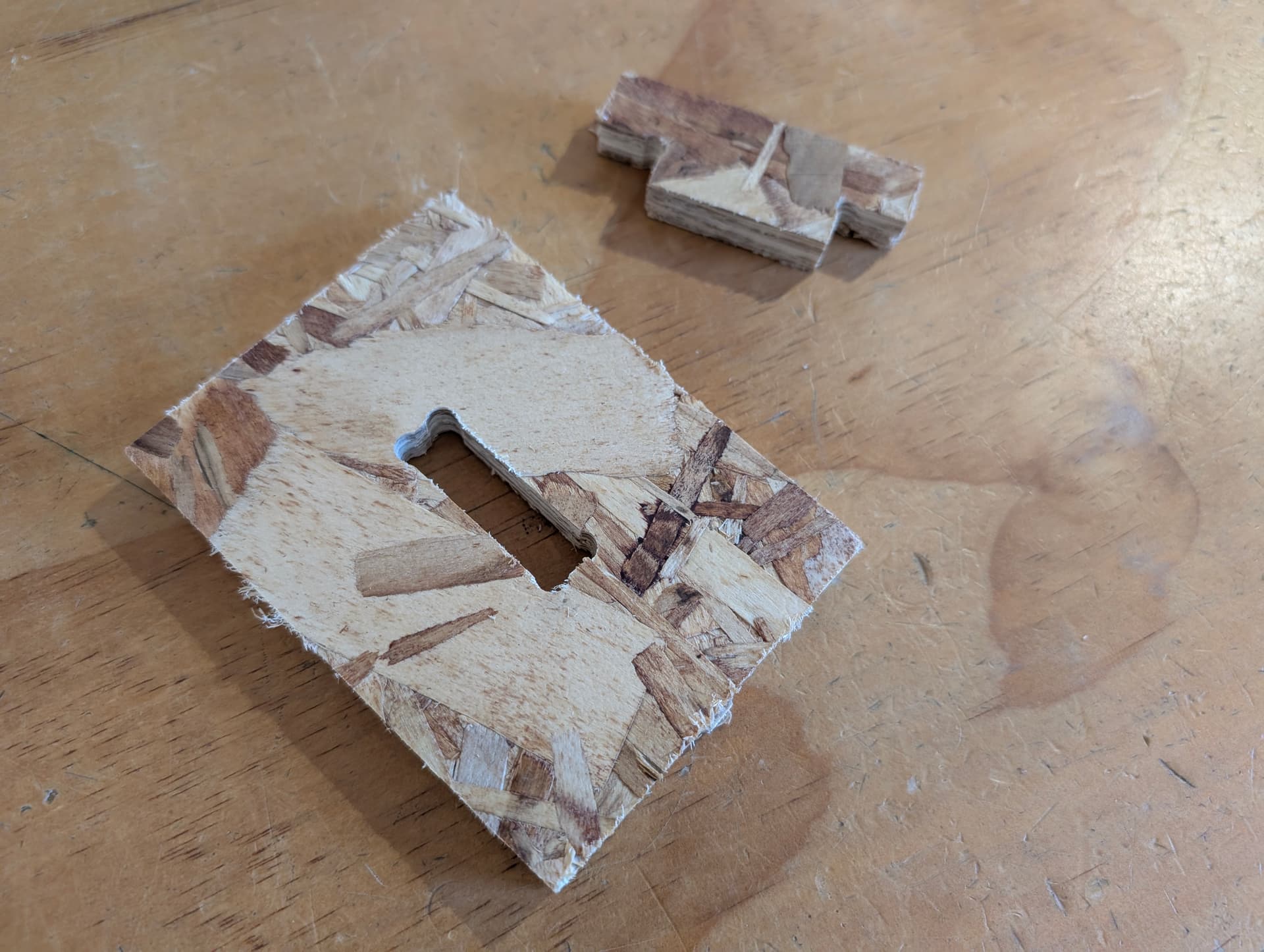

Test cuts. I will retest on Monday but 0.25mm tolerance feels sloppy. I will check the tool diameter and make a couple more test cuts. I wanna build something so bad!

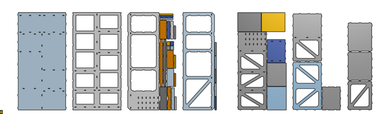

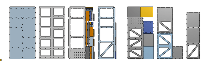

Auto sheet layout is pretty nice!
It gives a rough idea of how things fit, but does not have nesting and I can’t tell lit to skip or duplicate parts without building an assembly.
edit- probably fit this in 6 sheets maybe cut the shelves out of scrap. $120 for the table is not too bad.
edit 2 - I can just delete parts I do not want and duplicate others at the end of the feature tree to get a good idea, but nesting would be the killer feature. I will keep looking. Deepenest is amazing, just hoping there might be a built-in script.

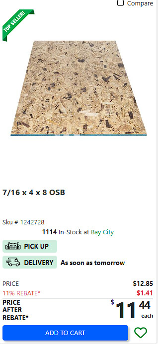

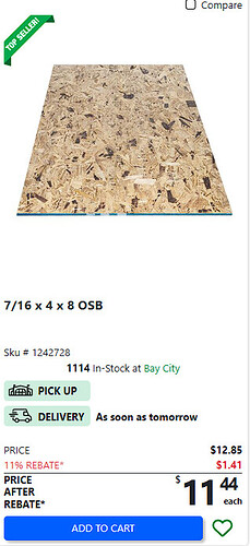

what are you using that is only 20 bucks a sheet?
OSB 7/16x4x8 is $18 a sheet
wow even cheaper here!
Wow I need to work more with OSB.
Ouch! $9.25 US here on the other side of the lake.
