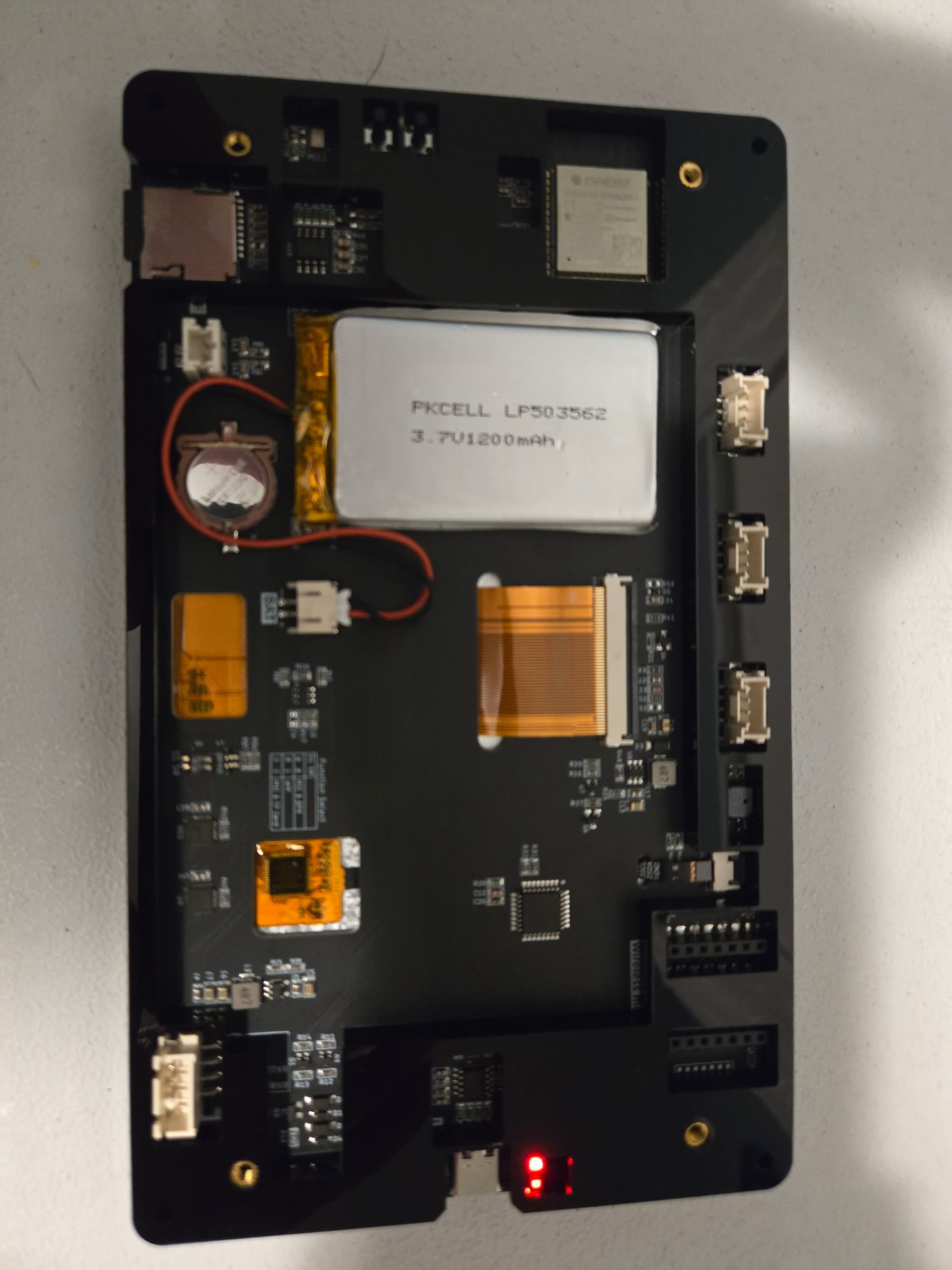

I’m currently using this battery:
Lithium Ion Polymer Battery - 3.7v 1200mAh : ID 258 : Adafruit Industries, Unique & fun DIY electronics and kits
And I’ve ordered one of these to try:
EEMB Lithium Polymer Battery 3.7V 1500mAh 524261 Lipo Rechargeable Battery Pack
NOTE: I believe both of these batteries are the wrong polarity, so you need to swap the wires in the JST connector.

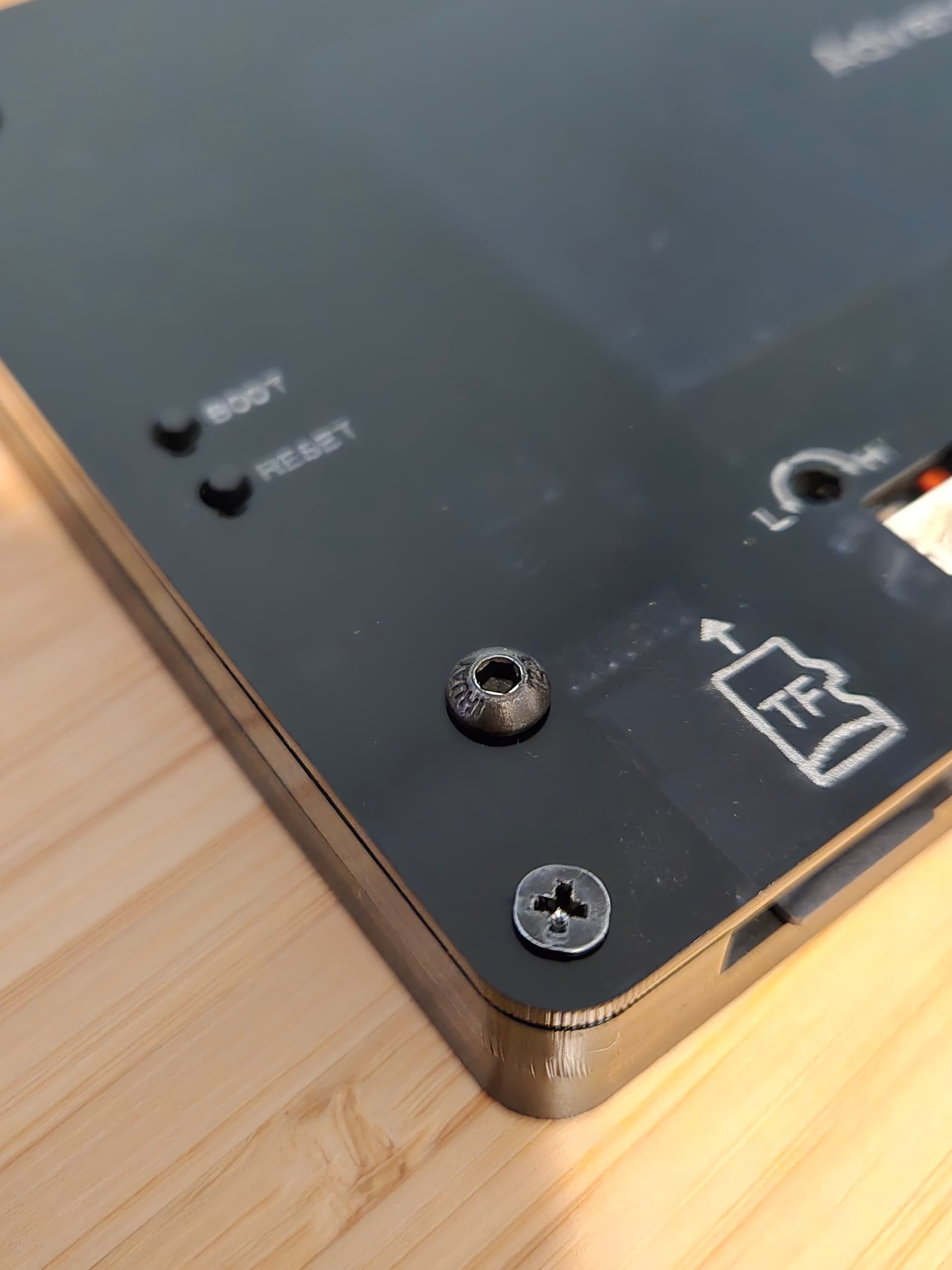

The only thing I don’t like is the buttons on the back prevent me from setting it down flat but I’ll come up with something for that.

Yea, I had the same problem. I just put M3x6 screws in the existing threaded inserts. Even a button head was enough.

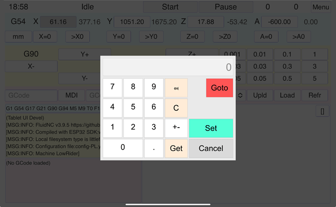

On the tablet tab:
If you click on the number for each axis you get a keypad like this
And s you can see you can enter a number and either goto that location or set the present location as that number. I use the goto feature a lot.
Ah, ok. I think that could work on the status tab so that clicking the value would allow for edit.
Yes, under Settings → Jog.

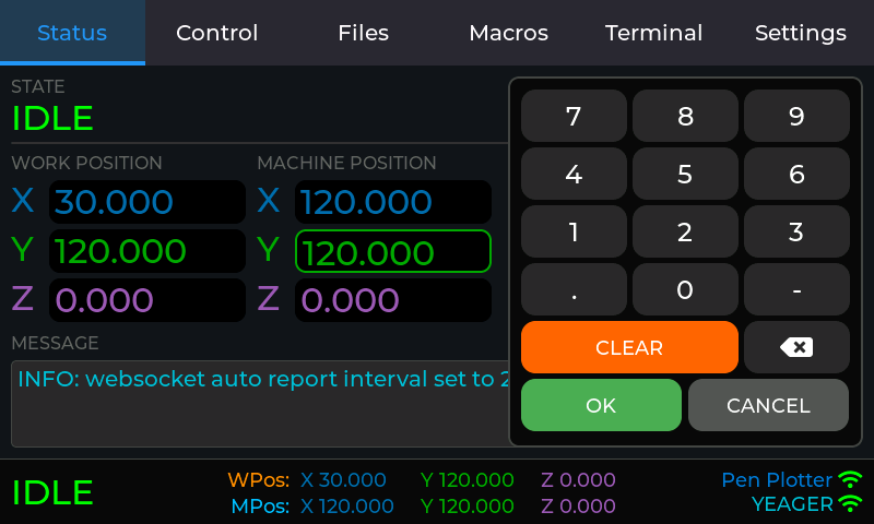

I was thinking maybe something like this:
Or, if we allow for goto, probably makes sense to allow for similar on the working coordinate system.

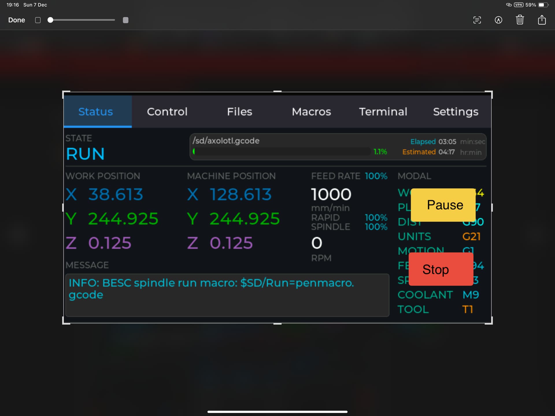

Yeah magic. I started a job earlier and realised I’d moved the start point but not zeroed it and there was a bit of a rush to get the the PC and pause it :grinning:
Well, this works too, but I can understand why it would be good to have on that main tab.

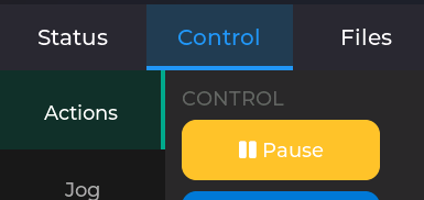

True. What about making the RUN state selectable - with a small [tap to pause] tooltip? Wouldn’t take up any real estate.
Yea, maybe. I guess I think a button is more obvious and requires less thought when you’re trying to act quickly.

The goto functionality generally works but needs some polish:
