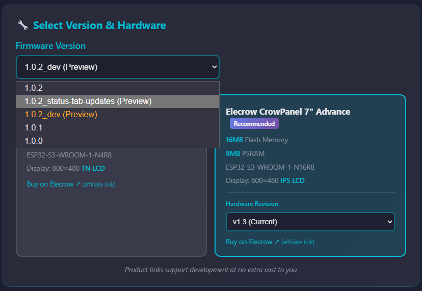

Found myself wanting the web installer to allow for multiple versions, including preview versions, while also planning support for additional hardware. Still a work in progress.
Elecrow says it can’t be detected programmatically. Even though I said I didn’t want to, I think I’m going to make a third build version to include this for which the web installer update is shown above. Then I might draw a line in the sand on older hardware versions. I’m not really a fan of implementing something for hardware I don’t have.

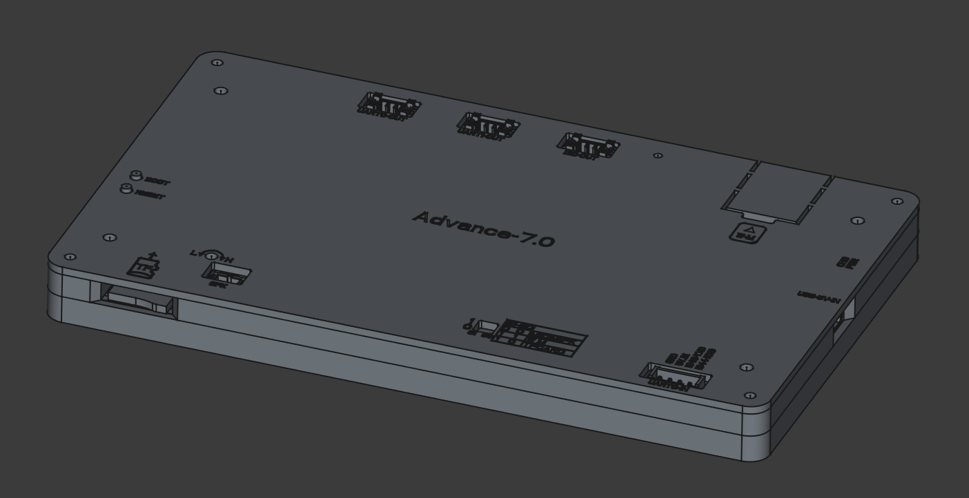

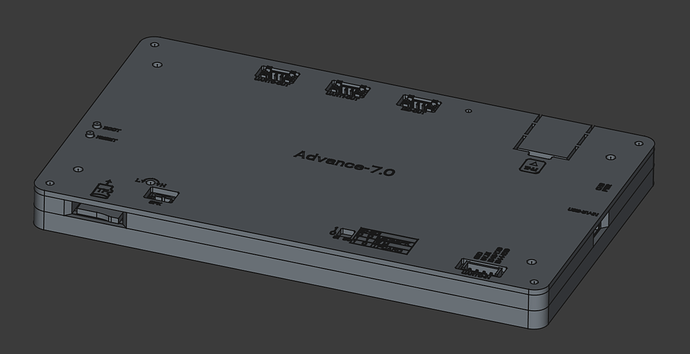

Ooh, I just found that they have a step file for the advance anyway including the case. That case is in 3 layers. Could be convenient to make one or more custom layers such as a thicker middle layer to allow for a bigger battery or the back layer to hide unused ports.
CrowPanel-Advance-7-HMI-ESP32-S3-AI-Powered-IPS-Touch-Screen-800x480/3D file at master · Elecrow-RD/CrowPanel-Advance-7-HMI-ESP32-S3-AI-Powered-IPS-Touch-Screen-800x480

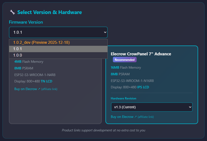

The web installer is under construction at the moment and not working correctly. I’m adding multiple version (and preview build) support so I can have people try fixes before they become part of a normal release. It will be fixed soon.
Ok, now I’m all set to fix things and allow people to try things before a full release. That was a project but I think it will be well worthwhile.
Defaults to latest stable (1.0.1 currently) and allows me to specify which versions work with which hardware.
