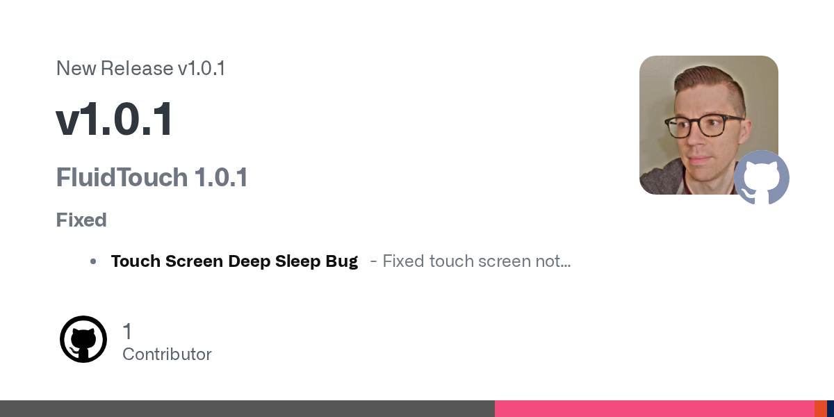

Hmm, which version of the display do you have? I see that on the standard display, once it turns off, the touch functionality doesn’t work when using the reset button. I can see the screen but touch doesn’t work. The advance screen works fine. I’ll look into this.

I have a fix for this but will do some more testing before releasing. It’s in the dev branch. I got a little over aggressive with trying to save power in deep sleep.

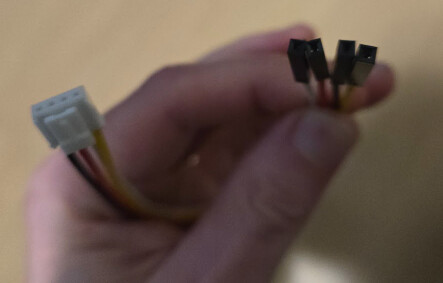

This seems to be possible with the Advance display but not the Basic. At least if the Jackpot can provide enough 5v power. It turns out the cable I though I could use wasn’t right. The UART0 on the Advance display is a 2.54mm JST-XH. Fortunately from other projects I have a connector kit for those. The Basic display is 3.3v for the UART connection so it would need to be powered separately either via USB or the battery connection. Or possibly USB to USB although USB-C to micro is a weird cable that I don’t have in my collection. I suppose I have a USB OTG adapter that might help.
I ordered some of these for experimentation with making an adapter cable.

I did just put out an updated release.
While I didn’t experience this exactly, I believe it should be resolved. I was getting a bit over aggressive on the power saving (for no actual gain) and the touch screen on the basic display did not like it.
