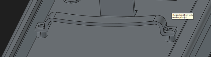

I have adapted the backpanel including spacer +6 mm to fit quite big battery.
Here is the file for bambulab, printable in 2 colors.
All unused holes have been removed.
The same screws from originally delivered plexi cover can be reused (hard to find same 2.5mm x 14mm)
CrowPanel-Advance-7-HMI cover v1.zip (560.5 KB)

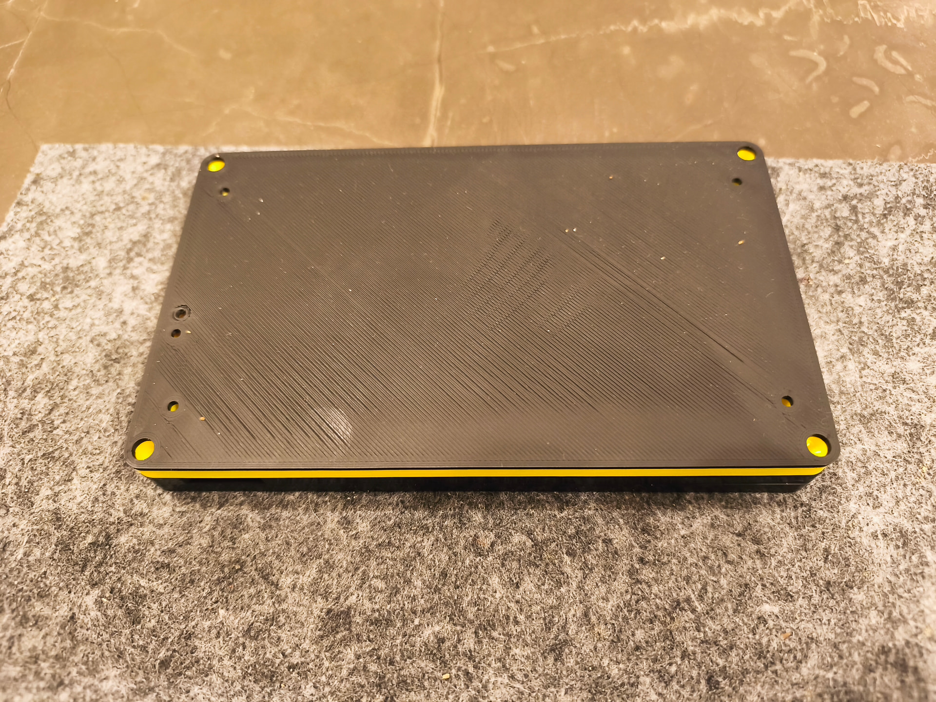

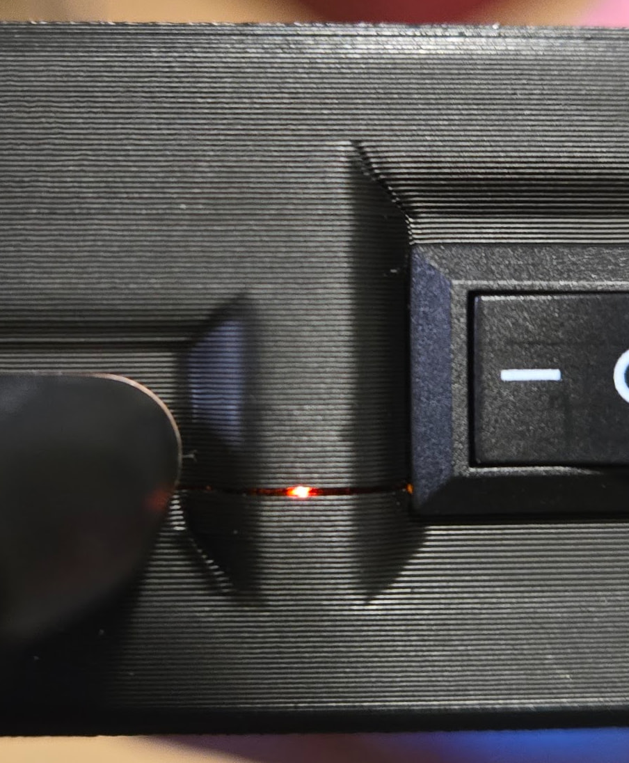

More progress on the case. Little details make me happy.

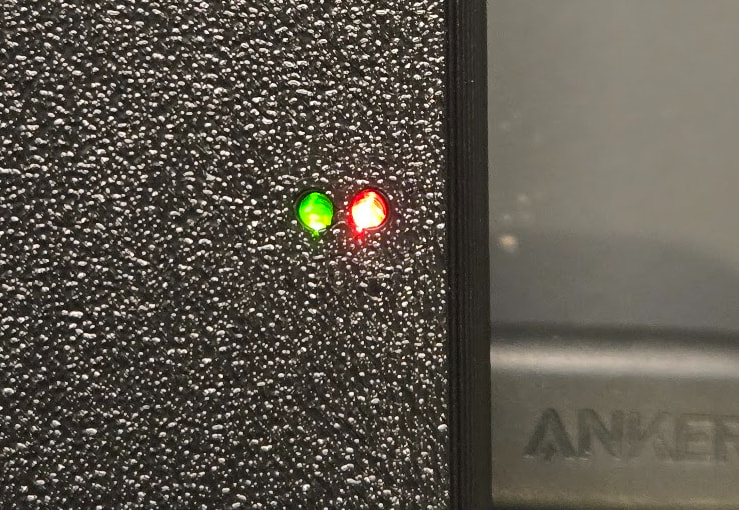

Showing the separate power/charge LEDs works great.
The hole for the switch is slightly too small so there’s a slight gap between the top and bottom. But, I noticed with that gap you can see the charge LED. Seeing that on the side would be nice so I’ll add a little hole there when I make the switch hole bigger.

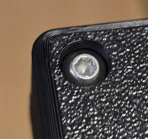

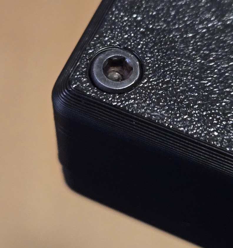

It uses 20mm M3 screws to connect the case halves. I was trying to use a normal length. If it’s a socket head, it’s flush:
Button head sits in a bit.

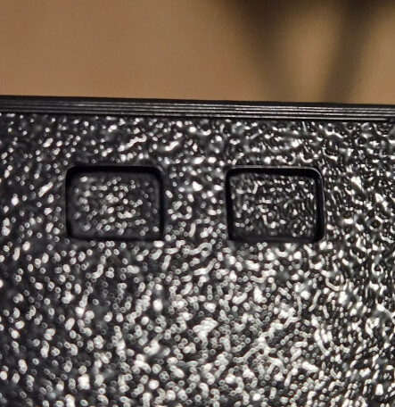

The boot/reset buttons are inset slightly. Easy to push but hard to accidentally push.

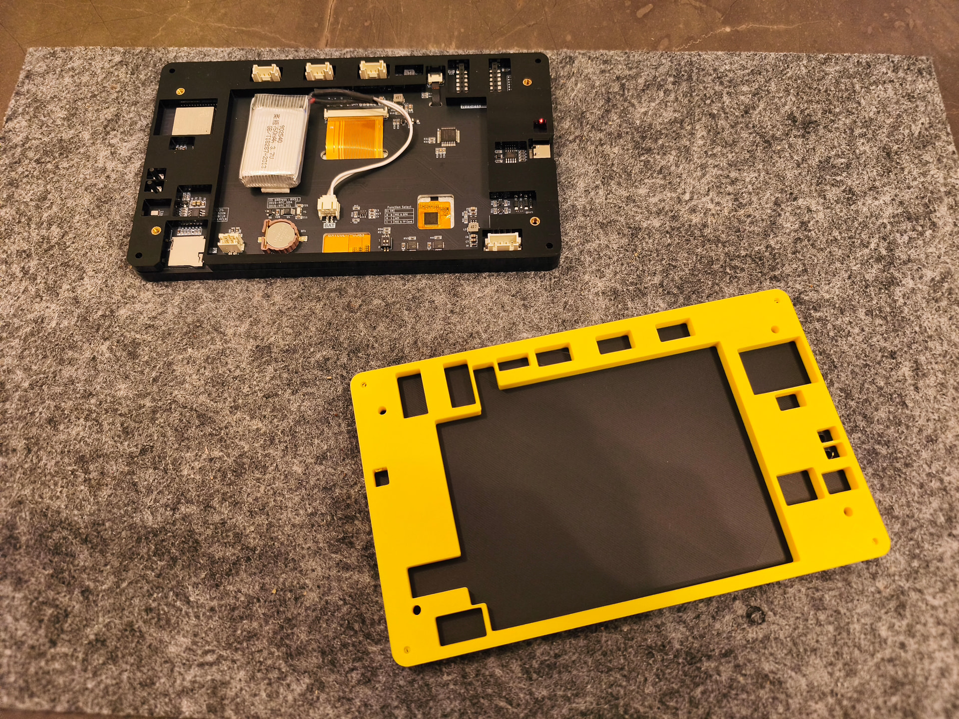

For holding the battery, this works fine in the one location, but not the other because the buzzer on the PCB is in the way. It has a bit of a curve which gives a nice amount of pressure. Trying to work around components on the board so I don’t need to make the case any thicker. It’s currently 28mm. I have a plan.
