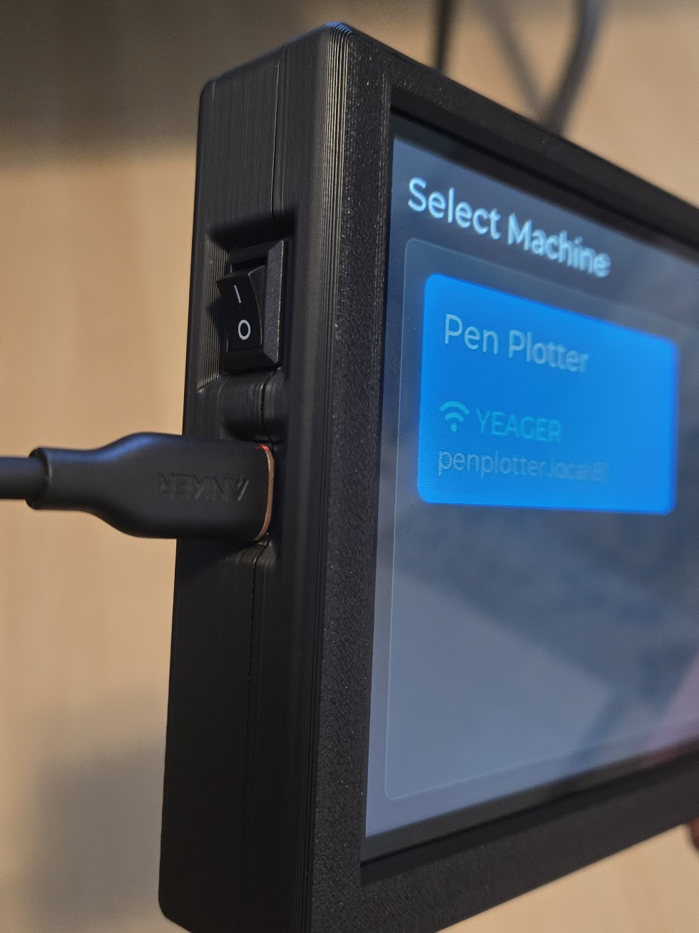

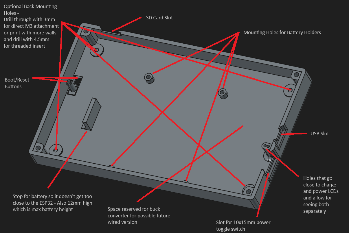

Yep, that one is linked above somewhere. That will work fine. My case doesn’t have a part for the antenna, uses a rocker switch, and I’m attempting to have the power/charge led lights visible. It also gives me some flexibility in the future to make a version for a wired connection. I also like more basic looking things.
I have the bottom part of my case printing now.

I’m getting close on the case but still iterating.
Man that’s looking good. I just ordered the screen today I was going to print the linked case above, but I’ll wait for you to release this one instead!

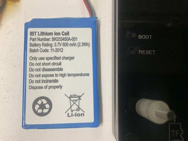

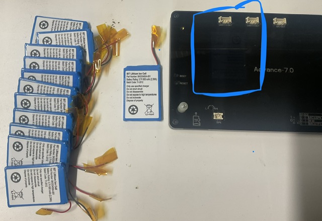

I have a few batteries that fit into the elecrow case, I wonder if I should stick them up for sale somewhere.
Mmm, on second thoughts… shipping issues, liability mmmm, maybe not.
I feel thats a on/off switch my fingers are going to activate randomly. Loool
Yea, I’ll have to see how that plays out. I intentionally recessed it a bit to help with that. I put it in that location because it’s right next to the power/charge LEDs on the back. The rocker switch is a bit stiff so I think it will be ok.

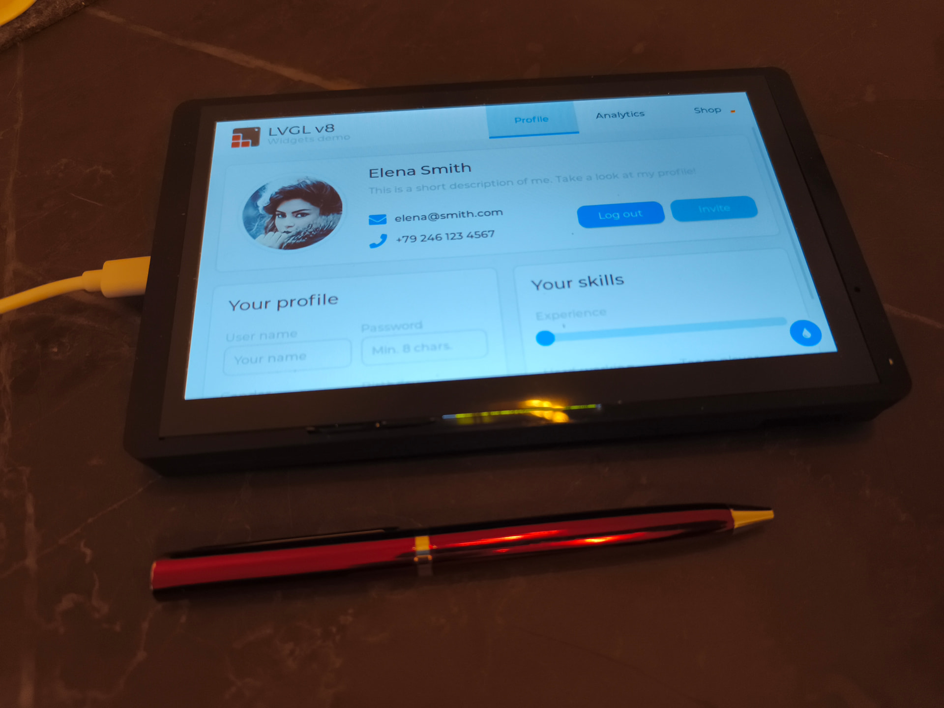

finaly got my device..installed the batery.
the original case is very nice lasercutted plexi.
the only need to fit the battery is to 3d print middle layer of approx 4-5mm. it is easy
going to install fluidnc asap
I am running device now, also had very bad flickering. occasionally, thought it is because of insufficient power. When i updated Brightness from 100% to 75% flickering disappeared completely.
Try the 1.0.3_dev version. That should resolve the flickering issues even at 100% brightness.
I’ll probably do an official release of that in the next week or so once I do some documentation updates.
A low battery could certainly cause issues as well. The brightness has a significant effect on power usage.
Yep, that can work too.

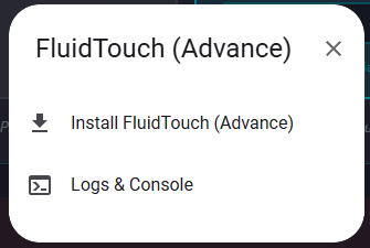

You don’t need any of those addon modules. It has built in wifi. If it got to that point, it connected to the wifi network but failed to connect to the machine.
Given that you are connecting to 192.168.0.1, that tells me you are connecting in AP mode. That should work, but I use STA mode.
A couple options:
  1. Try the 1.0.3_dev build. I changed the websocket library which is what is used to connect to FluidNC.
  2. Connect via USB in the web installer.
    When you go to install it, select Logs & Console. Reset the device and show the output when it tries to connect.
