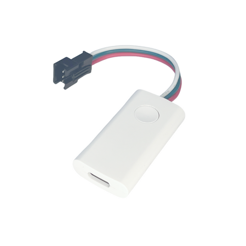

Can you flash firmware via USB with that?
I’m sure it works fine but the WLED discord seems not fond of that brand but like you said with a small number of LEDs, it probably doesn’t matter.
I was also looking at this similar one which can be flashed via USB.

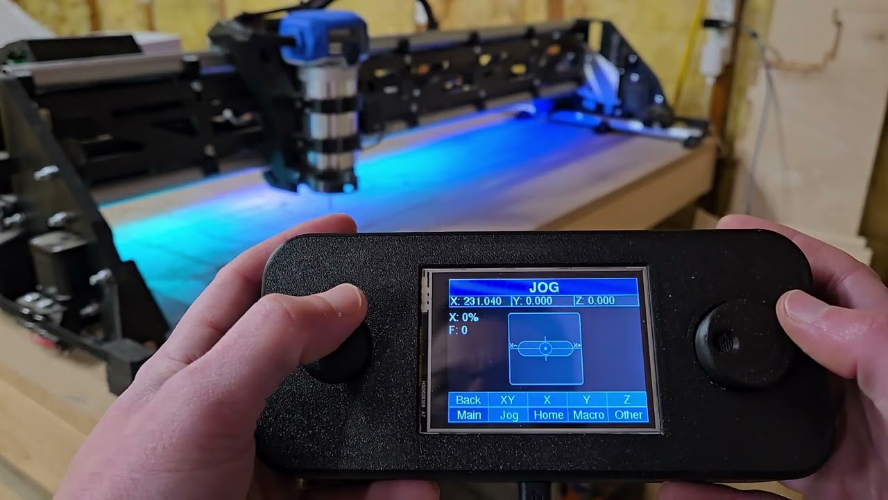

We might be getting enough snow tomorrow where I would need/want my snowblower. So, that was motivation to finish getting that ready. This means I had my propane heater going in my garage which meant it was warm enough for me to play with LEDs some more.
It’s a little hard to see but it tracks the position fairly well. It’s a bit off at high feedrates. Not sure if I want to play with the reporting rate or offset based on feedrate. I do plan on changing the config for the position width to be number of LEDs instead of mm.
That’s about as far as I plan on going with this for now. At least until I talk my wife into letting me make that wall mounted pen plotter and put it in the house. That’s a work in progress.

So if you jog in Y it still happens right, the light just stays in one place? I am making super slow progress on my full sheeter, that thing is going to need some lights for sure. I can’t wait to try this.
Yep, it’s only looking at the X position.
