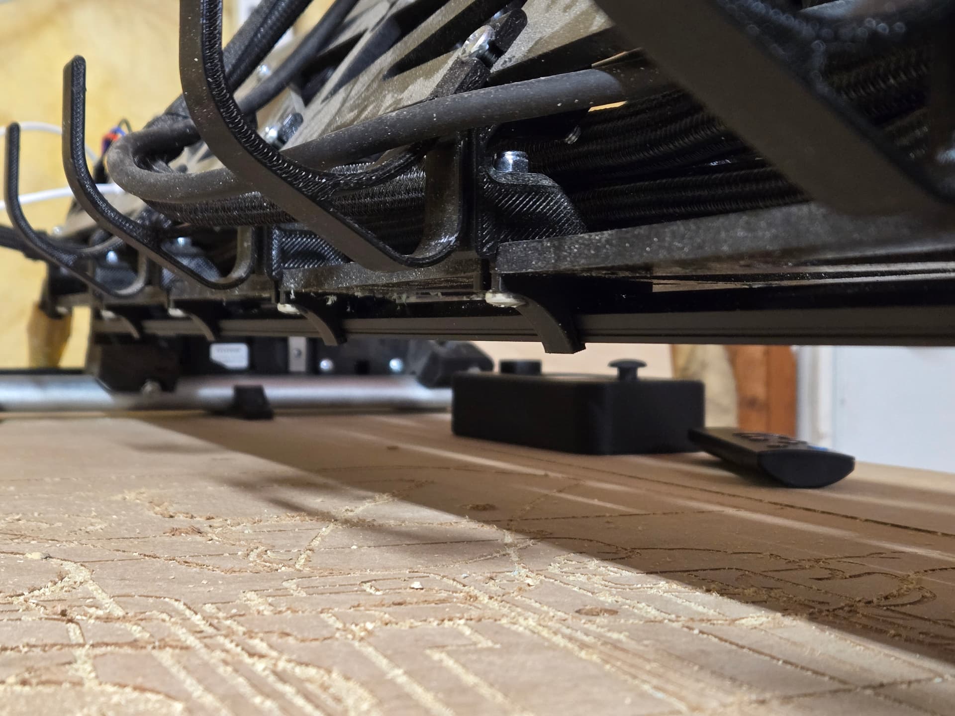

Got some channel and attached a strip. I designed and printed some clips to hold the channel. These will let me attach the strip using the existing screws on the bottom strut plate of my LR3. Since I’m attaching to the back screws, I made the clips have a bit of a forward angle. The controller I ordered will be here in a couple days and then I’ll get it hooked up.

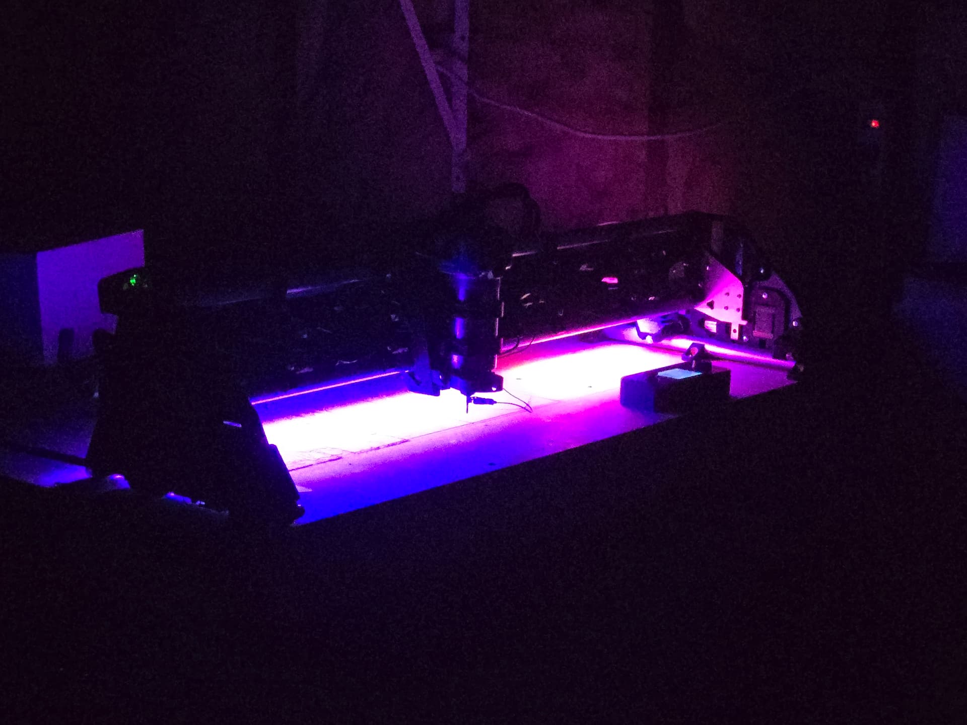

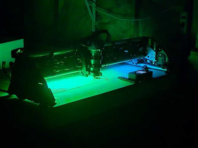

Got the controller today. After an audio reactive 5 meter strip layed across the top of the couch LED dance party with my 7 year old, I mounted the strip and flashed the firmware. I’ll deal with more permanent wiring later.
Need to play with inverting the position due to connecting it on the rail side but so far so good.
The best part!!!
:man_dancing: :dancer:
Looks like that angle paid off, it pushes the light forward quite a bit.
Yes that was my experience as well. :+1:
Looking good.
This is supercool and it keeps getting better and better!
