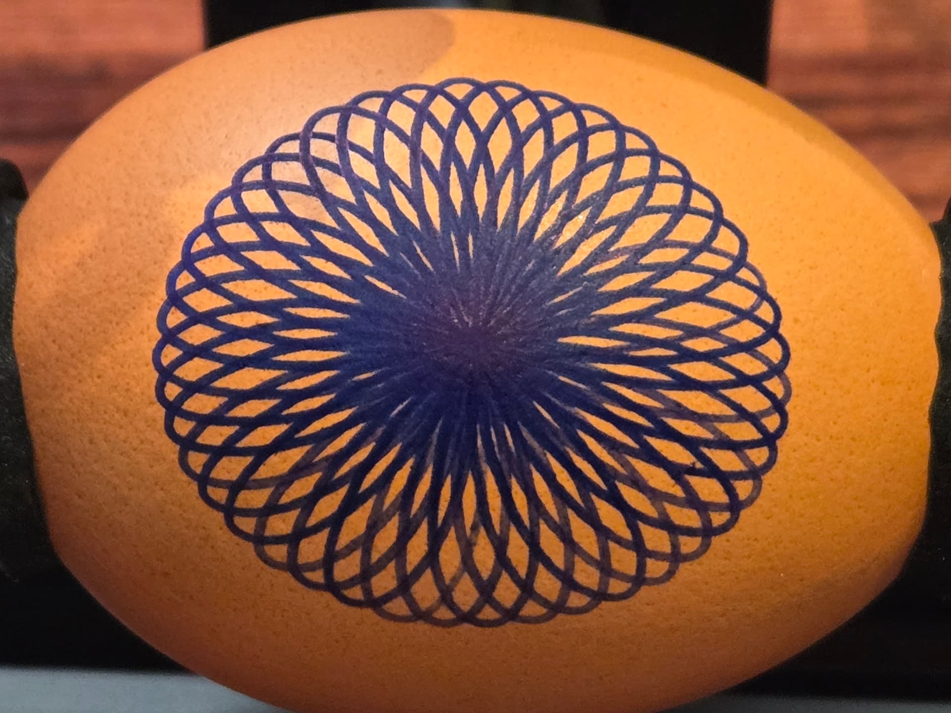

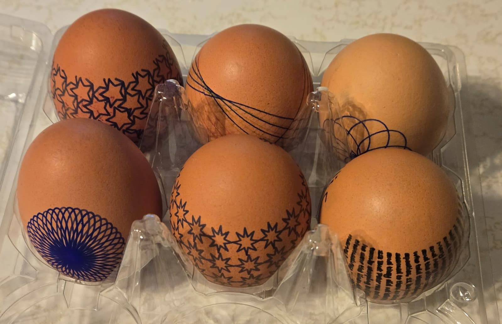

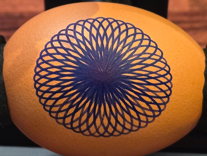

This is a Sandify pattern with a loop. It’s a bit too dense in the middle but the alignment is pretty good. I also did it with 3 colors but lost some alignment during the pen changes.
I need to eat more eggs so we buy more eggs so I have more eggs to draw on.
You need to get you some chickens :chicken: then you will have your own personal egg factory :rofl:

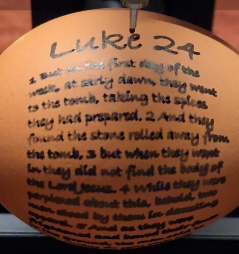

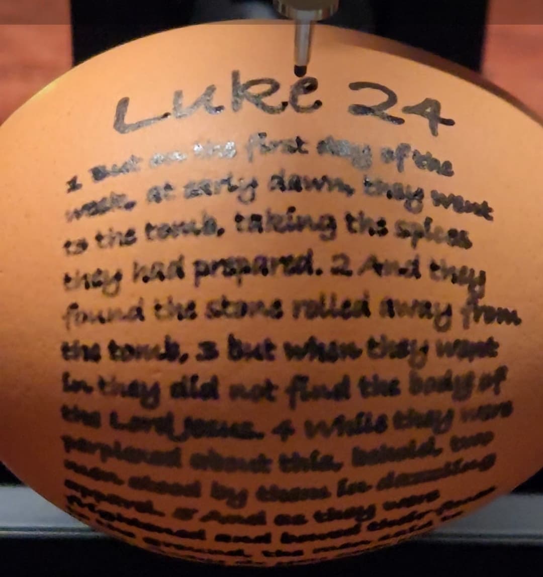

Very nice Jason. What verse is on the lower right egg?
Have you tried a cross design yet?
Luke 24. I think 1-13.
No. I was looking at some SVGs but didn’t land on anything. This weekend we’re dyeing and drawing on eggs with my daughter. So, still figuring out what that will be.
It’s amazing you can get that much text on an egg.
Yea, I was testing the limits. Mostly readable.

so how does it know the curve of the egg? Are all eggs curved the same?
I thought the “wonky” letters was because you were putting a flat item on a curved egg, but you proved that wrong!
