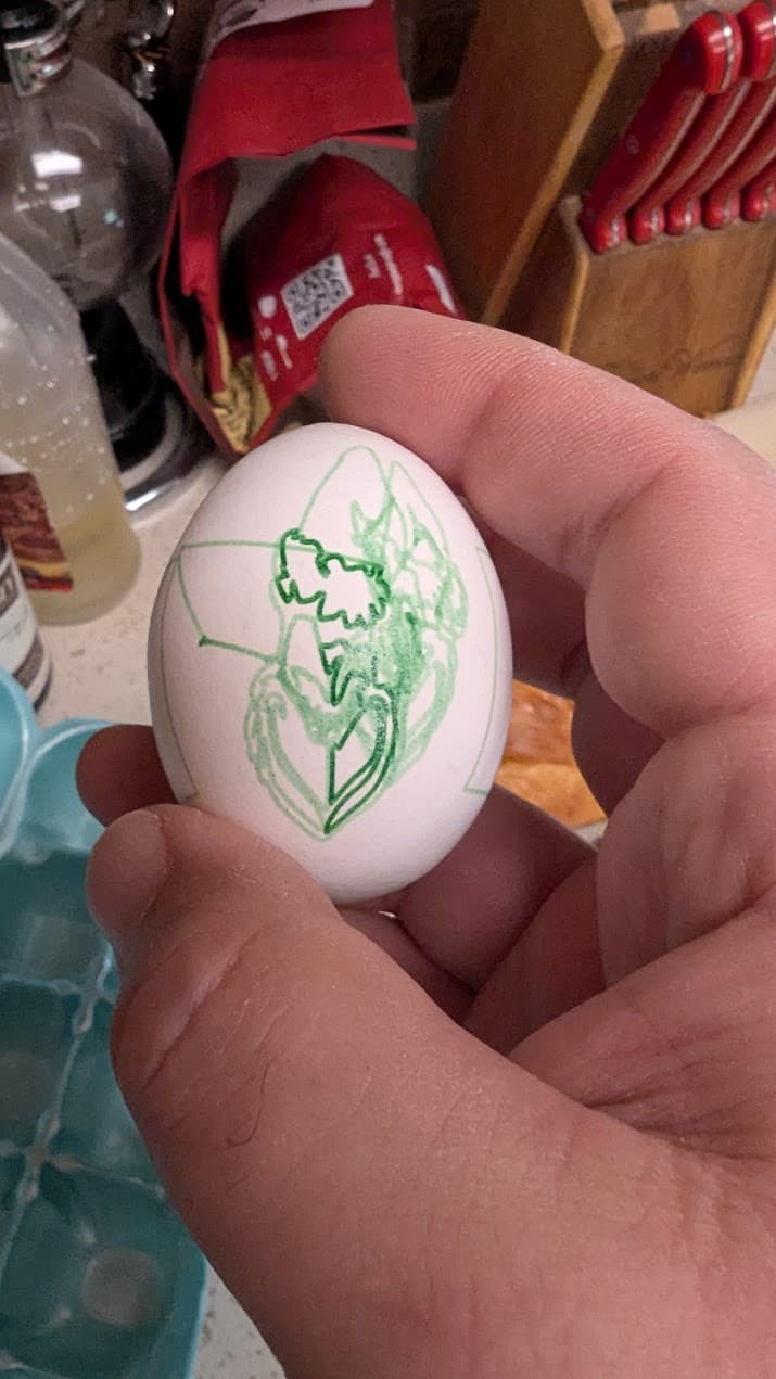

Well, haven’t been home much and won’t be home much tomorrow either. Tried to draw on some eggs we dyed, and it went poorly. I was rushed and condensation was an issue. Then when I wiped the eggs off, quite a bit of dye came off too. Not sure what was used for dye but it didn’t seem to work well.

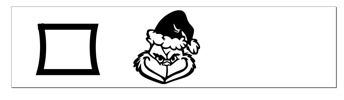

Well, everything moves…just…not quite how I’d like it to yet :rofl:
The warping is “normal” that’s what’s nice about the eggbot tools in inkscape - they make distorting things so they draw correctly on an egg easy.
I tried it going the other direction and it didn’t do much better:
Just distorted the other way.
Also you’ll notice I centered the design on 0,0 in estlcam…I’m used to starting the eggbot with the pen centered over the center of the egg and this seemed like the best way to keep that workflow.
The bigger issue is Z. I’m still wrapping my head around it. At first it wasn’t doing anything…so I reversed the directions and then it was working…but…opposite of how it should. So I just manually hacked the Z moves in the code to invert them…then it turns out the servo is lifting so quick it threw the pen backwards and off the servo arm. But slowing the servo down and the moves weren’t waiting for it - the X/Y would start moving before the pen had moved it looked like.
So…I’ve got some experimenting to do with Z still big time.
You know…after I posted that last night I thought about it some more…
That level of warping did NOT look normal as I thought about it. So I fired up inkscape and used the eggbot extensions warping tool to warp the design. The difference was subtle. So I also added a square and warped it to make sure the warping was working:
It was…but like I said…it’s subtle.

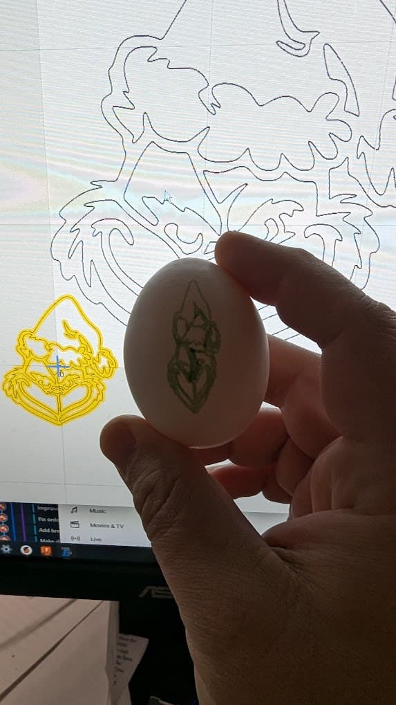

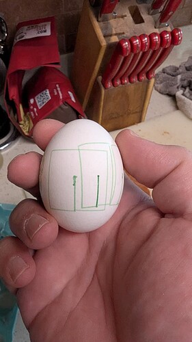

So I plotted this on the egg.
The grinch was a hot mess…on the upside somehow I wound up with multiple passes and they all lined up perfectly making for some nice dark lines. But the Z was still not working right at all and things were even more scrunched up looking…then it go to the square…
And I got a nice TALL SKINNY rectangle.
Yeah…something is NOT right.
So I doubled the steps per mm on X And re-ran it…boom…now I’ve got a square. A nice square with straight edges despite the original looking curved since it now matched the surface of the egg. Sweet!

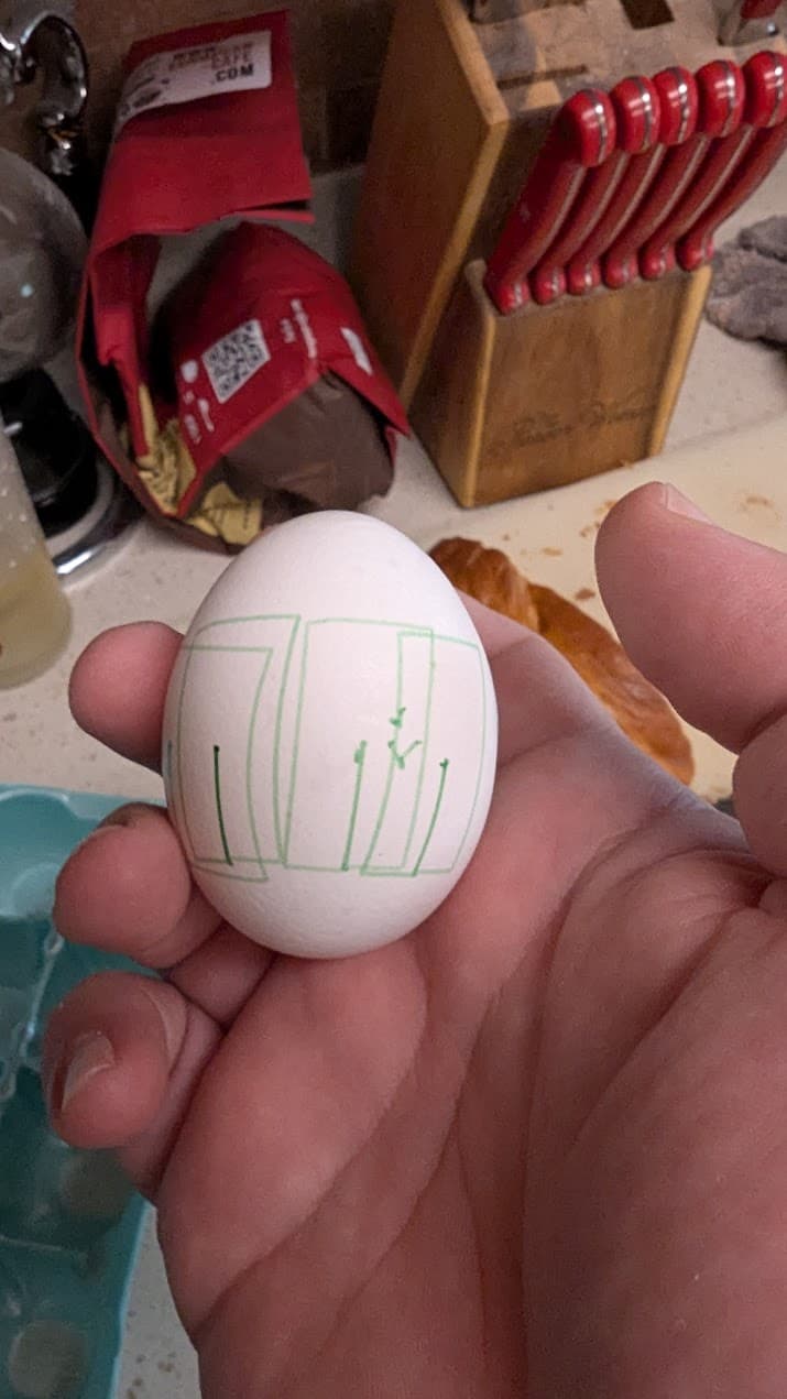

Here’s the “fixed” square with my x steps doubled:
And a few tries before finding that setting:

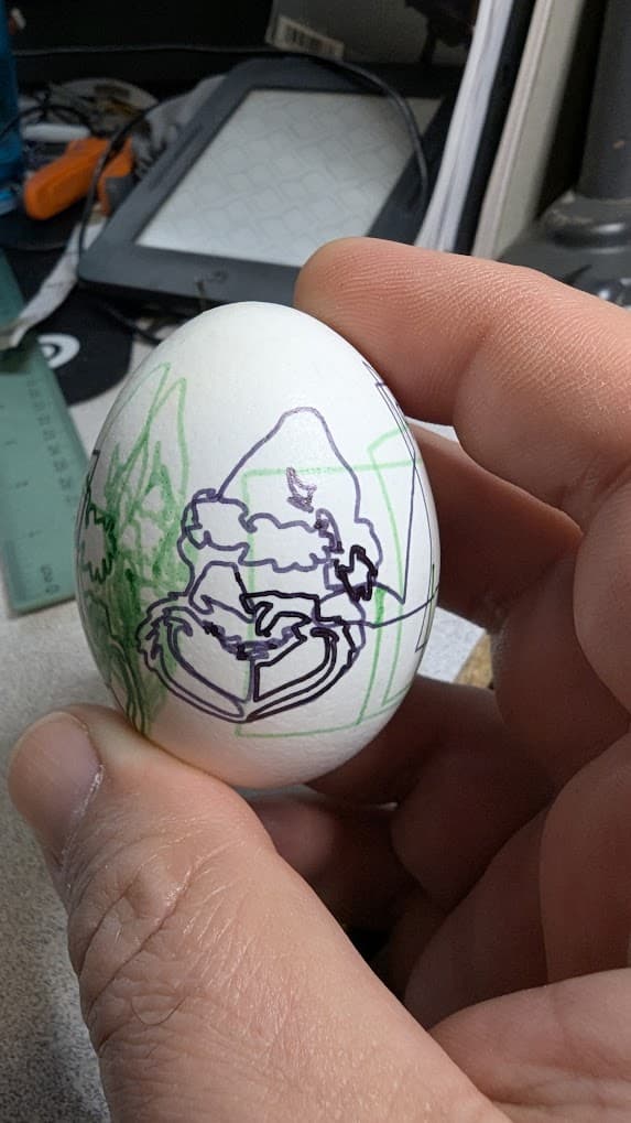

Well, I’m not exactly well rested…but still took a look at it and figured things out.
First - I didn’t realize that “save” on the config screen in webui3 didn’t save to the actual config.yaml…so my servo reversing was lost when I reset the board. Opened the config.yaml manually and reversed the servo settings and doubled the X steps.
Then took a look at the square z-code and realized I was telling estlcam to go to 5mm on z no 0 for the “engraving” So manually edited the code to swap those to 0’s and…I got a nice square!

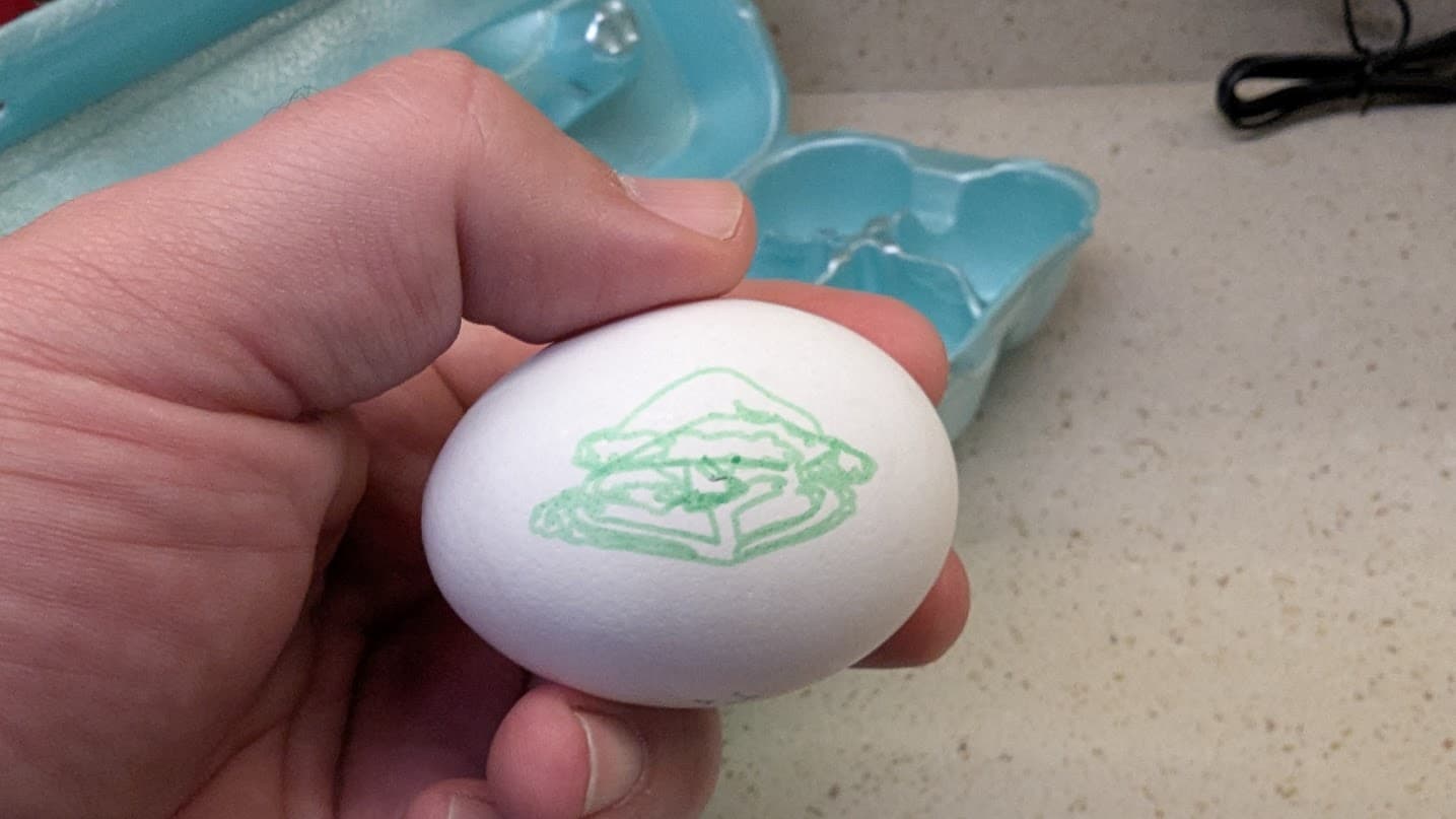

Great…let’s try it with my grinch:
Something got messed up going from inkscape to estlcam that caused most of the paths on the right side to get duplicated several times apparently…so they’re darker from being traced repeatedly…but it worked and no more pen drag.

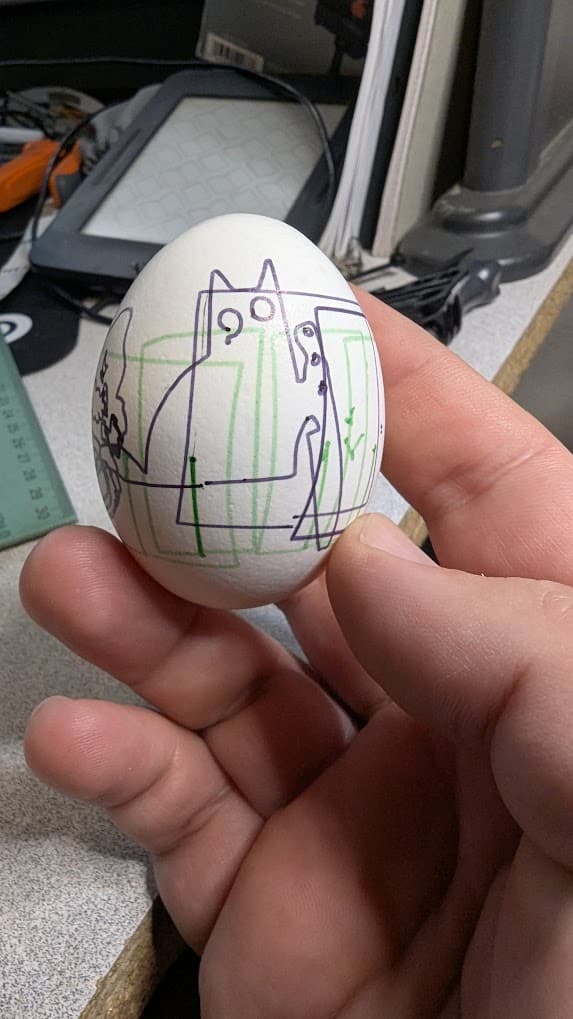

Then pull out our friend murder kitty and that worked too:
Well…mostly worked…the pen got caught on one eye.

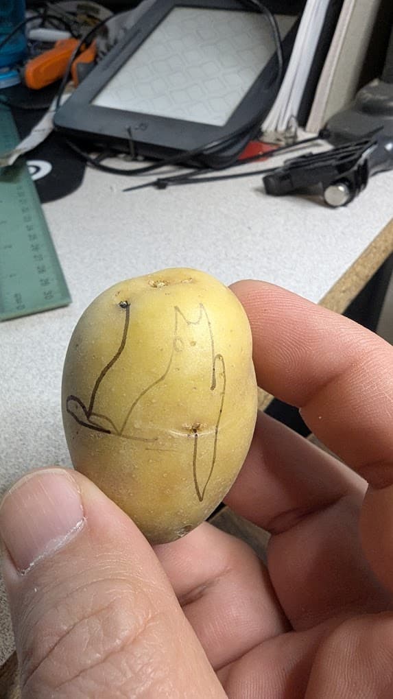

Oh look…baby potatoes!
Apparently there’s more reasons than just them being fertility symbols that made people choose eggs as the foot item to decorate. The pen gets caught in the eyes and the skin of the potato gums up the sharpie really fast :frowning:
