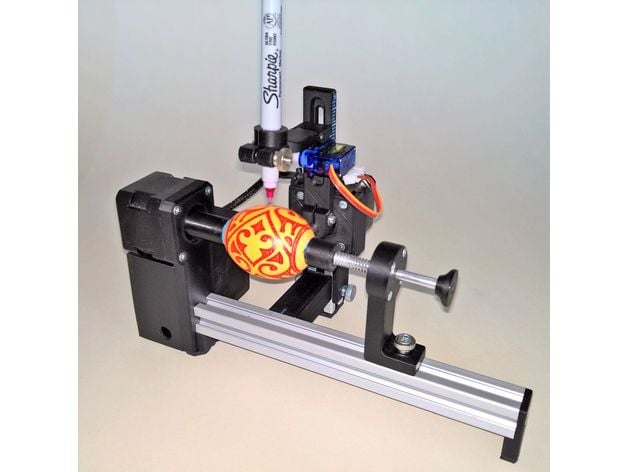

Currently, looking at some remixes based on this:
https://www.thingiverse.com/thing:3431363/files

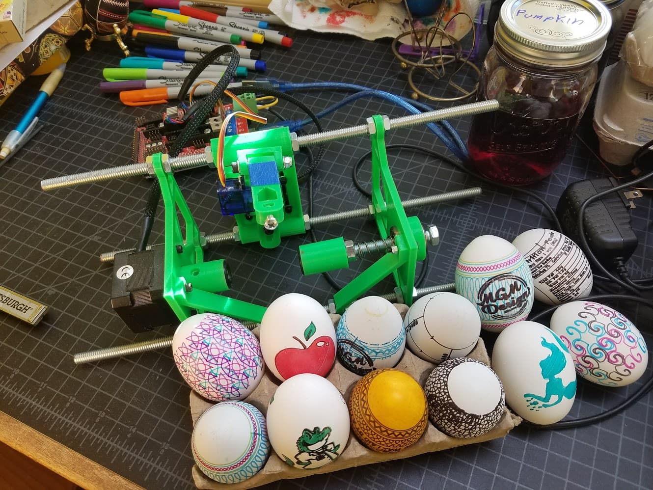

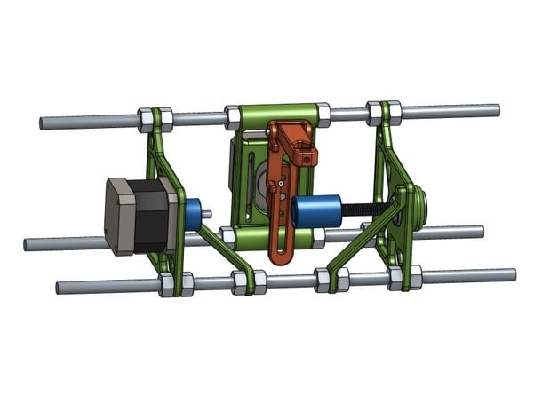

I’ve built two in the past I used GitHub - cocktailyogi/EggDuino: Arduino Firmware for Spherebot / Eggbot integration in Inkscape with a ramps board I had laying around and this physical design:
But redrew it in onShape to make a few small changes:

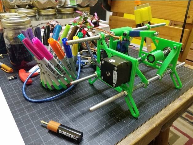

And then added some legs to it which really made it a lot nicer to use:

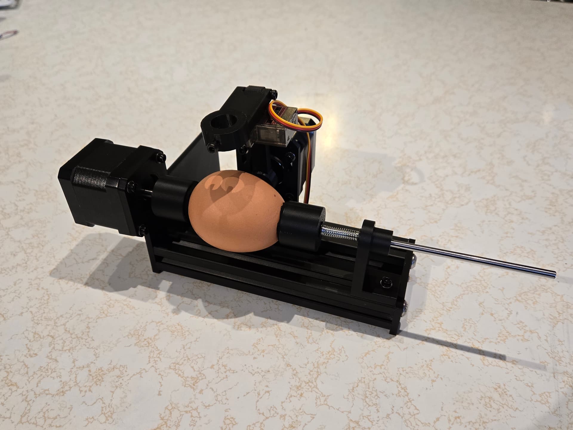

Then I built this one since I had an uno and the steppers laying around and liked how clean and integrated it was:
But…that one isn’t very reliable at all as the steppers are just barely strong enough.
The nice thing about using eggduino is that you can still use the “official” eggbot inkscape extensions which are pretty nice for prepping artwork for an eggbot. i.e. there are nice tools for warping things to help account for the shape of the egg and some nice easy to use utilities for fills and crosshatches and such.
However - the inkscape extensions got updated a few years ago and they changed the board detection routines and I’ve yet to get them working with my eggduino board since. Either by tweaking the eggduino code to make it present itself as an official eggbot board or by hacking the .py scripts in the eggbox extentions to accept the eggbot.

One more thought - the one you linked to looks ok…but that was one of the other issues I had with the more integrated “cleaner” design I made.
Adjustability is pretty important. Eggs are - very organic and not very consistent :smiley:
The “big” one I made is nice because it’s very adjustable and is mostly made from a few bits of all thread (which I had on hand) and a handful of simple prints. It’s really quick to print and I was able to build it in an afternoon with parts I already had on hand. And it fits all kinds of eggs/spheres/cylinders.
So it can also do Christmas ornaments, balls, and other objects.

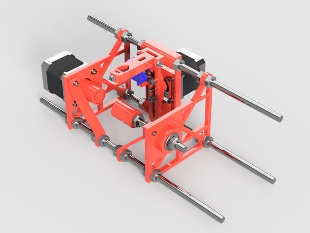

Did you see this?
No, I missed that one. That looks like it will work with some minor modifications. Thanks!

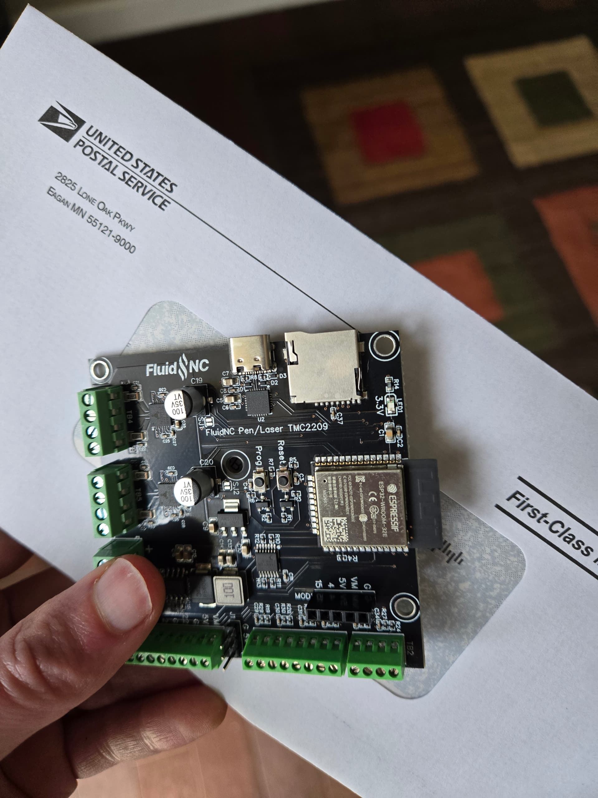

Well, if anyone wants one of those FluidNC boards, you’ll need to get it through Elecrow. It’s out of stock on Tindie.
Bart announced today on Discord that due to the crazy tariff situation, he’s closing down his Tindie store once he sells his current stock.
Hopefully mine ships soon. The first one was eaten by the USPS.

I’m just going to make that one that @Dreyfus posted work. I’ve done some sketchy things and some not so sketchy things to make it work with what I have but I’m well on my way. My favorite sketchy thing is a hole was too big because I’m using M3 screws instead of M5. So, I put in an M3 heatset insert and drilled out the threads.

The parts that hold the egg didn’t fit well and weren’t big enough to hold the egg securely. I redesigned the mount to use an LM4UU bearing and 4mm rod I had leftover. I had a box of springs with one that works. The board should be here on Wednesday.
Cool the board showed up early, along with the check for the misadventure of the last one.

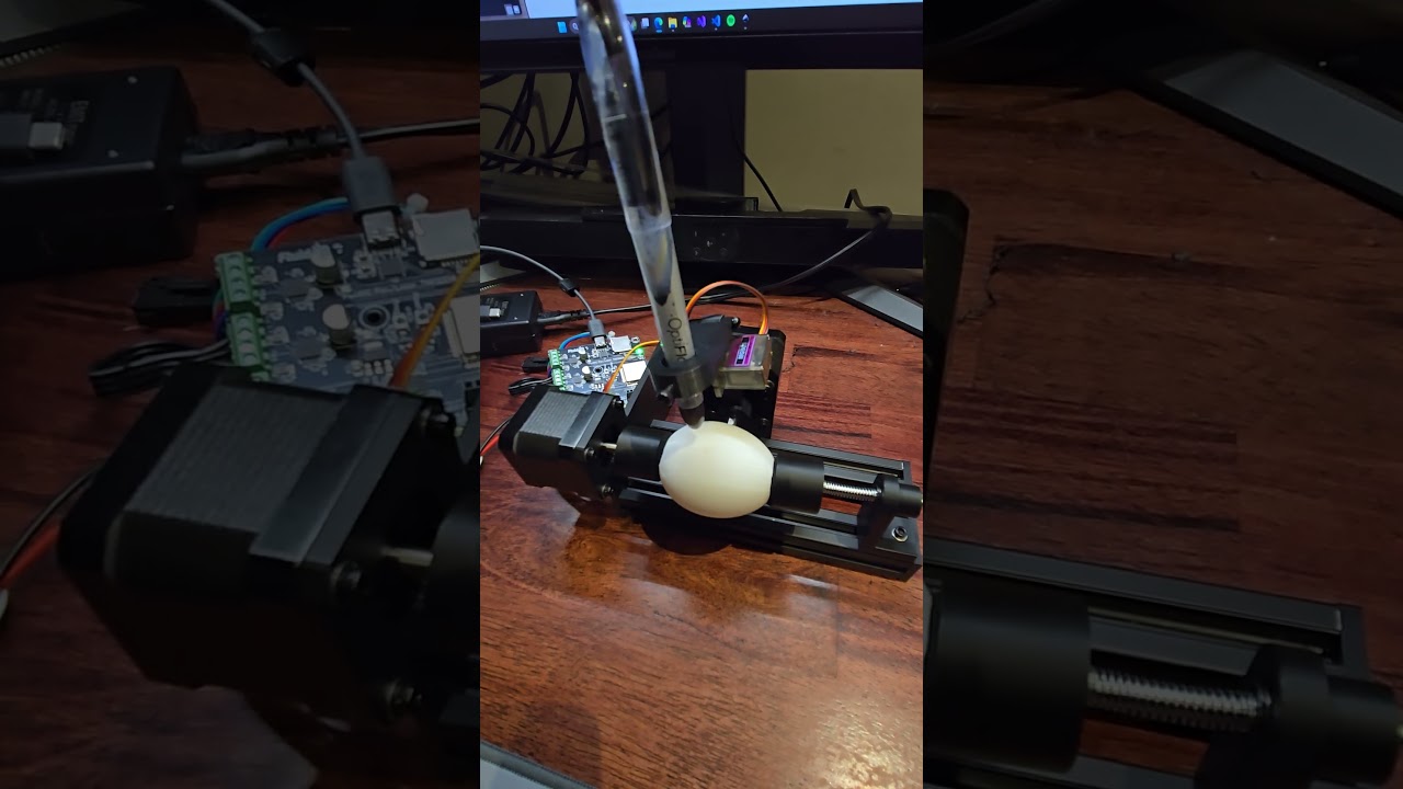

First hook it up and get it working.
It’s alive!

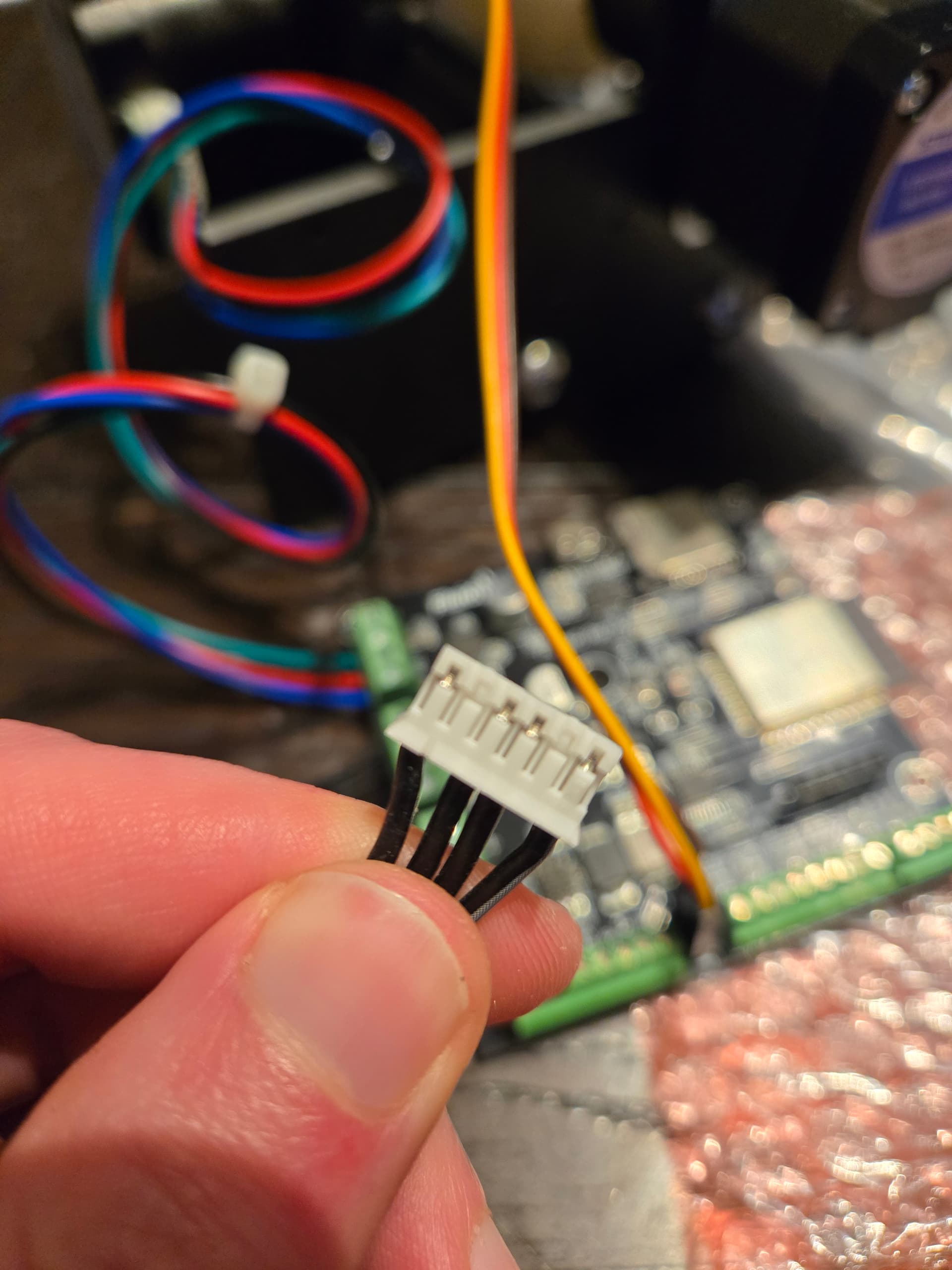

I have an SD card coming tomorrow. But it works. I think I set it up different than most. I set the pen angle as the X axis and rotation as Y axis. The Y axis might be rotating in the wrong direction. The pen straight up is X0.
Also, I apparently didn’t hate myself enough today, so I had to crimp a JST-PH2.0. Wasn’t too bad though.
