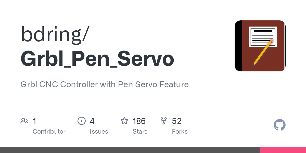

Maybe this helps? I saw an eggbot somewhere that was using it.
Interesting…I had found another GRBL build with servo support but this one might be simpler. Honestly one of the big problems is there are so many options I just start looking at them and decide “Meh, I’ll come back to this when I have more energy” :rofl:

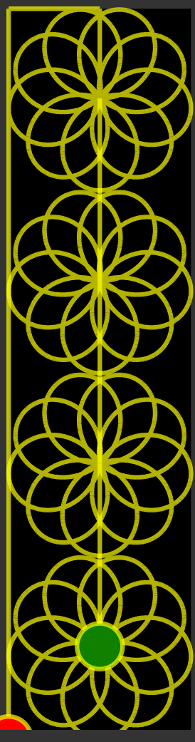

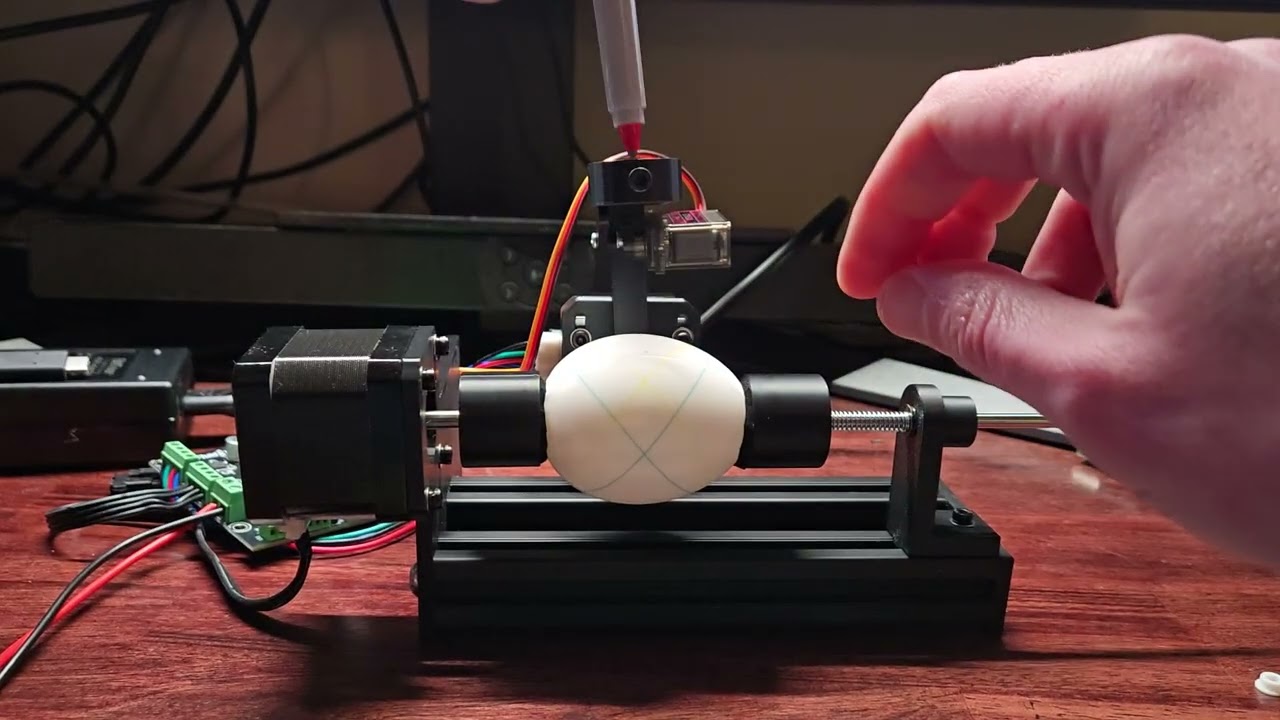

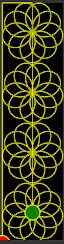

Based on some stuff I was messing with on my pen plotter and some good advice from @Stoli, I created this basic drawing with p5.js that also writes out the gcode.
egg
After some tweaks, I drew on a 3d printed egg.

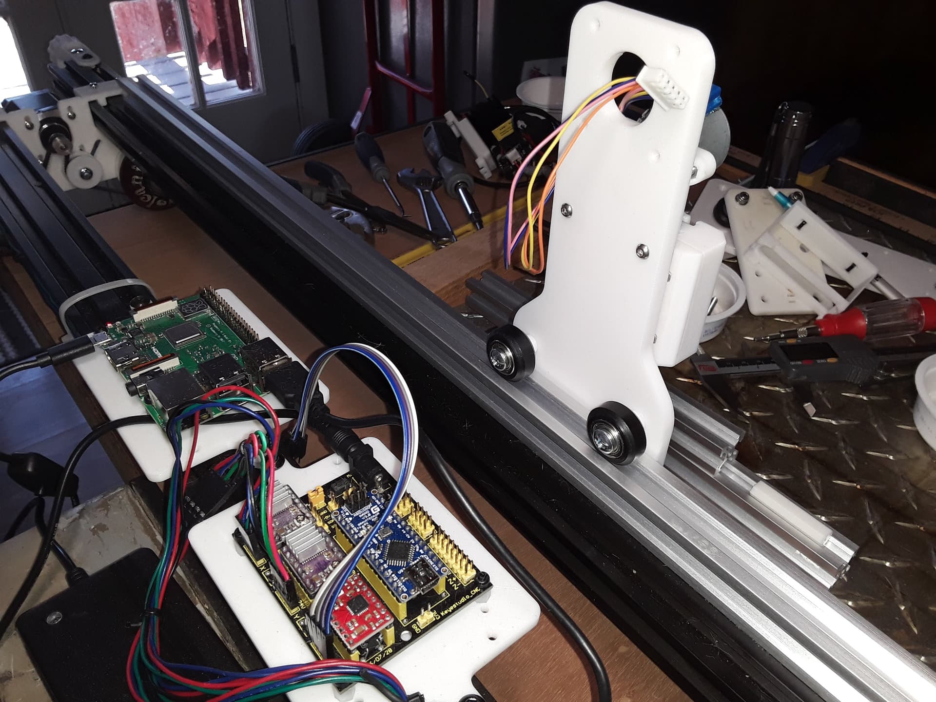

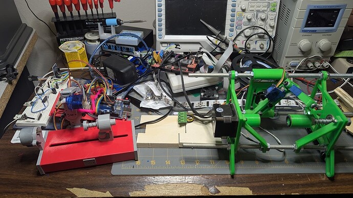

I ran across the parts for my 2nd eggbot last night so started setting it up as well:
It’s all wired - but I had been using the electronics board on an open astro tracker and it’s still flashed with that firmware. I got as far as wiring it up last night and realized I’m still missing the egg cup for the motor side and just didn’t have the energy to dig for it, print a new one, or mess with flashing the firmware.
So they’re both sitting almost usable but needing me to put more time into the firmware than I feel like dealing with right now.

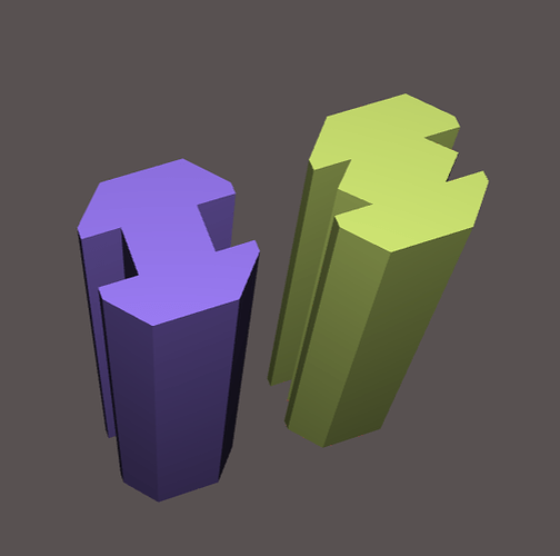

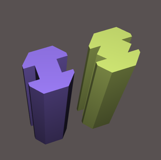

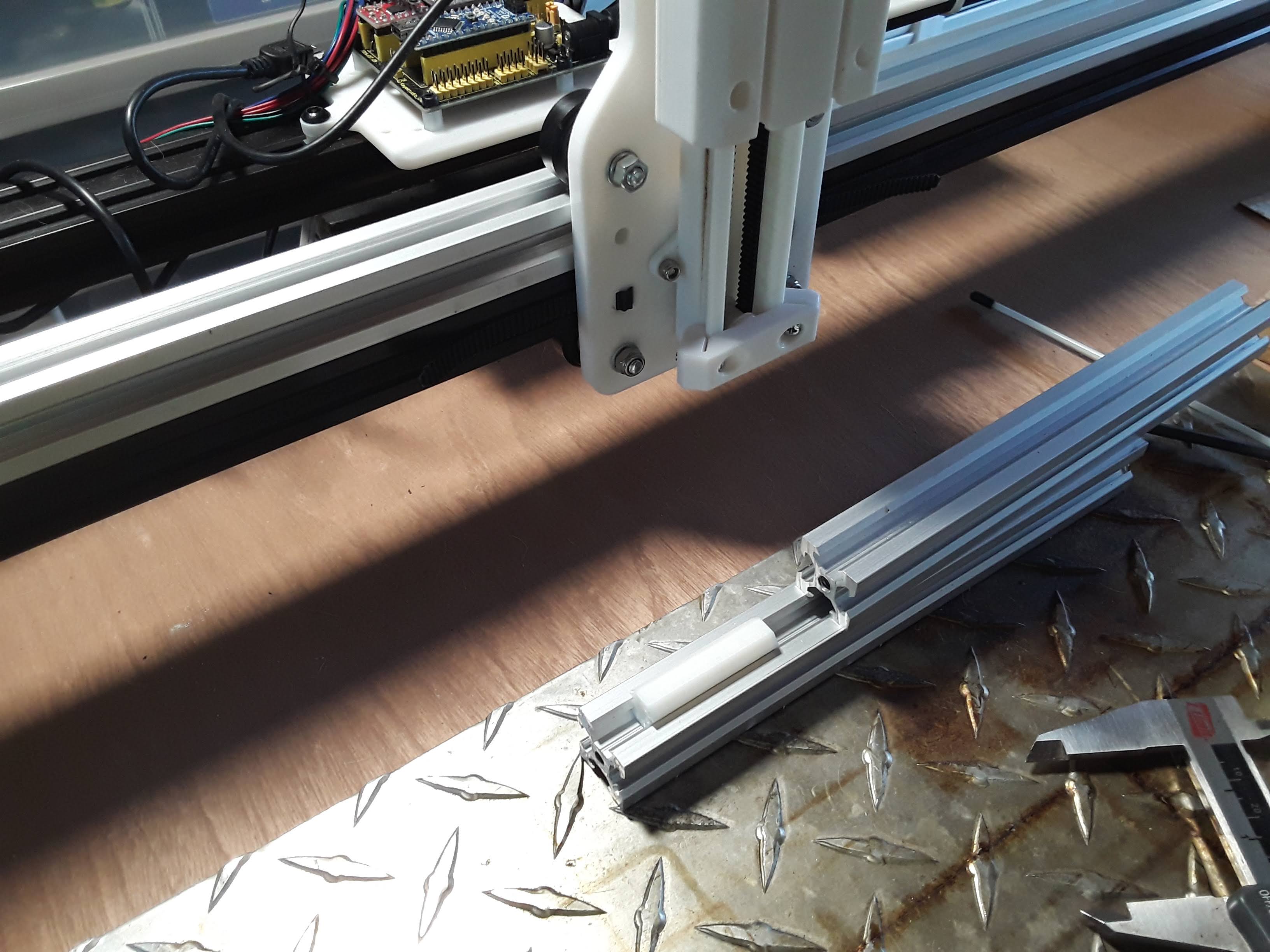

I’ve not read too closely this thread except to see that 2020 and 2040 extrusions are used in a some of these Eggbot designs. I once found myself short on some 2040 extrusion but had a couple of lengths of 2020… so I printed some simple joiner pieces to make 2040 or wider from what I had. One is for regular extrusion (left), the other is v-slot.
extrusion_joiners.zip (1.4 KB)

I think I did once do a printed “extrusion” but it wasn’t anything serious. And it was certainly a more costly print than a few of these little joiners. These joiners really only need to be 1-1/2" to 2" long (print them standing on end for strength) and two or three of them are more than enough to hold two long-ish pieces of 2020 in alignment along their whole length.

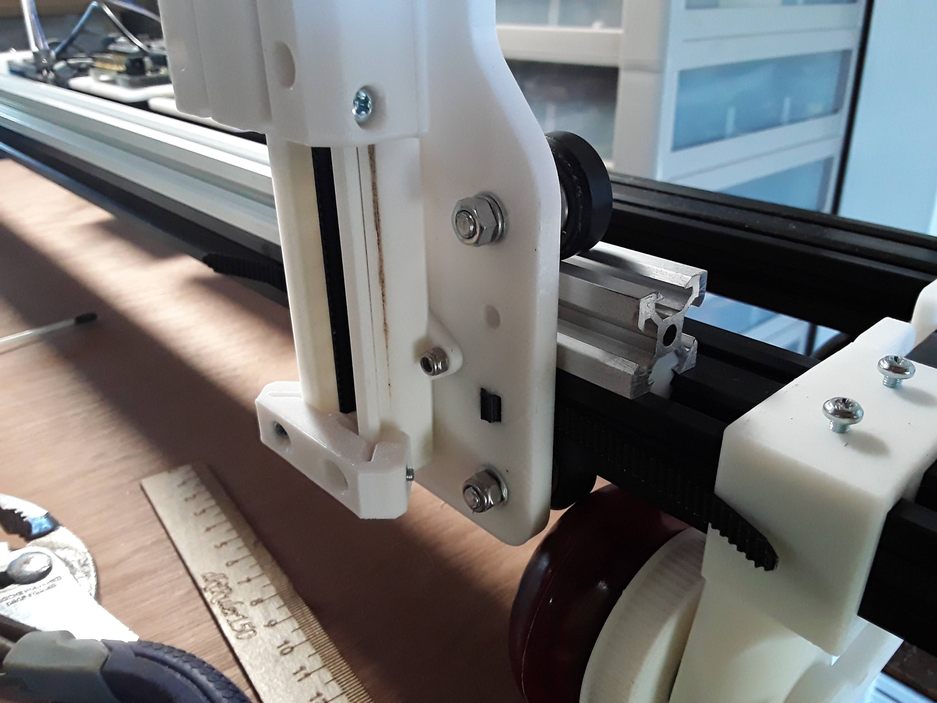

Back when we were doing the “rolling plotter” I needed 2040 in two dimensions… i.e. the silver 2020 in the following photo is joined to the horizontal black 2040 below it with IIRC three joiners and provides a vertical wider 2040 “track” for the carriage to run on…
The short test pieces on the worksurface shown below show one of the printed joiners already in place just prior to sliding the top piece of extrusion in place to form a 2040 segment…
The lighting here is poor but you can see the white plastic joiner flush with the end of the silver 2020 that is secured to the black extrusion below it.
It worked like a champ and I used this particular machine harder and longer than most of my other creations…
It was just a simple way to use some 2020 that I already had on hand rather than having to buy and wait on some more expensive extrusion to be delivered.

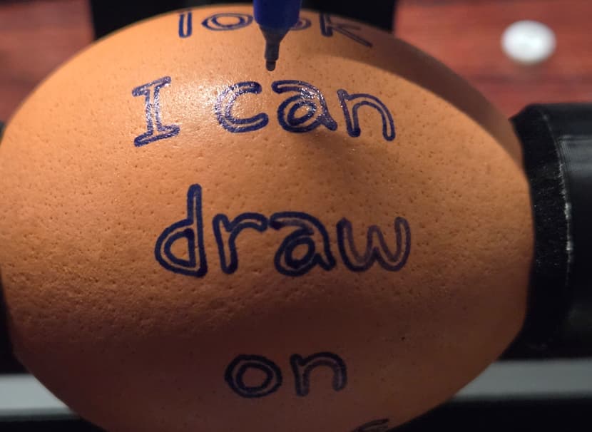

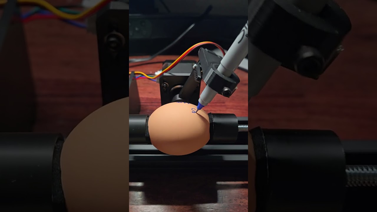

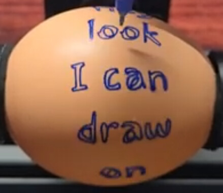

Drew something dumb on a real egg. I’m going to have way too much fun with this. We’ll see if my wife finds this as funny as I do.
You can skip to 2:05 to see the result.
The text is a little wobbly. I might mess with the egg holder/coupler things to see if I can do better. Maybe reduce how far the pen lifts too. I also might add another bearing to keep the rod straight.

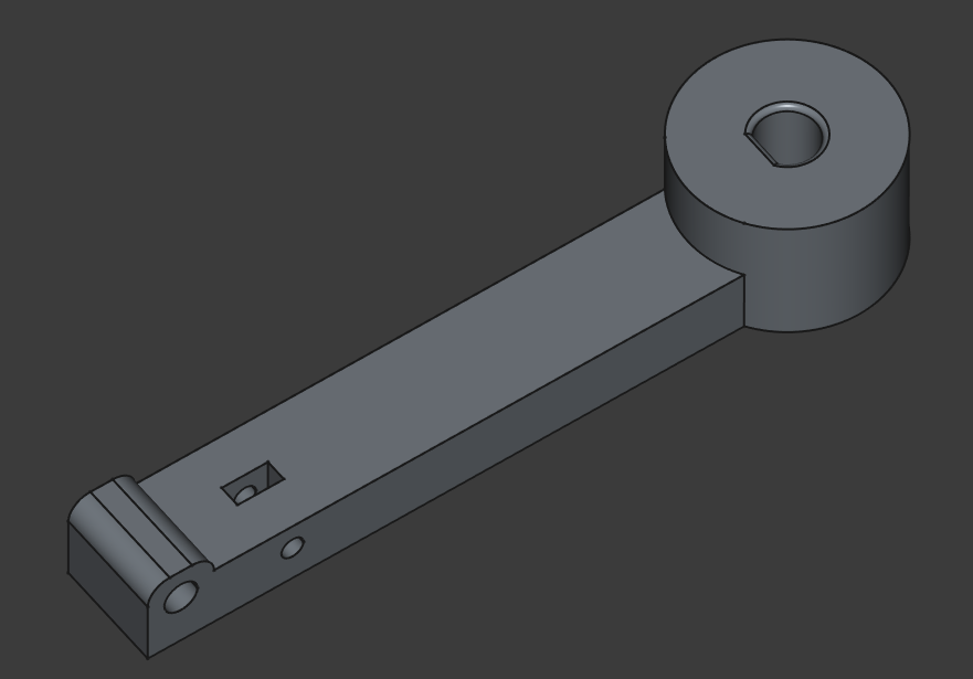

Edit: It looks like this is why. The piece that attaches to the stepper is a little loose. The part the pen attaches to also wobbles a little but not too bad. I’ll make a new piece. Still works well enough as is.

Recreated that one piece in CAD with a better fit. Also, moved the hole where the servo attaches since I had to drill a new hole in the old one. It could still use a couple minor tweaks, but there’s a significant improvement in quality.

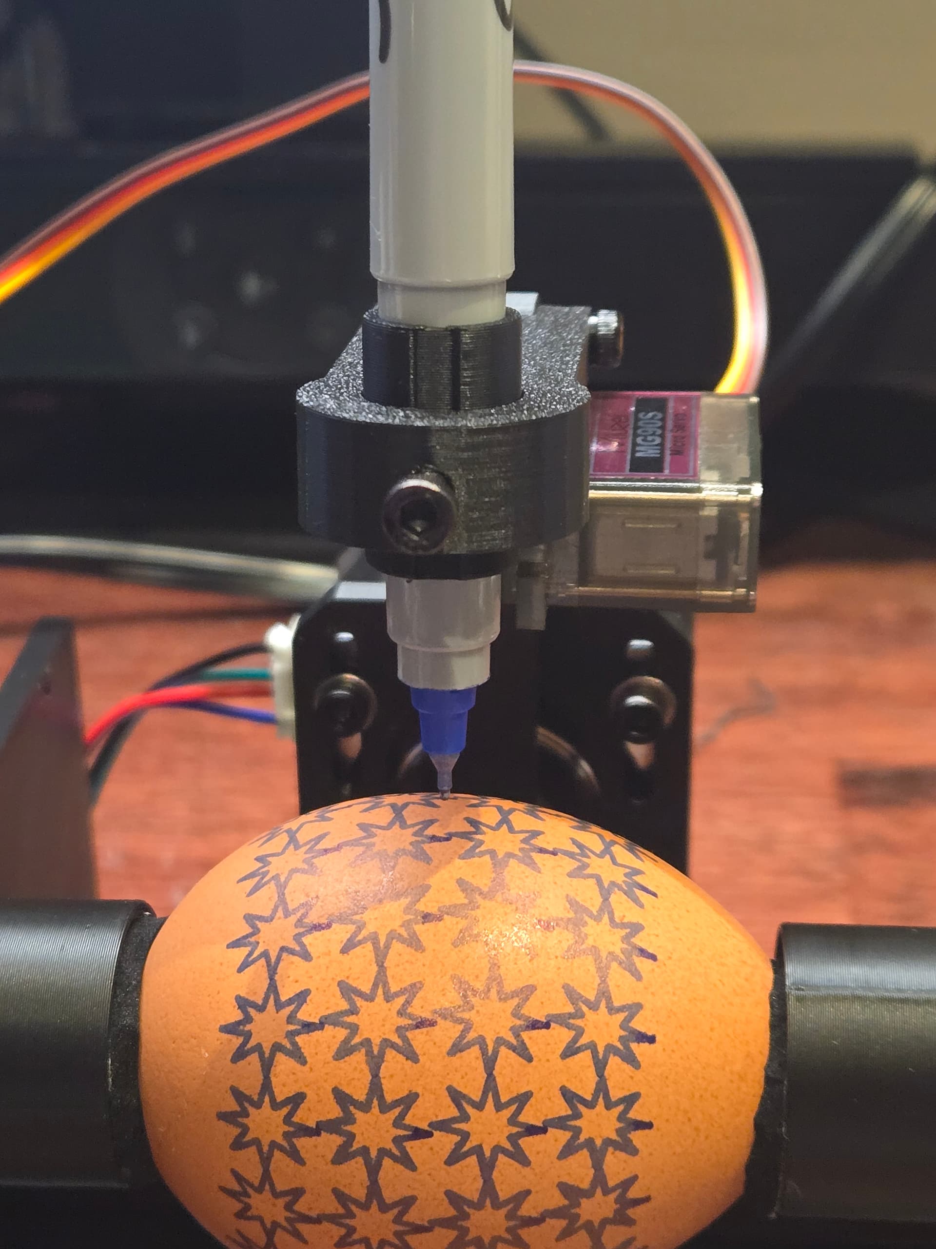

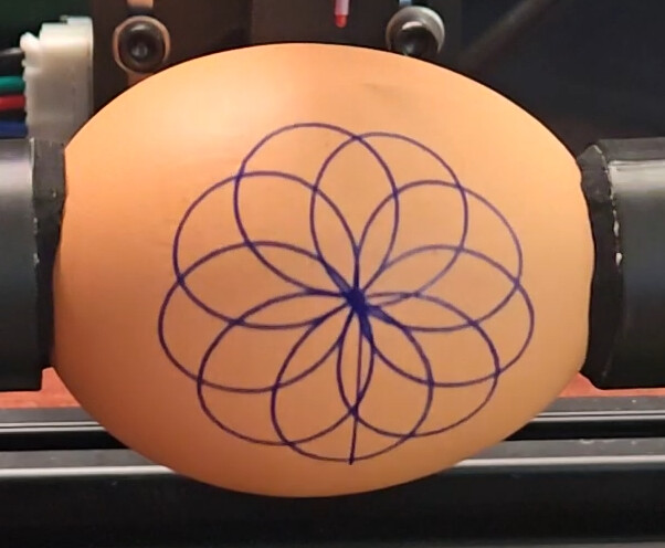

Every time I mess with this, I change something, learn something, and it gets better. I’ve tweaked and reprinted a few parts. Adding a pen collar and a tighter fit on the bearing helped a lot.
I’ve got a little bit of Y (egg spinning) inaccuracy that I’ll try and tweak but I can work around that and it mostly matters for patterns that wrap. But it looks great. I’ve also got a bit of room to draw wider which for most designs is fine but it will warp it a bit more.
That pattern I did with p5js. I’ll change it to do rows then columns and it will line up better.
