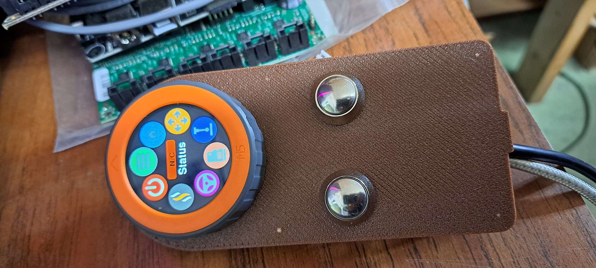

Congrats on the pendant build, these look neat.
Vetco on Northup? Down the road from me. Love that place, and Tap Plastics across the street. Tap Plastics have a nice offcuts bin with 1sqft Polycarbonate/Acrylic pieces starting at $1 depending on thickness.
Indeed! It was a bit of a drive, but worth it. Not many stores like that these days, glad they are somehow still in business. Picked up the little acrylic window for my Jackpot case from TAP for $1, although at the downtown Seattle location.
Made my wooden pendant enclosure out of a scrap piece of wood and the wiring, pics soon…

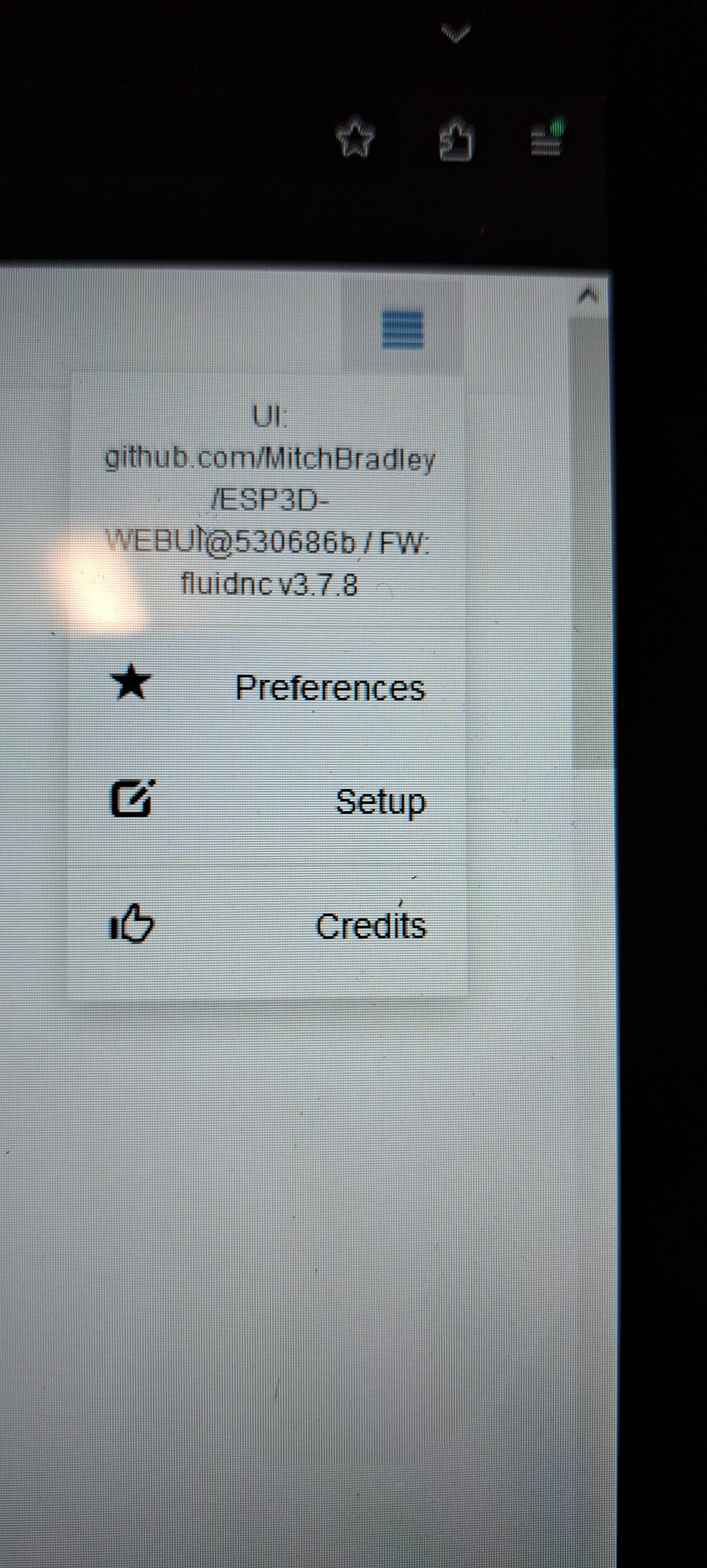

I’ve updated my config.yaml to include the uart2 section as shown. I’m still receiving NC on my dial. Any ideas? I have double checked my config, version number and wiring and all seems to check out. I’ll double check everything tomorrow with a fresh brain as well.
Your firmware is 3.7.8 which is ancient. You need to update to 3.7.13 or higher.
I used the web installer to do this, https://installer.fluidnc.com/
You’ll have to press the Boot button on your jackpot right before it flashes for this to work, that step was weirdly not documented when I did it last.
