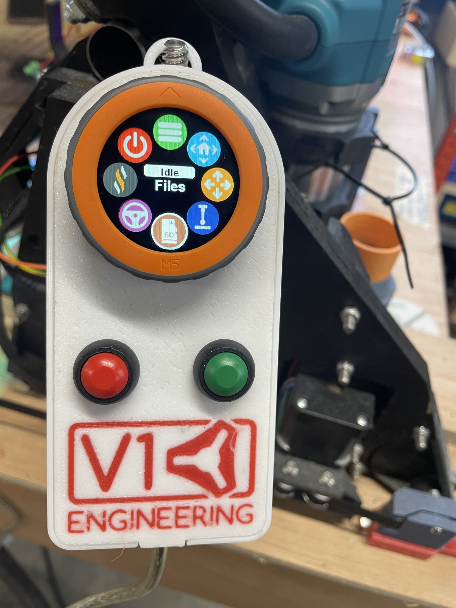

It actually is a touchscreen, although it is a small round one. But it’s not just a touch screen, there’s also the rotary dial, which is an input, and the two momentary switches, which are inputs.
It is a pendant, so it is not meant to completely replace the main control screen, which would be presumably the web user interface on a tablet or phone. However, while it doesn’t do everything, it does most of the common routine tasks. You can home, jog, zero at a workspace origin, probe to material height, browse and launch G-code cut jobs, turn mist and flood on and off, turn VMot’s on and off, and because you can run G-code, you can create a subfolder on your SD card, called Macros, and name the G-code files in it for your various macros, and use this as a way to run macros. The primary thing that it does not do is: no terminal interface for manually typing in commands. There may be other things that the full user interface can do that it can’t, but the terminal is the main thing I can think of right now.
Now, as I say in my recent video, “you need a cradle.“ I humbly offer my design! :slight_smile:

It definitely could be used for the MPCNC, and you would just have to figure out based on your situation whether you already have a place to put it, or you need to add a place.
It is designed to be mounted to any vertical place. However, it could be pretty easily remixed to be mounted to a horizontal place as well. If that would help with mounting it, let me know.

A hook or post definitely can work with that hanging loop. The reason why I wanted a cradle instead is because I wanted to capture it in an angled position that allowed me to use it as a control even without having to pick it up. So I have the option of handheld or cradle-held. With it positioned in this cradle, it is almost in the same place and almost at the same angle as the touchscreen used to be back when I had an SKR board with a BigTreeTech touchscreen on the top.
