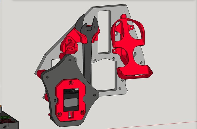

NOTE: As of today, Jan 22, 2024, new versions (v1.2) of both the cradle and case bottom, have been published on the Printables listings, which were modified to have the magnets glued in from the reverse sides, so a magnet’s grip from one side can’t pull out the corresponding magnet from the other side. Both magnets will pull each other “into” their sockets instead of “out of” their sockets. (They pull through thin layers of printed plastic.) The magnetic grip is slightly lessoned, but adequate, providing the magnets are firmly seated into the sockets. Below is a link to the new version:
https://www.printables.com/model/733285-cradle-for-fluidnc-dial-pendant-on-yz-plate-of-low
Installation placement:
Good news: my “N/C” (not connected) issue was indeed a wiring fault, not a firmware issue. I opened up the pendant, looked the wires over, saw one solder connection that looked like it might just be a weak point, re-soldered it, and it’s been going great ever since. I’ve used it to run nearly a dozen cut jobs flawlessly.
Regarding my recently shared Printables link to a v1.2 with the magnets being glued in from the reverse sides, please see this new update added to the Change log:
January 22, 2024 (3:50 PM) — revised v1.2 has been uploaded, to fix that the thin layer below the magnets, was not thin, or at least not thin enough. So sorry to the one person who downloaded between this morning and now. Please re-download if you see this, and especially if you have not printed it yet.
Also note these newly added…
INSTALLATION DO’s and DON’Ts:
  • For the inside of the case bottom, the magnet sockets near the side wall are the hardest to get to, so do them first, to reduce having an existing nearby magnet fighting you by pulling on the magnet you’re trying to install.
  • Although my normal process has been to drop CA glue into the socket and then press a magnet on top of it, for reasons of difficulty of access inside of the case bottom, I switched to pressing the magnet into the dry socket first, and then slathering CA glue on top and all around, and then drop a second magnet onto that first one, to hopefully increase magnetic hold power, and then a bit more CA glue, and then spray accelerant on top all that.
  • I eventually found that the perfect tool for pressing the magnets into their sockets (especially on the inside of the case bottom, but probably for the cradle too), was an M5 screw. I would carefully remove one magnet from the stack, and while keeping it’s magnetic orientation correct, position it on the tip of the M5 screw, and use the M5 screw to press it into the socket. Snug fit means the magnet stays put while withdrawing the screw. The is done while the socket is dry, and then a slathering of CA glue is applied over the top and all around, and then accelerant sprayed on.

NOTE: As of today, Jan 27, 2024, there are now 3 editions of the cradle design (two with magnets, and a third without magnets):**
  • v1.4 - 1st edition - GET IT HERE - magnets on outsides, opposing magnets touching
  • v1.5 - 2nd edition - GET IT HERE - magnets on insides, opposing magnets not touching
  • v1.6 - 3rd edition - GET IT HERE - no magnets at all, just a press fit insertion & removal
All three versions were redesigned to have less overhang for better print results (overhang extremes split to be 45 degrees each, as much as possible), and were accordingly renumbered in their version number designations. Below are screen shots of the third edition, which uses no magnets, opting instead for a “press fit” method.
