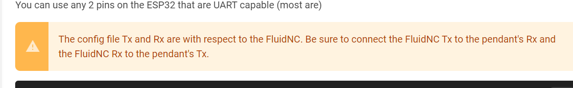

  1. Forgot this block in config.yml! I just put in the uart2 definition as highlighted previously, but not the uart_channel2 block.
    dontforgetconfig
  2. The trimmed down JST connectors weren’t fully seated in the A and B ports.
  3. This highly important knowledge:
    I had RX to RX. Oops. I did try swapping at first but my jst plugs weren’t fully seated yet.

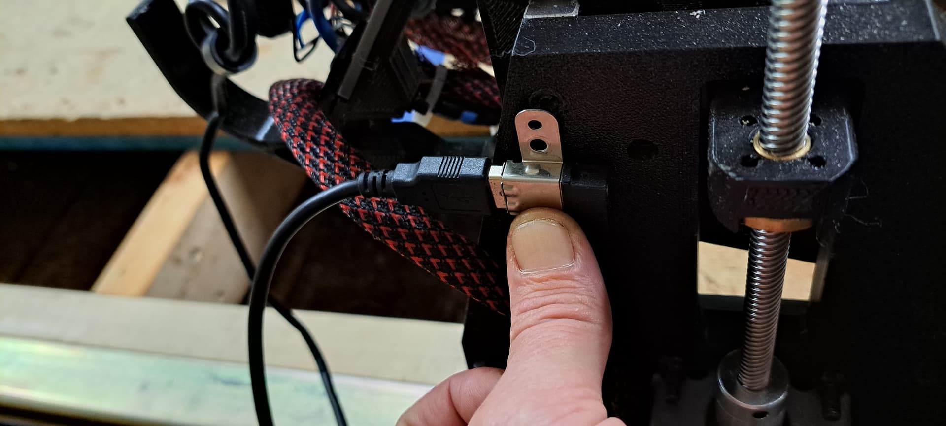

As Doug noted you will need to trim the tabs, as in the two little strips on the side, which will face outwards. Don’t have a great pic but this is what they look like plugged in. It’s a tight fit so make sure they are fully seated.
Need clean up the rats nest, but still not sure my connection is 100% because of the negative position “blips.” Wishfully thinking it’s just a bug, but i will likely go back and ensure the solder joints are all 100%. Have any of you with working pendants seen that perchance?
