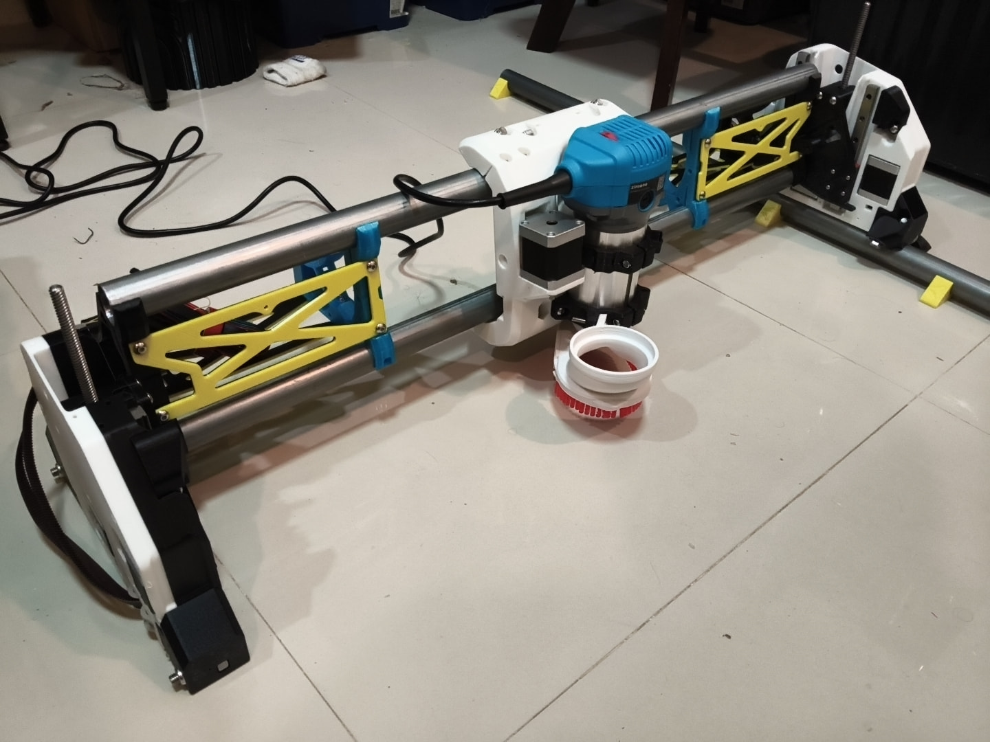

Farm Fresh from the LOS... another Thai build
Always wanted a Router and this seems like a great bang for the buck Option. First post here, waiting on the slow buffalo from china at this point. Mostly printed in PETG-GF. Still need to print a few more braces but I haven’t ventured out for conduit yet and want to make sure of the sizing.
My build size, I think, will be for 60x100cm foam sheets. I keep waffling but think I have reached the conclusion that making it bigger later or just building another one isn’t a big deal.
Have a BTT SKR1.4 coming, have a pi zero2w on hand and have prepped it for klipper. sort of considering sensorless homing, but not sure on the dual Y&Z Not real sure of my cam options. I use fusion360 free version and I think it will work?
Just have the parts out checking stuff over and this seems a good time to say HI. All suggestions are appreciated. I’ve become of something of a chatGPT fanboi. I’ve had it tracking this project. I’ll attach a document link if anyone is interested. It’s bit over the top at the moment and needs to be pared down now that stuff has been ordered but thought some might find it interesting. I personally haven’t really looked at it TBH but fun none the less. Google AI project
Cheaped out on this Thai Router as I’m not keen to listen to one anyway. I see some sort of brushless, speed regulated, probably belt driven, DIY spindle in my future.

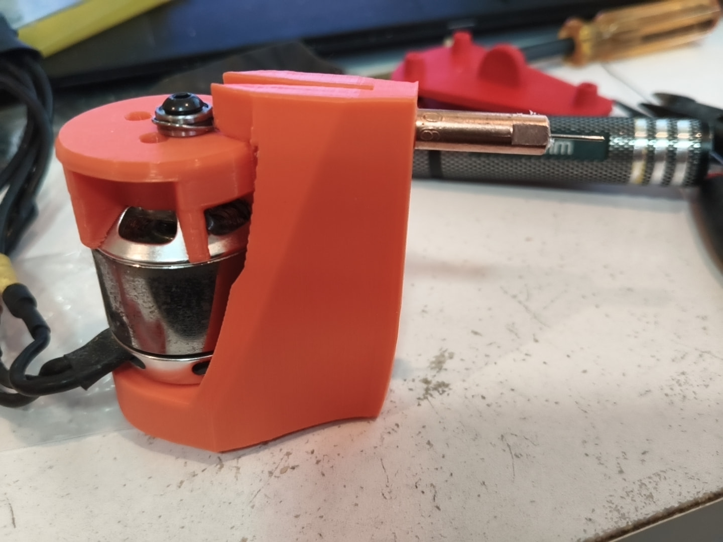

Started making a pin cutter/tatoo machine today. Hoping it will cut EPP foam, fingers crossed but research says it will. There’s a real blunder in the picture… rotated the fan 180 to align to the motor openings and turned the counterweight to the wrong side but it runs fine, it’s fairly rigid but I will be changing it. Thinking about mounting is on a gimbal to allow for “5” axis bevel cuts. project for later.
Anyway, just an intro. Look forward to getting the tatoo gun automated!!!
Welcome to the V1 community forums! Please keep this thread up to date with your build. We love to see builds documented.
In particular, I’m looking forward to seeing how your pin cutter works out and the details of that toolhead.

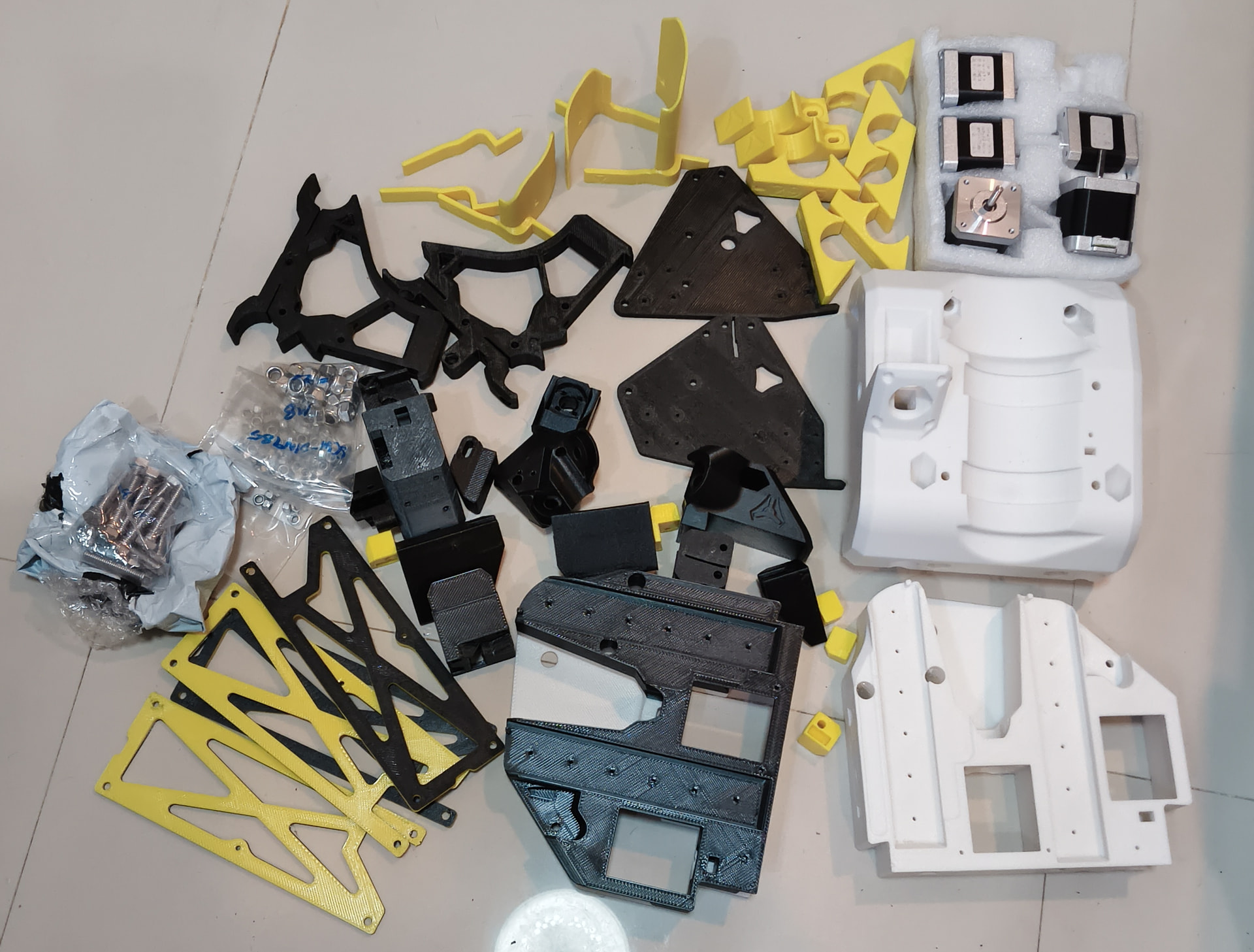

Aliexpress was kind enough to use a medium speed kwai for my shipment. Things are going together nicely, no major snafu’s yet. The lever’s on the limit switches might be a bit short for the Y axis, haven’t fully investigated yet. Need to cut down my table top so just mocked up on the floor for the first time.

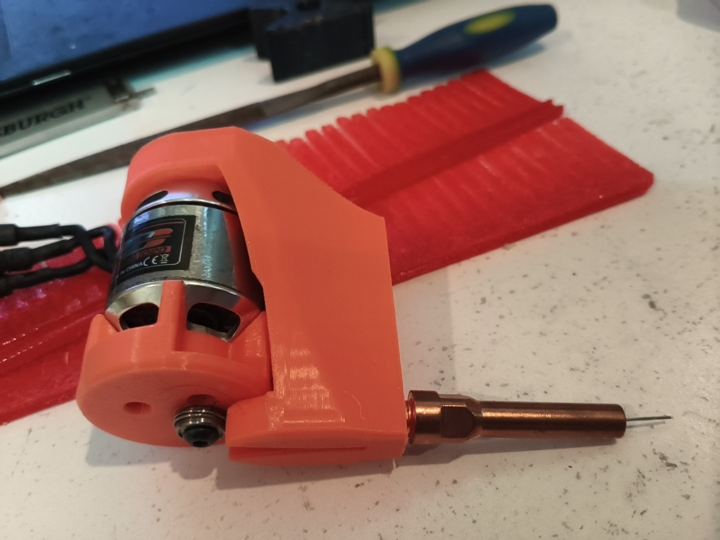

Did iterate on the pin cutter a but while I waited. Went to a longer tip which will allow for 45deg tilt to the heel of the tool. Also incorporated a superglue ptfe tip after counterboring the mig tip a bit. Tightened the .5mm cutter up in the bore and hoping it will run cooler and require little to no lube keeping the cuts clean for future gluing. Cuts very clean, better that I was expecting. Have tested it a bit on EPP, EPE and EPS foams and all work well. Cardboard seems doable too. Need to constrain the cutter to crank bearing a bit better but is more than useable as is.

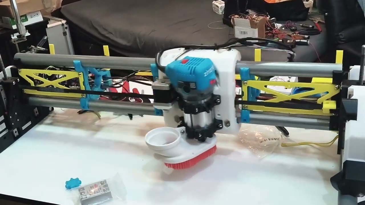

Like most things, the LRv4 design surprised me in a number of ways. I thought the filament retained tool mount nuts was super clever until I actually used them and 2 of the four nuts just backed the retainer filament out. No big deal but not the result I expected. Maybe the biggest surprise is the floating Z nuts, pretty much only gravity drops the gantry. Everything is running smooth but the Z’s are a bit firmer than expected(I have not yet cleaned and lubed the rails). The entire machine is much more massive than I was expecting, but that’s a good thing!
I’m not a fan of heat set inserts and was glad to see none used. That said, I am having a bit of a issue with a few of the m3 linear rail mount screws but nothing catastrophic. Next time I think I would use self tapping screws here.
I understand sheer webs but they still amaze me. The sheer plates stiffen things up in an incredibly good way! Looking forward to getting my full length ones cut. Currently using printed YZ plates, I guess that will be my first metal project!

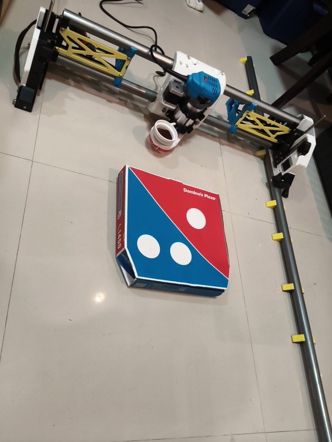

Looks like the entire project will come in a bit under $400usd (not counting pizza and adult beverages)which seems a great value. I’d say mechanical is about ~75% done and need to get on to the electronics, table mods & dust control.

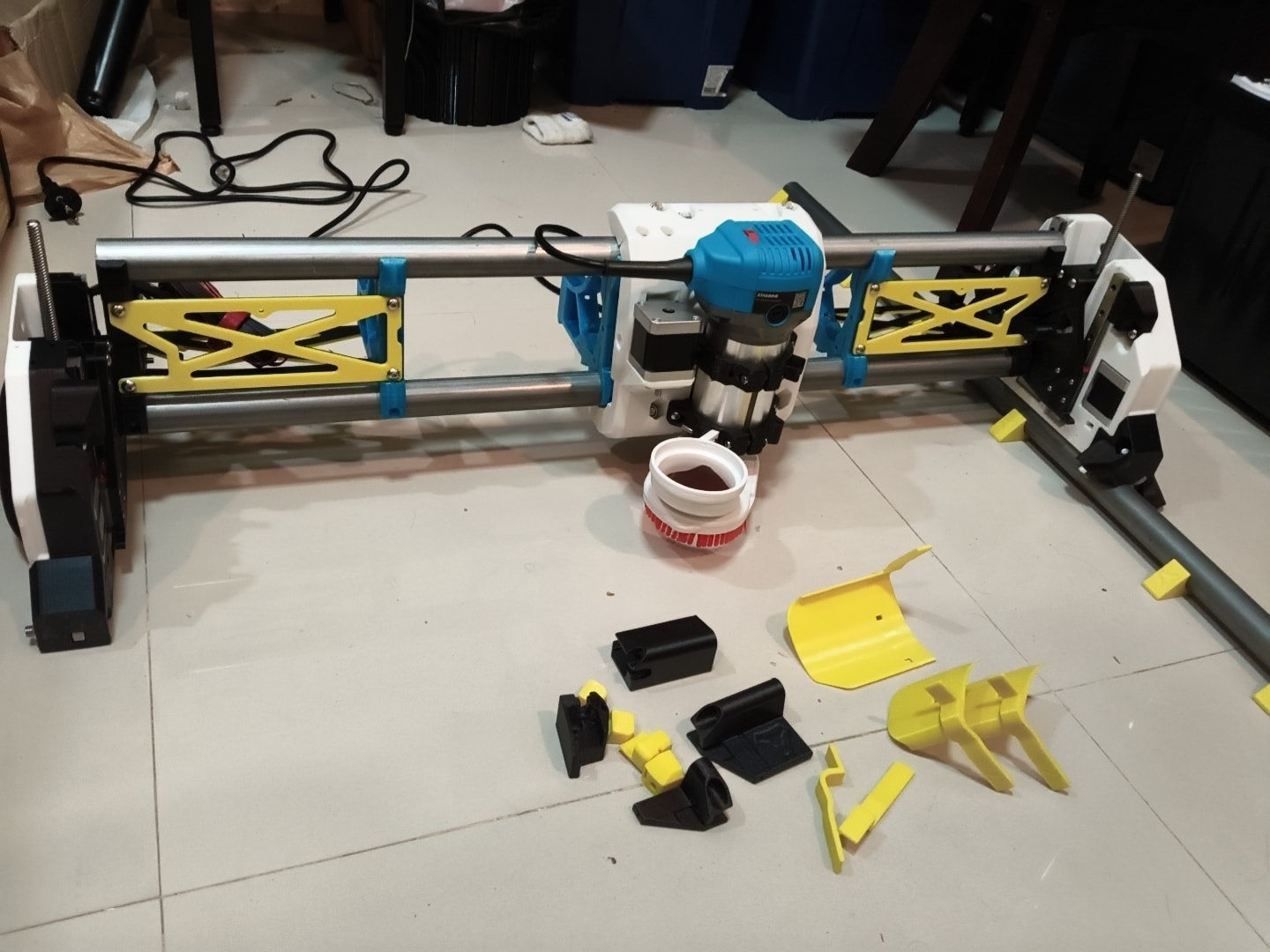

Some success… still waiting on a skill saw to show up but everything is checking out. Y motors and switches working but no table yet.
Any opinions? seems to run smooth and plenty quick I think.
Few cutters, drag knife, 4&6mm collets and dust collection hose/tubing on the next slow boat.

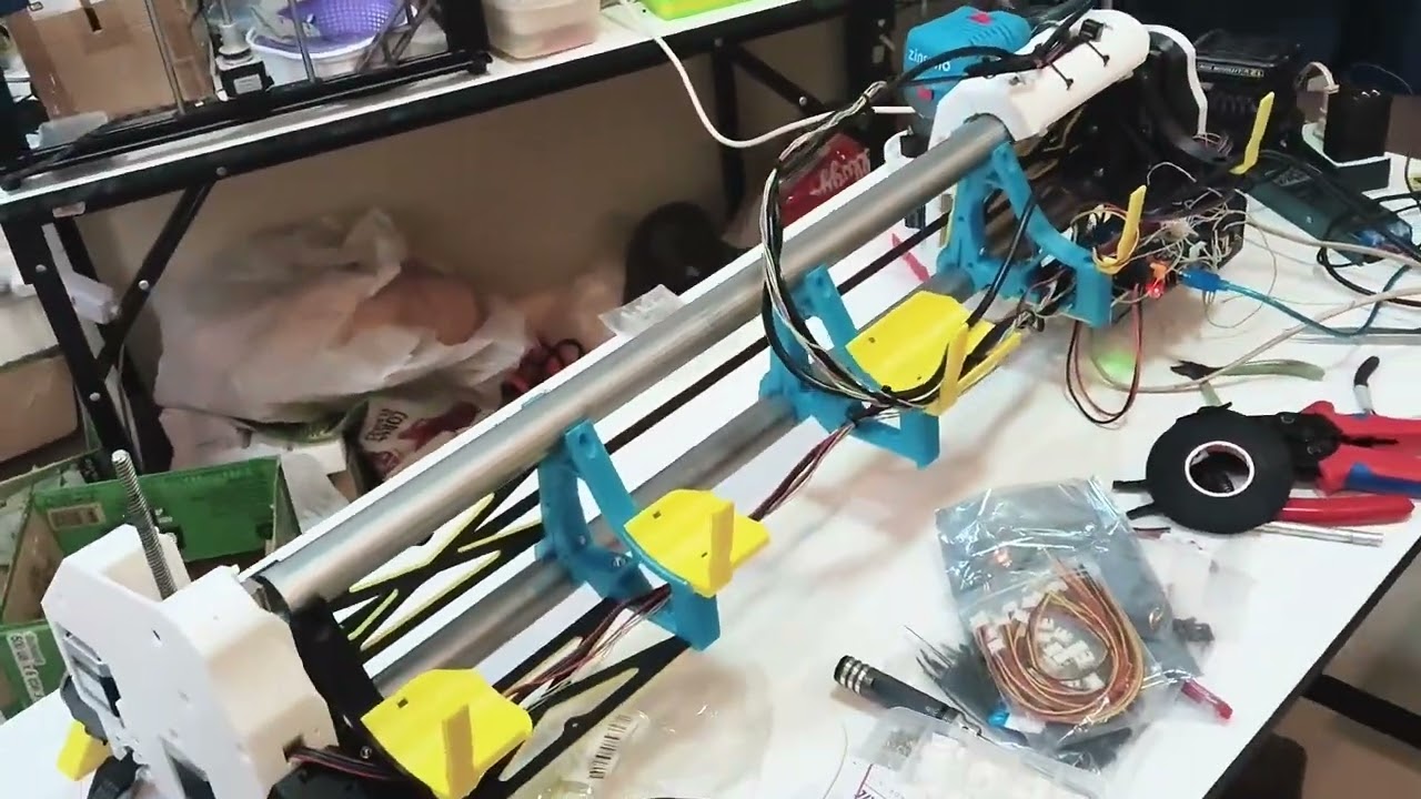

Sorta wishing I’d set up wiring to the conduit Y axis side so the dust hose would be on the same side as the y axis conduit.
Without the full width cut shear plates/webs don’t really see any way to keep the Xbelt tension from sliding the x conduits against the end plates but don’t see an issue… yet.
Pushing a bit harder. Obviously more than it really needs but trying to validate where we’re at.

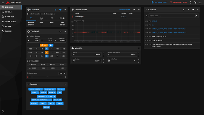

How Klipper is shaping up so far…

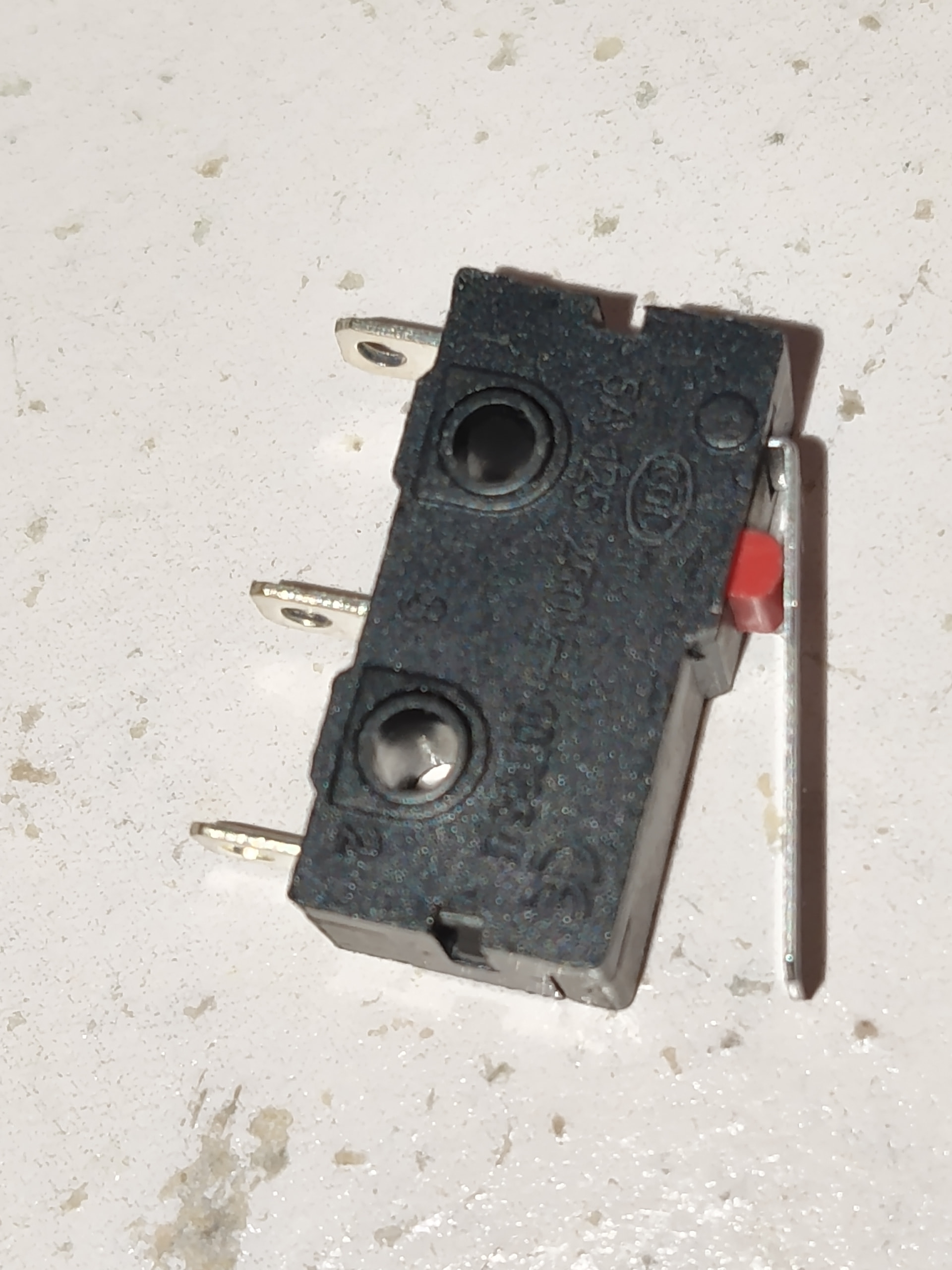

The two stumbling blocks that have slowed me down are the limit switch arm lengths which I have resolved and the locations of the belt mounts on the table are not very intuitive maybe could use a bit more explanation.

I managed to mangle one of my y limit switches while I had my gantry off working on the bottom of the table and didn’t notice until after I started laying out my T-nut hold down grid. Fortunately I was being quite conservative with my layout and caught the problem fairly early. No real damage done but a couple shallow marking holes that won’t disappear once I get the T nuts in. Is there any solution to shield the switches? I haven’t looked too hard but I don’t see an obvious way to mount anything.

Have tried to keep it single phone screen. These are some random shots trying to show some features.
I think this a big improvement over the stock printer set up. If you have further ideas, I’ll try to include them.
This is AI log of changes. If there’s interest I can try to provide files but not sure how transferable they are.
Area Current Mainsail behavior Settings / safeguards
Dashboard layout Toolhead renamed Spindle Location. Normal CNC controls consolidated in its compact Android-friendly panel. Separate Homing & Zero Axis panel and Work Lights section removed from view.
Position and travel Current X/Y/Z positions with work travel range immediately underneath each coordinate. Ranges account for work-zero offsets; unhomed axes show a home-first message.
XY jogging X horizontal and Y vertical around the XY center. Every jog button has a small lowered axis letter. Unavailable travel and controls are grayed out.
Z jogging Horizontal Z jog row directly below XY grid; includes ±10 mm choices and coarse travel limits. Endstop indicators below Run speed, beneath the jog rows.
Coarse / Fine Single toggle shows the action: Fine switches to fine steps; Coarse switches back. Current mode appears in the tooltip. Step sets retained.
Jog percentage Direct percentage entry, ±10-point buttons, Min / 50% / Max. Default 50%; selection 10–100%. Percentage box shows active value first, selected value in parentheses when capped: 30% (50%). Tap to edit the selected value.
