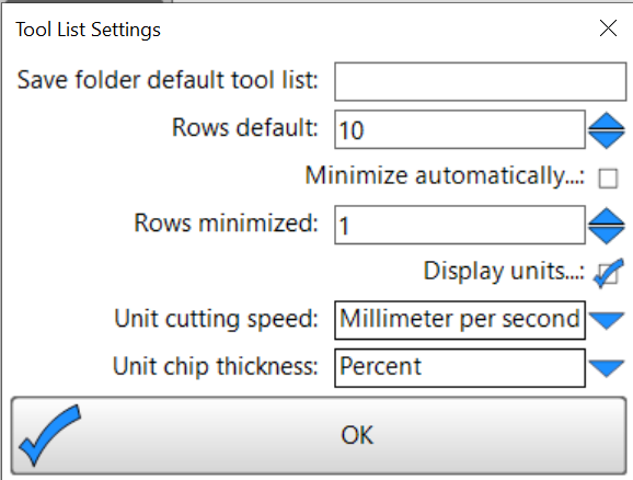

That should be easily doable. You can have multiple tool lists or merge existing ones.
Huh???
I agree, I just don’t know if we have that. I bought the 5 pack of mixed endmills, but only have 2 of them defined so far.
Yesterday I was going to add in the ball end and was unsure exactly what to put for Radius, flutes, etc.
It would be good to at least have screenshots of the correct settings in there for all of his end mills for new people to get started with
Pretty sure the ball is 1/8" radius so that would be 1.5875 if I remember correctly. And i believe those are 2 flute. Sorry not looking at it right this second.
It’s 1/8” endmill, so I assumed 1/16” radius, which is 1.5875mm, and 2 flute, but it just wasn’t spelled out anywhere.
It takes a bit of learning for people to get comfortable with all these things, and as someone who is completely new to CNC and CAM, I can be quite unsure of myself, as I’m sure others are too
Oh I don’t disagree with you at all and I’m sure @vicious1 wouldn’t have an issue adding it to the Docs
