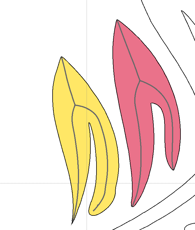

I’ve been trying to use 12.
I don’t know exactly how to reproduce it yet, but I have more than once gotten into state where I had many carves that just show as a Blue outline instead of filled in like this.
When it gets in that state, you can’t select them in order to delete them. Even the rubberband tool wouldn’t select them. Clicking File->Open and selecting a completely different design won’t clear them either. You are stuck having to close the application to clear the bad toolpaths.
I emailed him several weeks ago asking where we should submit bugs, etc for EstlCAM 12, but got no response back from him at all.
The blue outlines mean the carve is being calculated. He overhauled the code for carves completely lately. You can also try Alt + F5 (careful not to slip… :yum:), that resets the cache, I had to do that yesterday after his fix.
