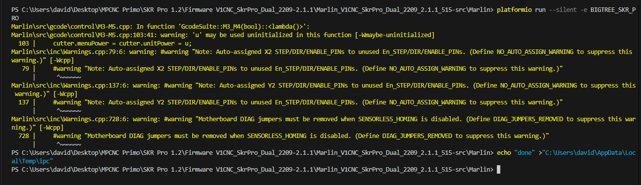

Another doubt: are these warnings when I compile the firmware ok?
The fact that the board is showing not triggered when the endstop wiring is completely removed means that there is a problem with either the board or the firmware. Any investigation of endstop switch wiring, switch type, resistors, etc. will not address this underlying issue (IMO).
Is it possible that you installed the endstop resistor pigtails backward on the board at some point (with the resistor on SIG rather than VCC), which may have shorted VCC and GND together, damaging your board?
Is it also possible that the firmware is incorrect? You posted a picture above (post #8), but I don’t know enough about the MPCNC firmware versions to know if it is incorrect or not (based on the date, it looks different than the versions issued by V1). Maybe someone more familiar with MPCNC firmware versions could chime in.
You mentioned that you compiled your own firmware (with multiple errors). What happens when you install the unedited V1 official release?
