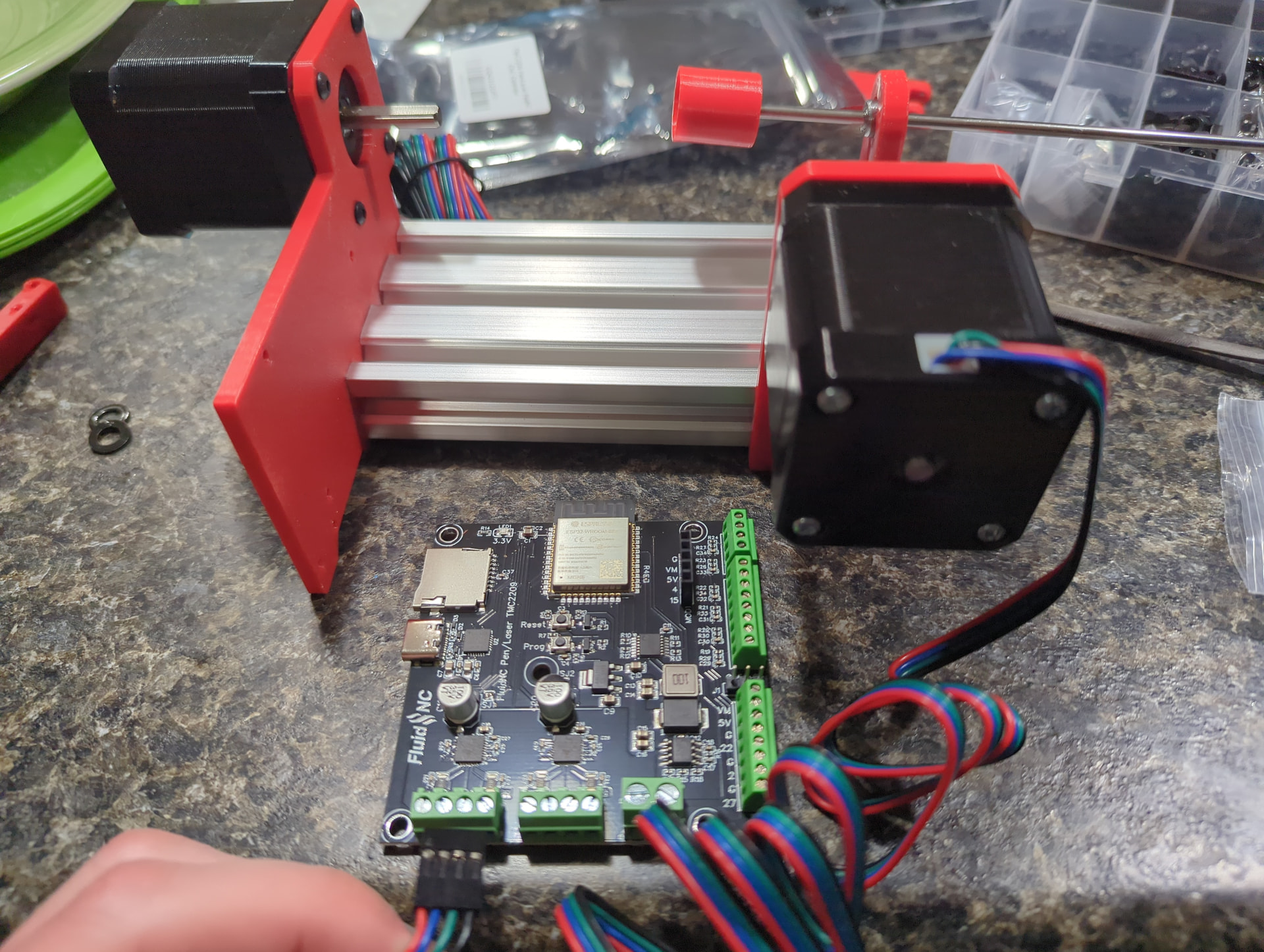

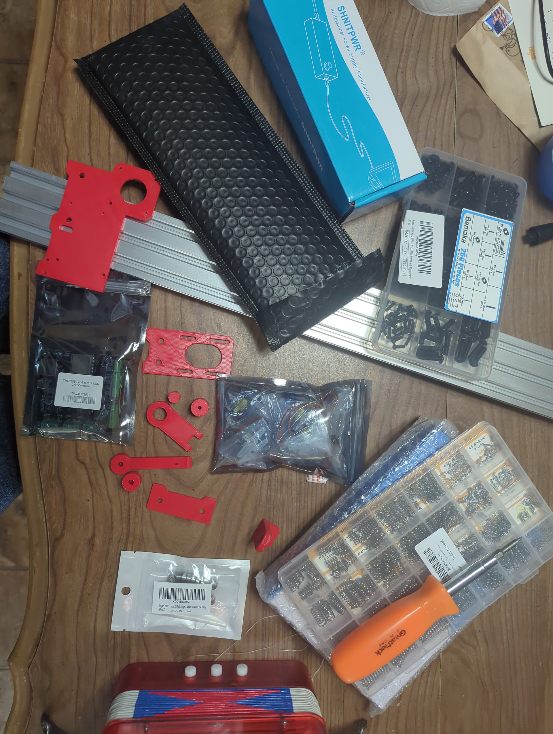

Inspired by this thread FluidNC Eggbot , I’m going to need an eggbot. I’m also using this thread as accountability so I can hopefully finish it by easter time. Probably going to be a few questions as well. I’m using this as the main build guide and will make modifications as necessary. ESP32 Wifi Eggbot - Drawing Robot Plotter Pen : 16 Steps - Instructables I bought the 2060 aluminum and the controller last year in optimistic hope I could complete it before Easter but other plans quickly got in the way. NOT This year!

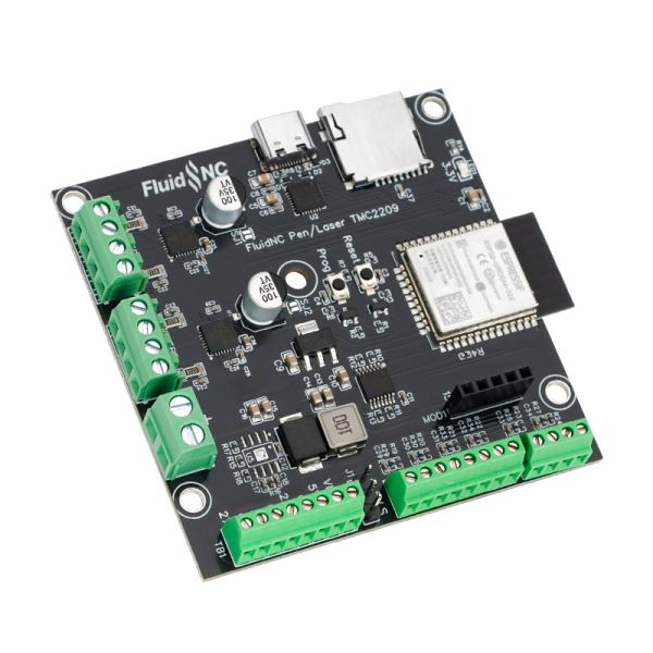

With the bart-dring board no longer available, what boards are people using on these now? The board I had that I could have used for this is now on the laser engraver. I do have a crummy 2 channel grbl board, but I’d hate to have to deal with that thing again.
I use one of these which is currently in stock on Elecrow and Tindie.
I thought he had discontinued those. I’ll have to snag one.
I checked 2-3 days ago and it was definitely out of stock on Elecrow. I bought three of them last year thinking they’d never come back.
Screws, nuts, servos, springs, bearings, and linear rod all purchased and should be here Wednesday to start initial assembly :slight_smile:
We’ll see. Tindie says ‘4 in stock’, so I ordered one.

parts are printed. Hardware received. Now just need to find my nema 17s I ordered last year, cut the 2060 to six inches and start assembly. Hopefully can start it up this weekend.

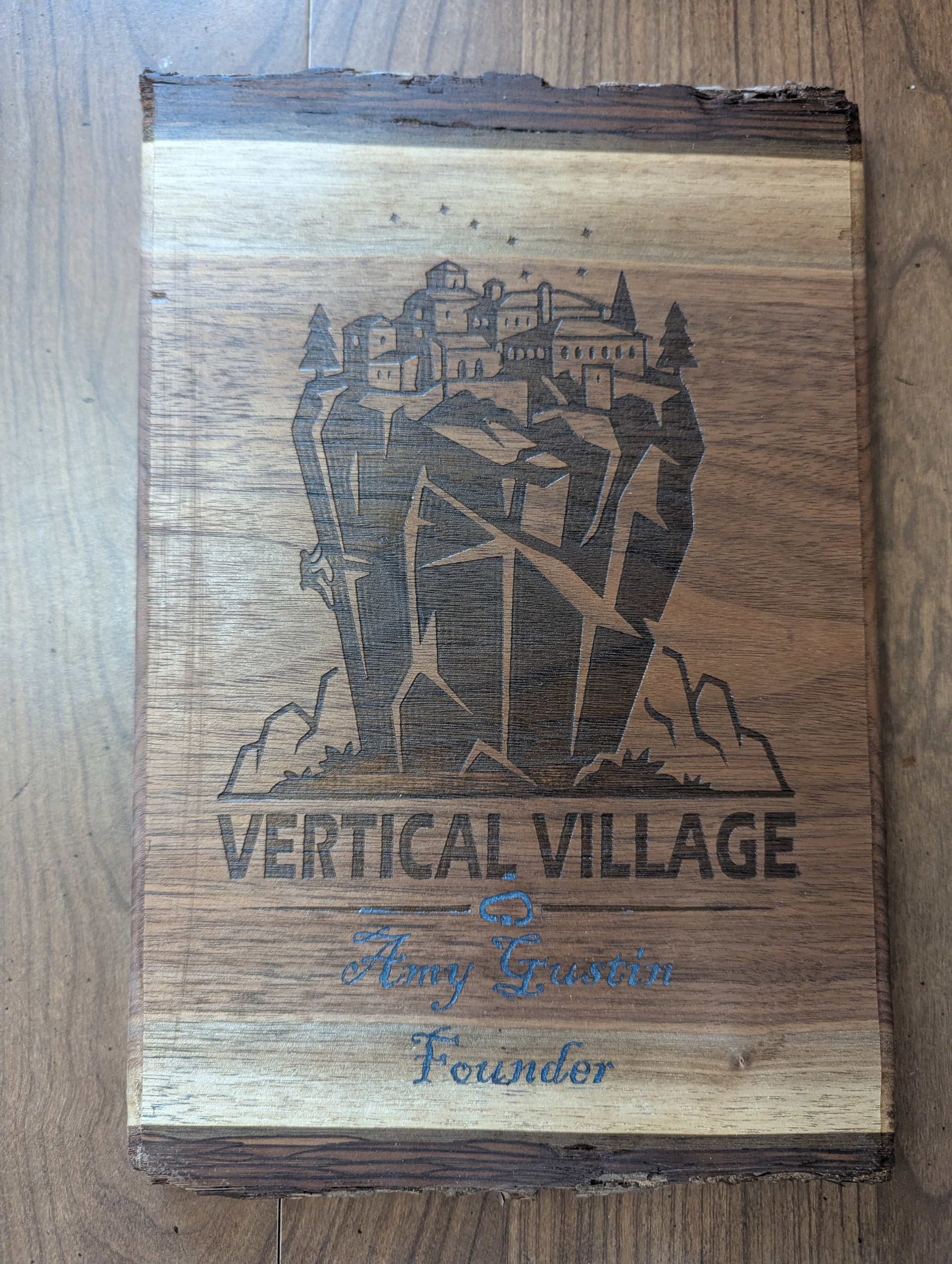

Had a three day delay making plaques for my co-investors in the first roped climbing gym in my town. Aside from the parallegramness (or maybe it’s just the non-parallel grain?), they turned out well. (Ignore the vertical scratch, this one is getting a better finish)
that has meant less progress on the eggbot.

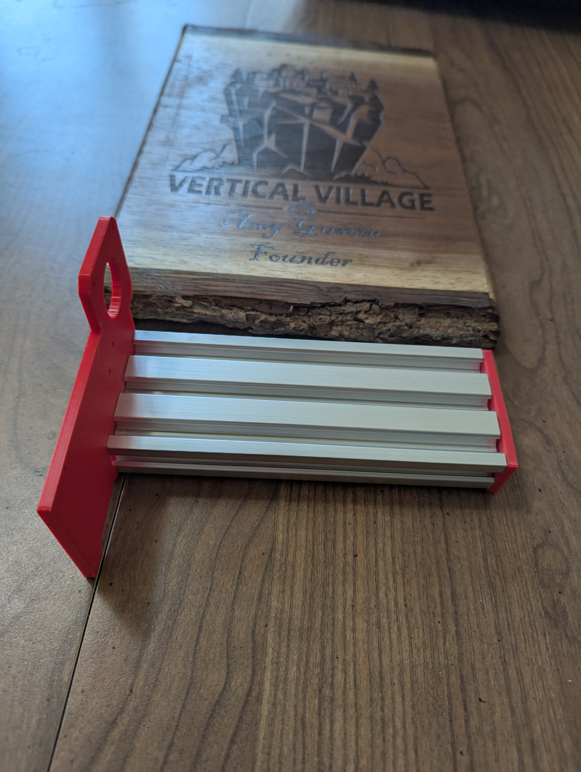

Got the end plates on. I forced the m5 bolts to make threads on one side since I didn’t think to get a tap which was a pain and frustrating. The other side I ran a 11/64th bit through the end first and that made the bolt tapping quite a bit easier, though still not painless; the bolts are a bit off perpendicular. A theme with most of my work I guess.

quick fit complete. Need to slightly file some of the holes that fit on the stepper shafts to get them to fit. And snip some wires. Fun tomorrow jobs.

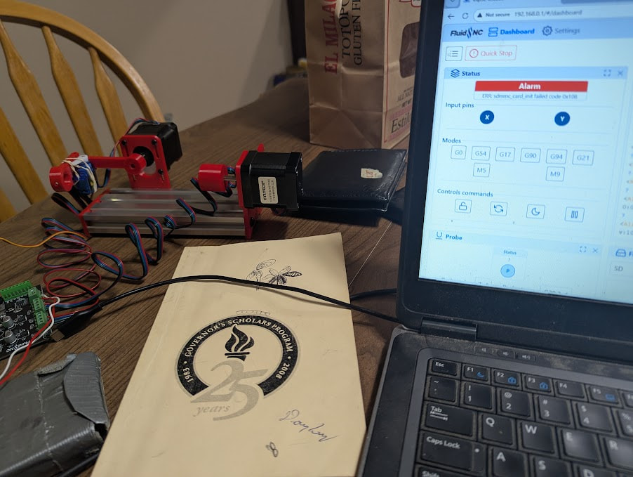

Pretty much everything is together but need to debug a few things. Probably need to chuck an SD card in there to resolve an error so need to go buy one of them. Super easy to get fluidnc onto the the board and connect to it which was suprisingly nice. Every time I try to connect to an industrial PLC, there’s usually about 2 hours worth of downdating software, updating firmware, changing computer network settings, then changing PLC network settings, then finally updating code. I like the change of pace.

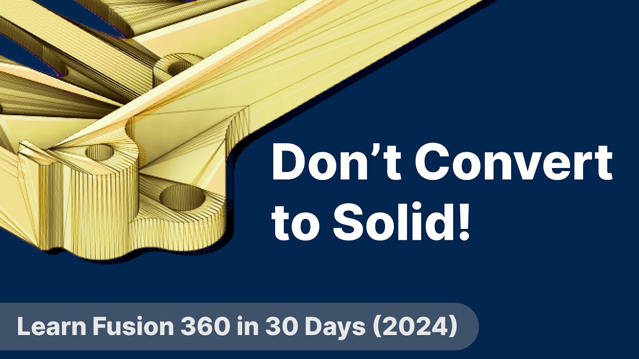

Took a little sidetrack in trying to edit the Y stepper holder arm and learned how to use some of the mesh tools in fusion 360. Often I want to make a hole a little bigger or add some text so being able to edit the mesh without having to convert to a solid first will be handy in the future. I missed that all of the edited parts were already in FluidNC Eggbot - #56 by jeyeager which worked out perfect.
Hopefully tomorrow I can get an SD card and get everything moving.
What fortune! Realized I had one on top of my desktop which I rarely use. Plugged it in, X and Y are moving. My servo was making a ton of noise during start up so swapped the plug around. Now it doesn’t move using the fluidNC z movement commands or spindle control so need to figure that out.
This worked for me on a Jackpot V2.
