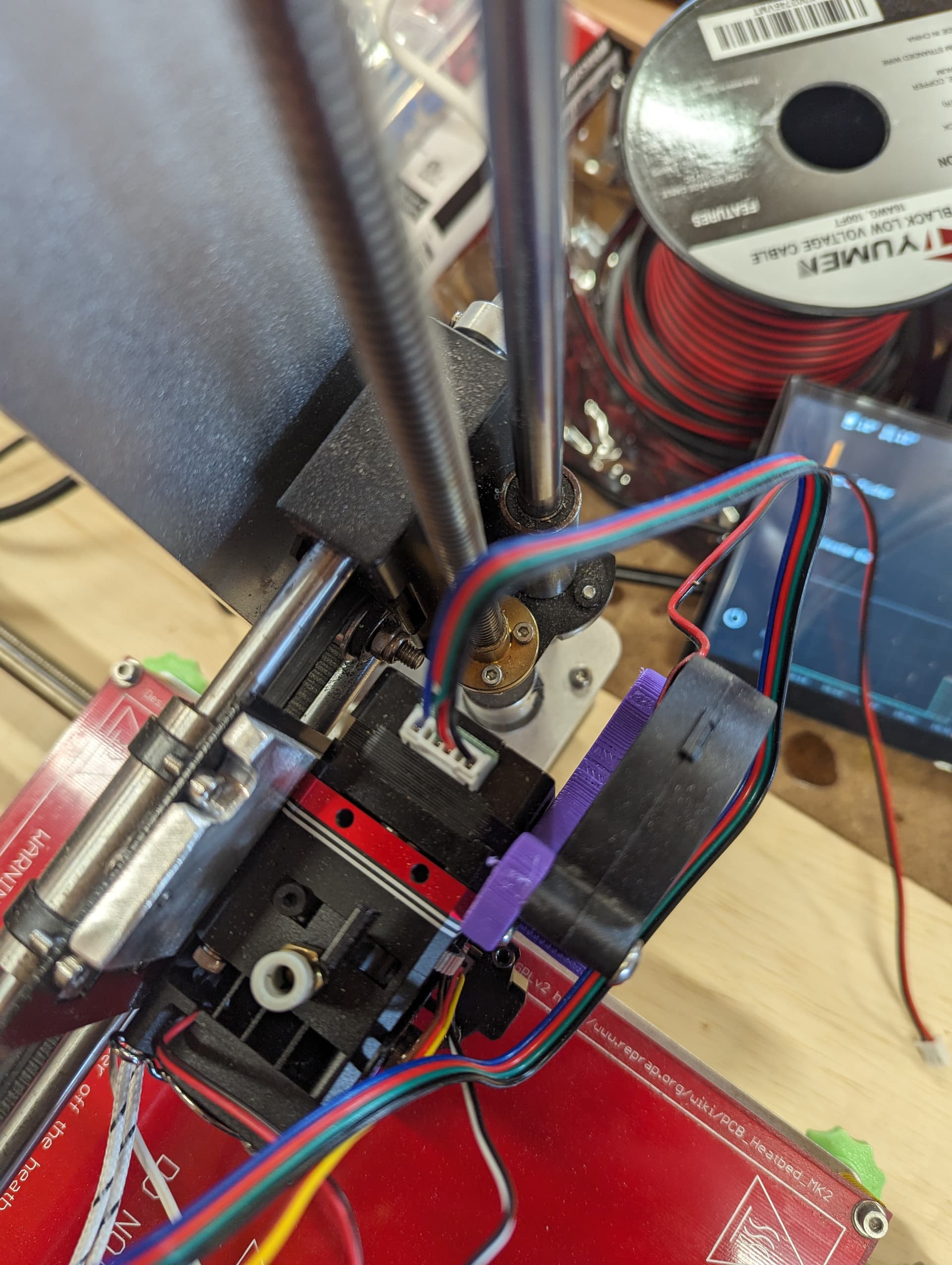

I forgot how small this printer is. And the new extruder is closer to the gantry, so there’s clearance issues.
With the new nozzle offset, it looks like I’ll have about a 90x90mm build plate.

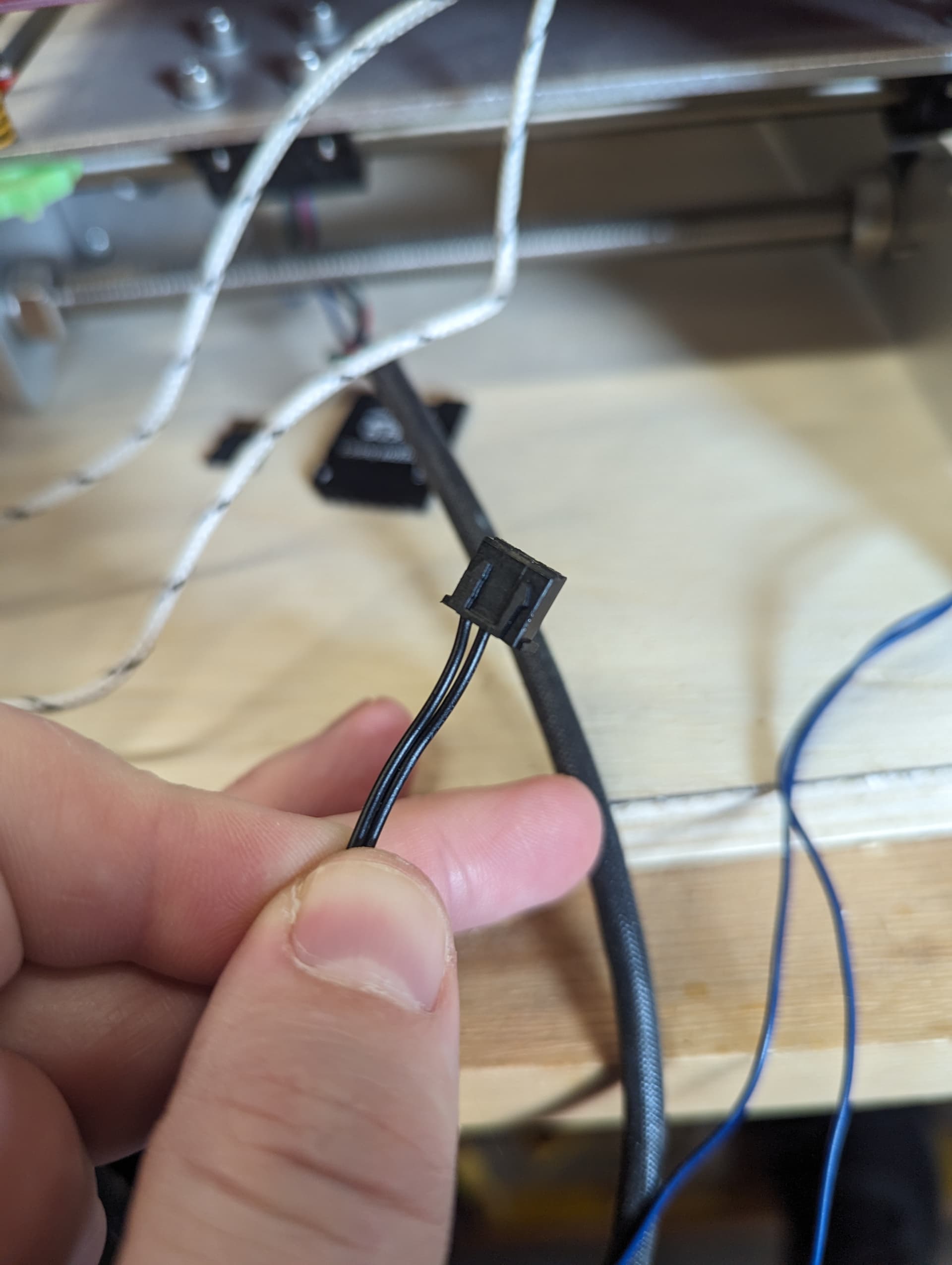

Let’s not forget that I also need to put new connectors on EVERYTHING. I’m just shoving the dupont connectors into all the spots, but I want to put the actual clip-in connectors on everything. I’m sure that will take a few minutes.
Oh. And I just remembered I wanted to setup a git repo for storing my configs…
LOL I just pull the plastic like we did on the SKRs and keep the duponts I’ve never one had one come off doing it that way
This older printer is a bed slinger. It’s been known to rattle connectors loose. The last controller I used I had a box printed that had strain relief to hold the wires in place.
I prefer the jsh-xt connectors to the dupont because they lock, but until recently my crimping skills were very much lacking, but now only slightly lacking, but improving. My v4 has the xt connectors which I prefer now. The mpcnc has rj45’s at the controller exit to dupont to the motors. With my z brake motor testing, I’ve spent a lot of time crimping connectors and gotten much better.

Don’t forget kids… The spring pressure can be adjusted on your crimpers so you stop chopping the connectors off

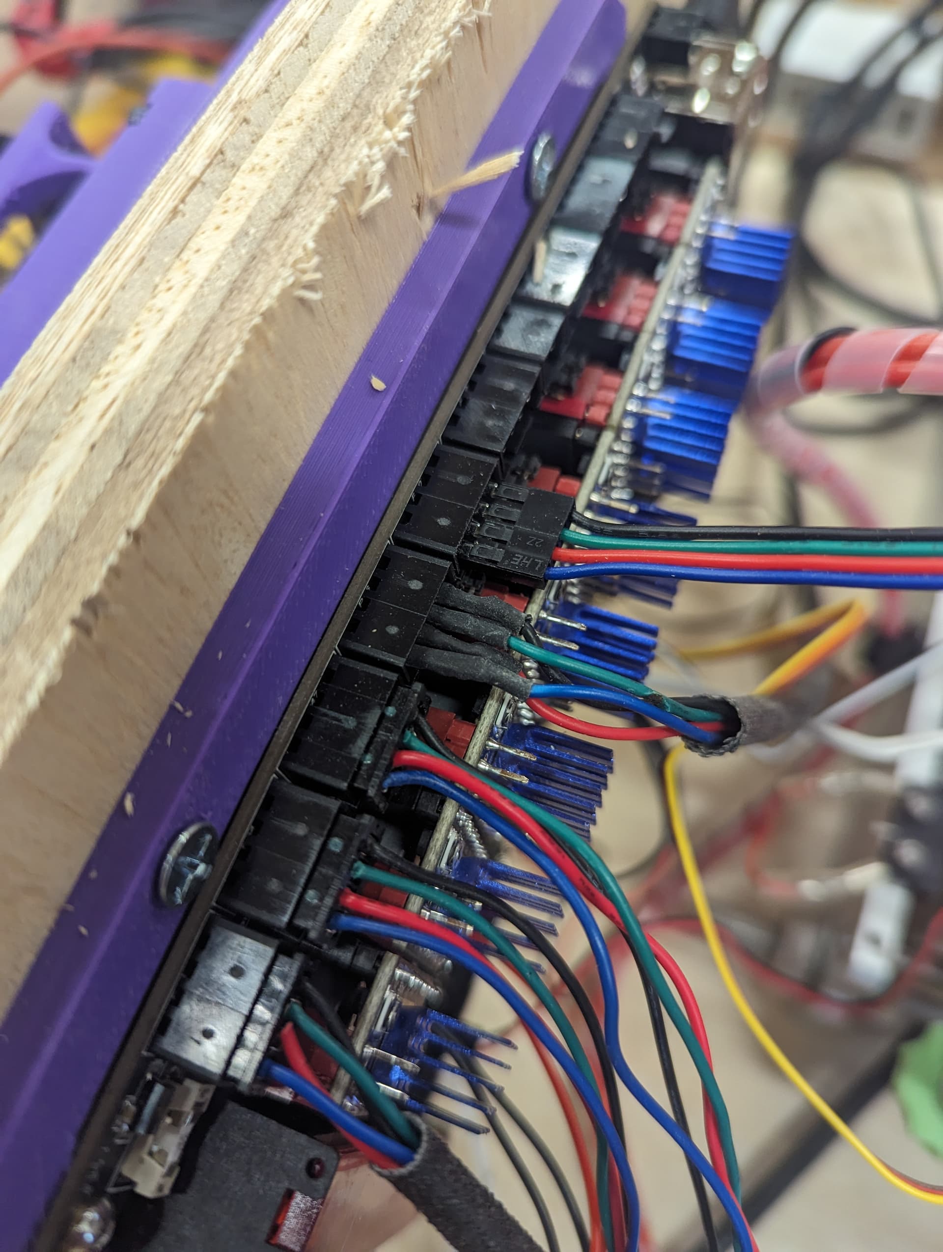

In case you were wondering how janky my connections have been in the past…
Check out this beaut.
Individually shrink wrapped pins.
I see nothing wrong here. It’s not stupid if it works lol
