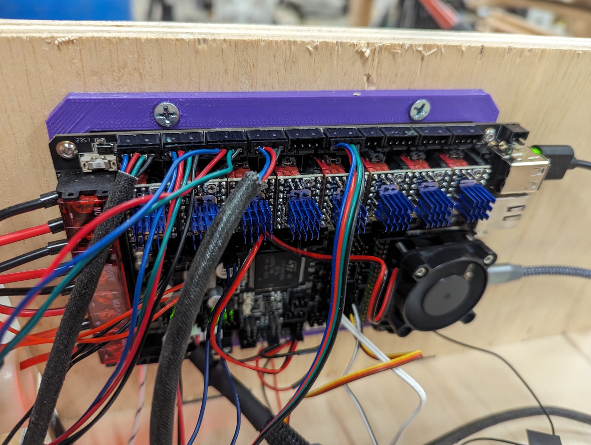

One last thing to debug… and this one is really stumping me.
For some reason, my extruder is turning with the z axis. If I tell it to extrude or retract, the stepper doesn’t move. If I tell the Z axis to go up or down, the extruder gear turns too.
This is really baffling me as I can’t see ‘why’ it would be doing this.

I am not seeing anything. Any solder bridges or anything on the bottom? Are all your jumpers in the right place?
As well I don’t see anything in your config that would cause that. Like Ryan said check the board for solder bridges and maybe check your wiring for rubs?
Wait you have the M8P right? Move the Extruder to a different socket and see if the issue follows
That’s my plan. Just haven’t gotten there yet.

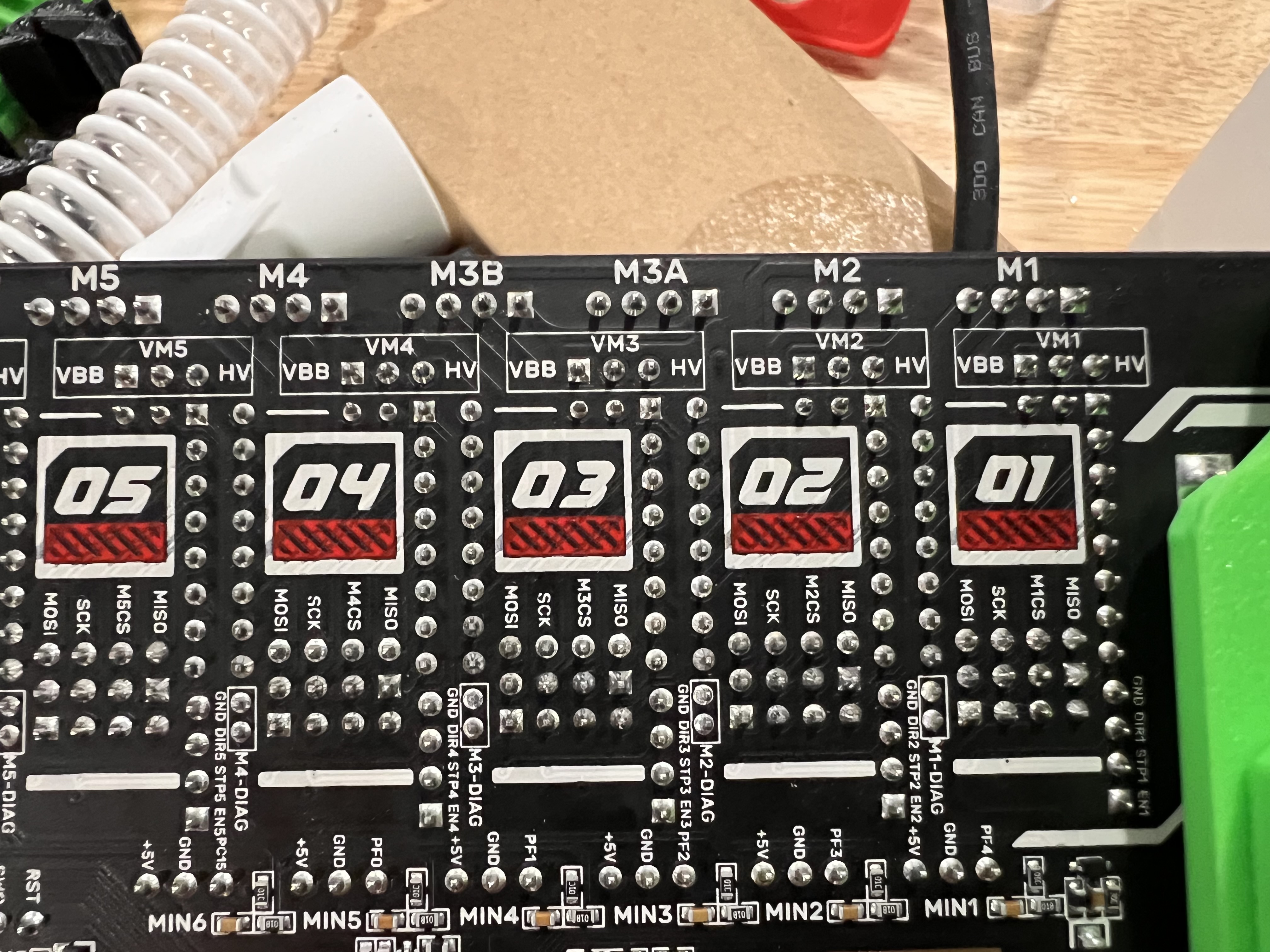

Are there 8 drivers and 9 plugs? Z has option to run 2 steppers?
Yes. Just looked at my board sitting here and slot 3 has A and B plug. The way his Config is he should be skipping B
I think ya’ll are right. I do see 9 motor plugs on the board. I don’t see where that’s marked anywhere on the top of the board :frowning:
Its not unfortunately. Its on the bottom
That’s really hard to see when it’s bolted to a board…
Either way. I ran out and moved the extruder over one and everything worked.
I should be able to melt plastic tomorrow.
Oh. That also means I’m currently driving both z steppers on the same driver. I guess I should move the second z stepper over one too so they’re driven off of separate drivers.
Yeah the way your config is set up it “thinks” it has each on different drivers, but plugged in the way it is you just have a driver trying but doing nothing LOL. Just make sure your on the right one with your pins.
I get that completely, that’s why I uploaded a pic so you would know exactly which one it was

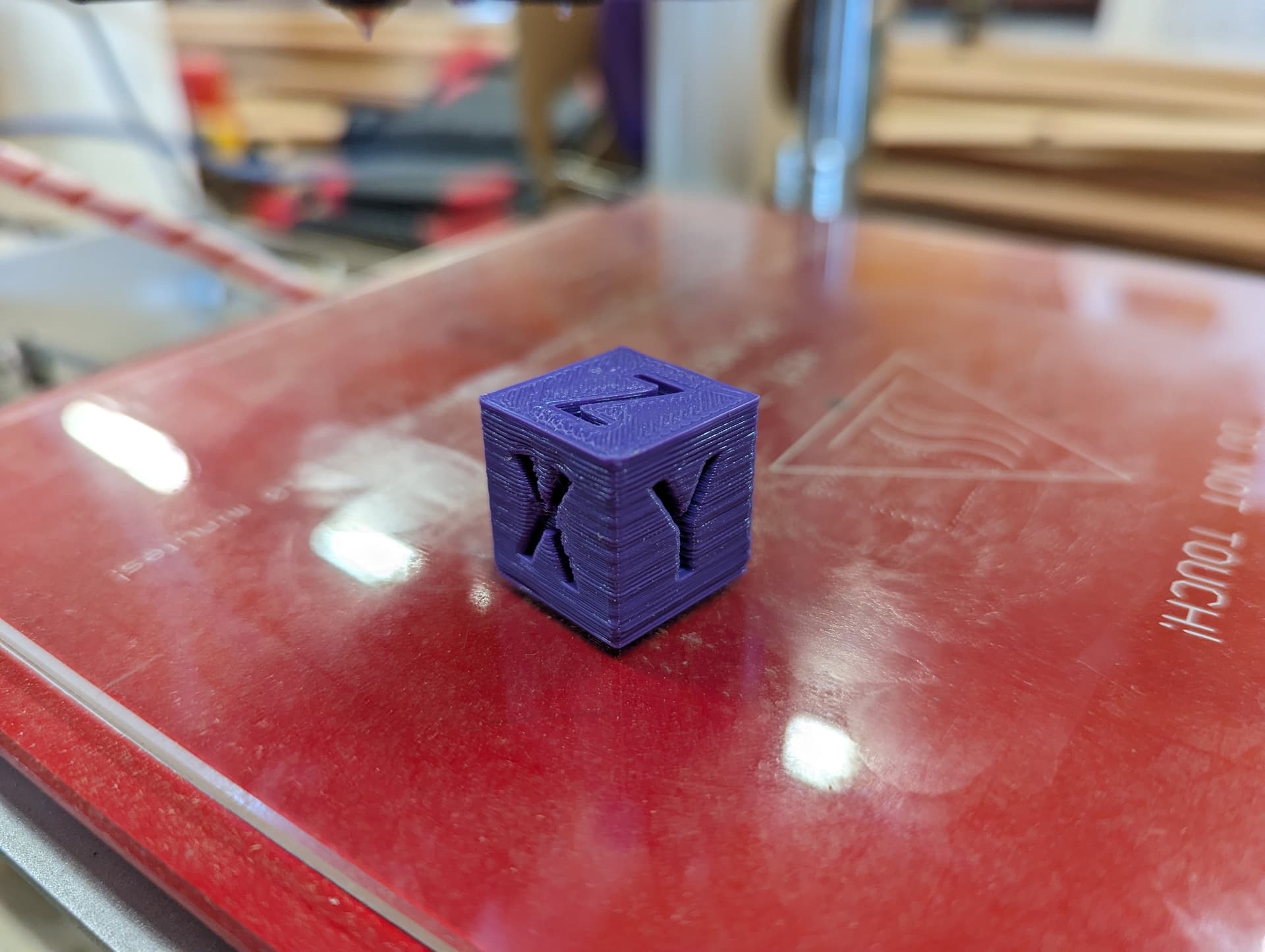

She prints again!
Now you are going to be dipping your toes in to the wonderful world of klipper tuning!
